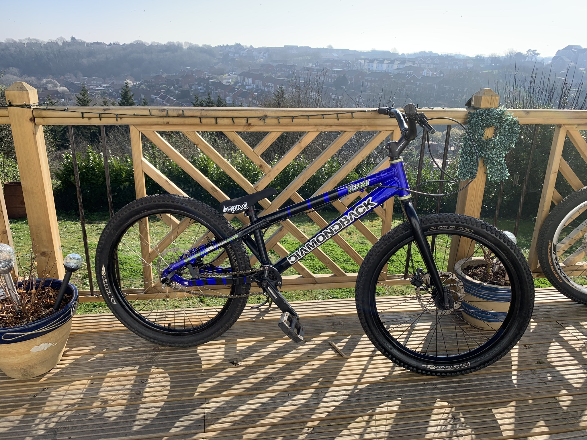

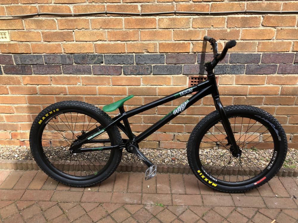

Private Repress Posted May 30, 2019 Report Share Posted May 30, 2019 (edited) Having built up my Ashton ET, I thought I’d look for something with a bit more trials geometry... and a rear disc mount. Still steering clear of Inspired at the moment. Ended up buying this from this very forum as a starting point: The 4 bolt mounts on the forks had been hacked back - I intend to finish this off nice and smooth, the rear chainstay/wishbone support on the frame had been cut off to allow for the rear disc calliper to fit - and these frames don’t fit particularly large callipers anyway. I continued to look for something else to help with the Frankenstein build and found an Onza Zoot - a mate of mine recently bought one and I really like the way it rides so I went and met the guy selling this one - top lad and it had been well looked after: Edited May 31, 2019 by Private Repress NA 2 Quote Link to comment Share on other sites More sharing options...

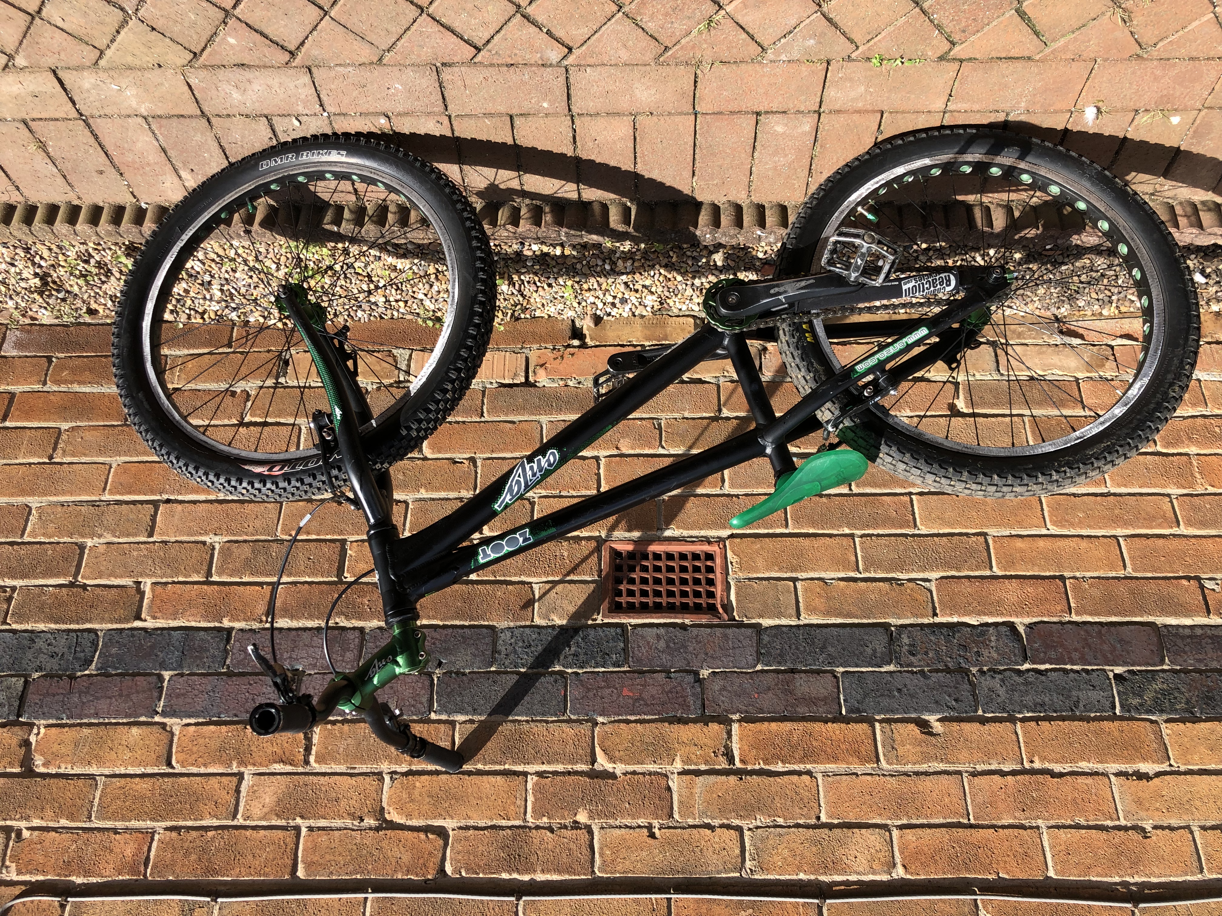

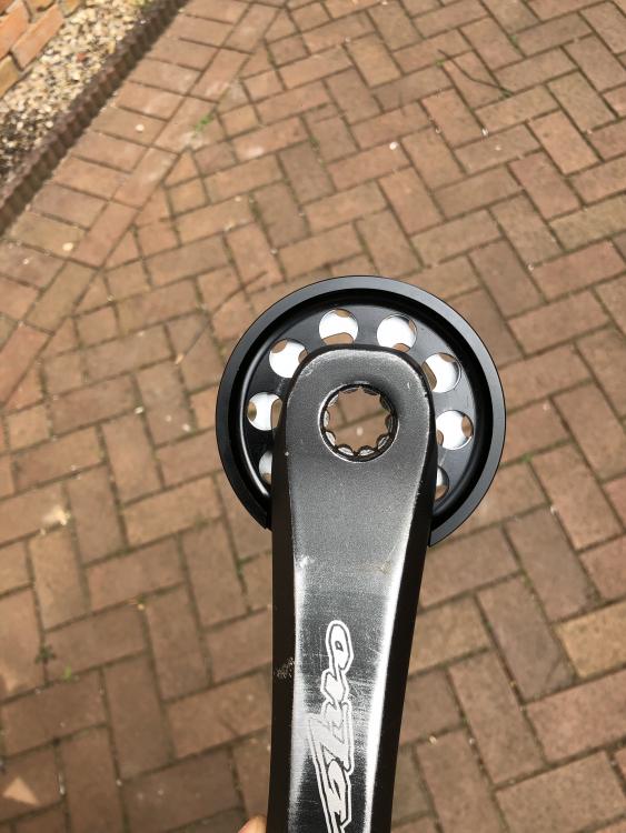

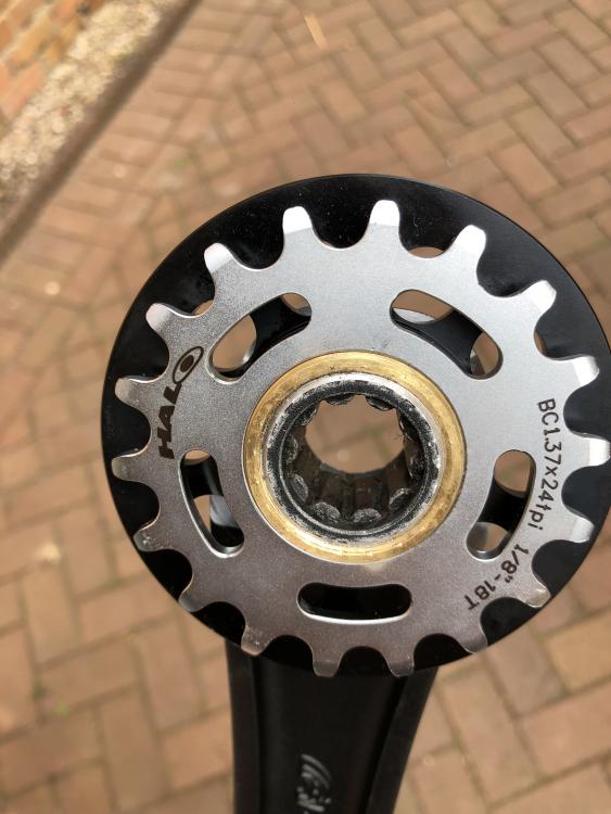

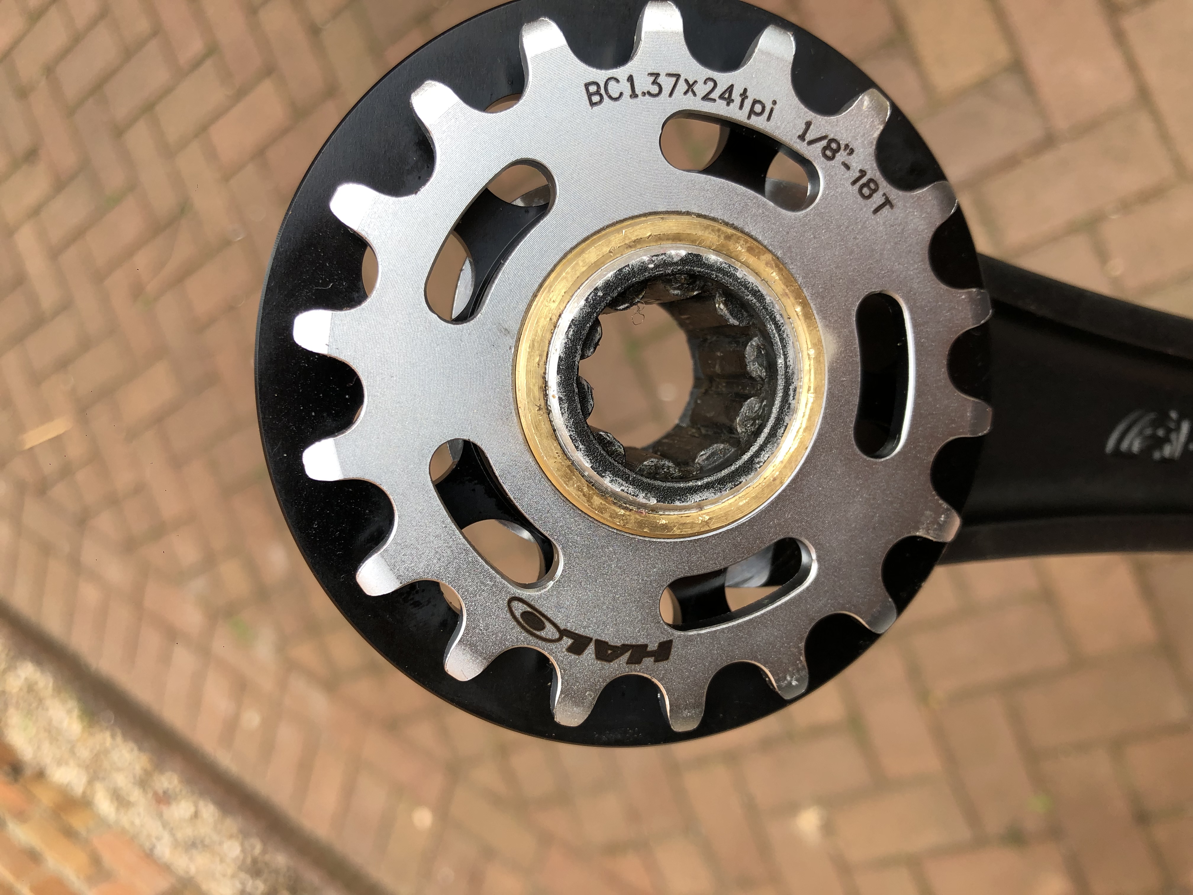

Private Repress Posted May 30, 2019 Author Report Share Posted May 30, 2019 I’m not a huge fan of front Freewheel’s, so opted for a screw on fixed sprocket and a new bash from Tarty, looks a bit cleaner Quote Link to comment Share on other sites More sharing options...

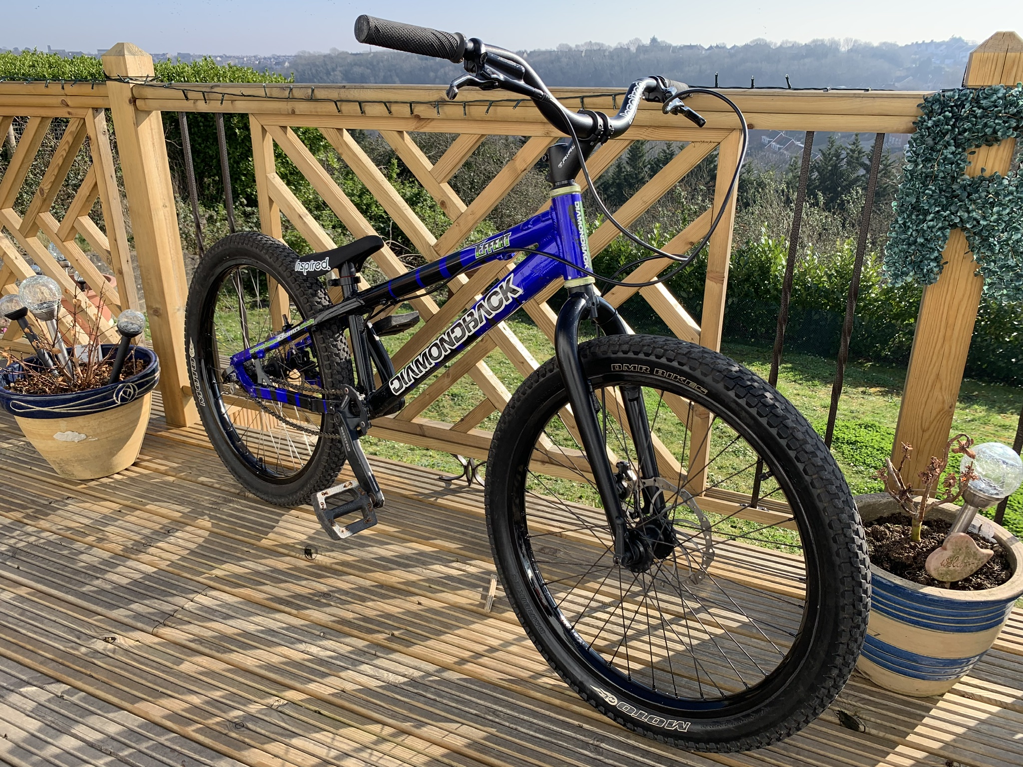

Private Repress Posted May 30, 2019 Author Report Share Posted May 30, 2019 Next up the bar and stem... took those off the diamond back along with the Ashton forks... oh and a lovely wheel set from @Ben Davies DMR DeeVee rims on black hope pro 2 hubs. Also later converted the rear hub to 14mm bolt in - works a treat! already starting to feel more my kind of bike! Quote Link to comment Share on other sites More sharing options...

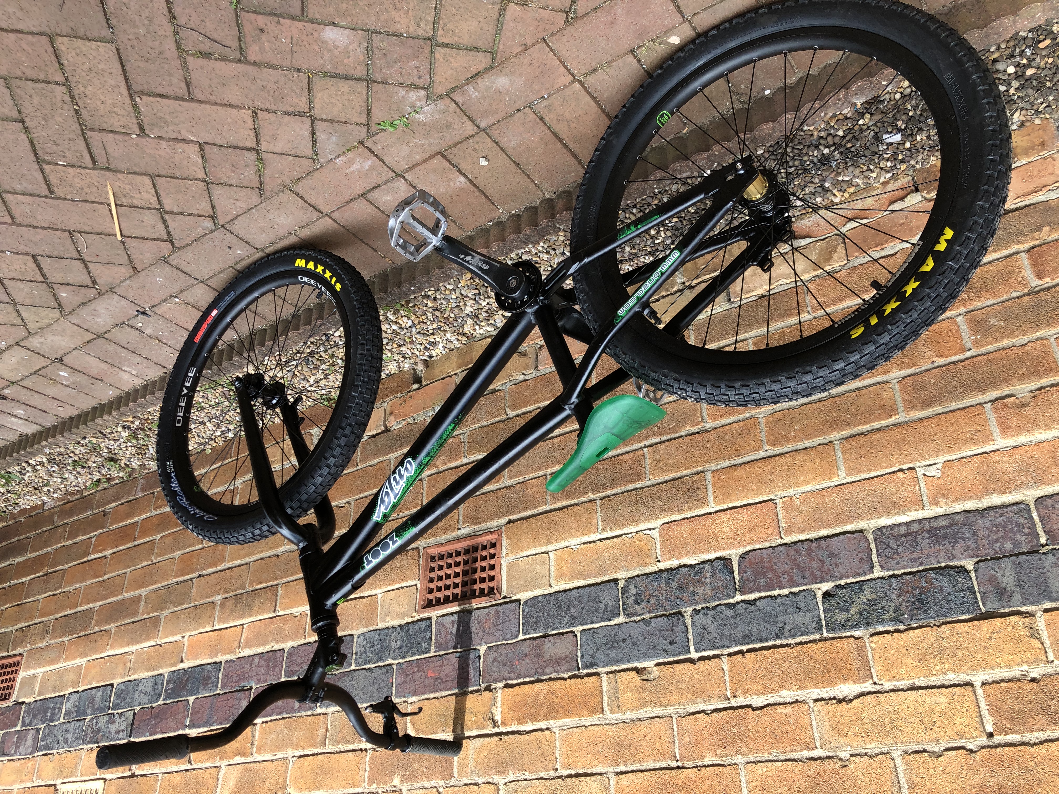

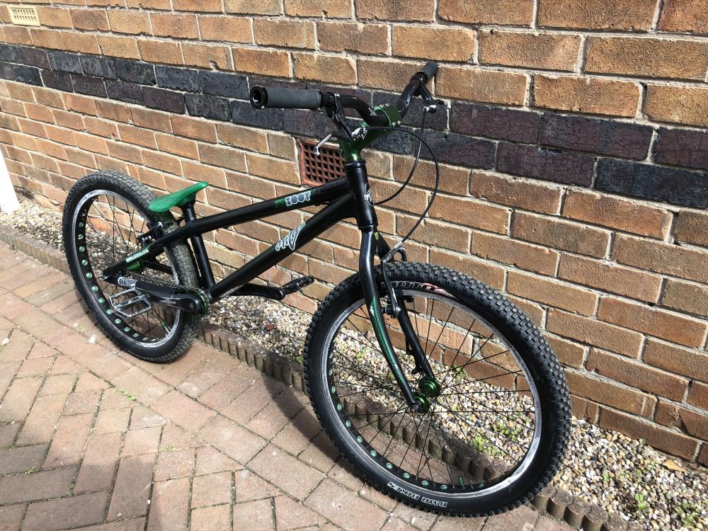

Private Repress Posted May 31, 2019 Author Report Share Posted May 31, 2019 Next up I added a spank single speed 13t sprocket on the rear, the beefiest chain I could find and some MT5’s with trial tech pads in the rear. initially I ran the front brake through the head tube, took it out for a spin and realised I had a problem with the original open bearing headset. So swapped it for the hope one off the diamondback. Pain in the backside as it meant I had to re-bleed the front brake! Ah well! also changed the plastic seat which was very uncomfortable to an old DMR padded pivotal - it’s torn but I like the look haha. I did buy the brakes with 203mm rotors, but they will be going on my enduro rig from which I’ve pinched the 180mm rotors I might go down the route of getting it all sprayed, but for now I want to ride it! Quote Link to comment Share on other sites More sharing options...
Ross McArthur Posted May 31, 2019 Report Share Posted May 31, 2019 Was it JD who sprayed up a Zoot in the same grey you sprayed your E.T? Is there anyway of cutting the seat tube down to take off the pivotal mount, so you can run a seat post to drop the saddle height down a bit? Might as well if you are going to go through the trouble of spraying it? Also, can you remove the V bosses? Also, is that a Santa Cruz logo I can see on that hub? 1 Quote Link to comment Share on other sites More sharing options...
Private Repress Posted May 31, 2019 Author Report Share Posted May 31, 2019 51 minutes ago, Ross McArthur said: Was it JD who sprayed up a Zoot in the same grey you sprayed your E.T? Is there anyway of cutting the seat tube down to take off the pivotal mount, so you can run a seat post to drop the saddle height down a bit? Might as well if you are going to go through the trouble of spraying it? Also, can you remove the V bosses? Also, is that a Santa Cruz logo I can see on that hub? I’ve seen that grey zoot - looked ace! A lot lighter in colour than mine though! Yes I’ll be chopping the seat post out and putting the inspired one on from the diamondback when I’ve ridden it a few times. Also need to make sure the seat clears the tyre. Yes I’ll remove the pins from the mounts for vee’s but keeping the mount on there incase the disc mount cracks. And yes well spotted mate - Santa Cruz black pro 2 hubs was thinking all black for this if sprayed - here’s another I saw in black and I love it: 2 Quote Link to comment Share on other sites More sharing options...
