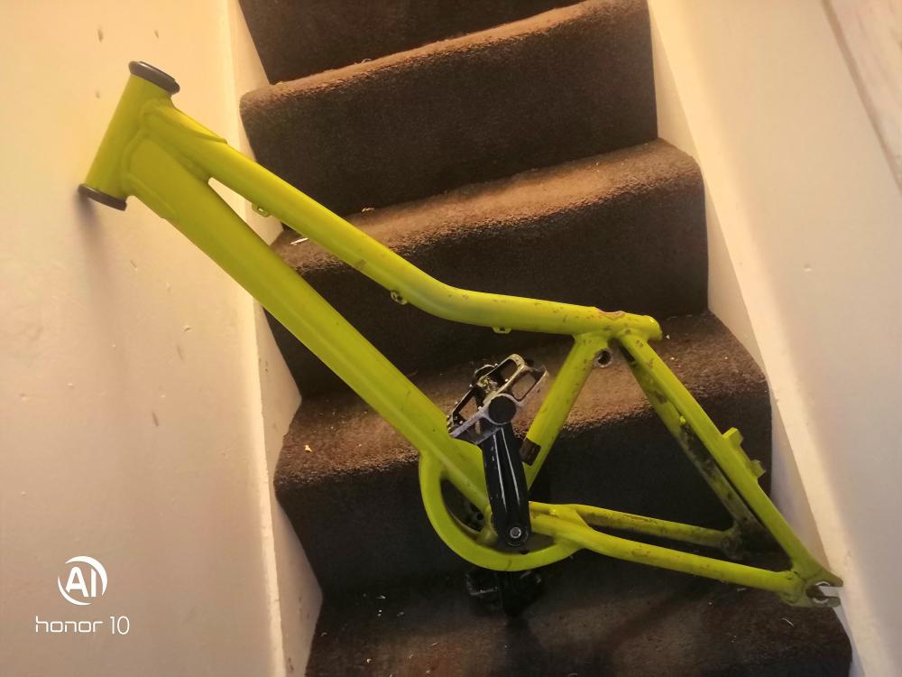

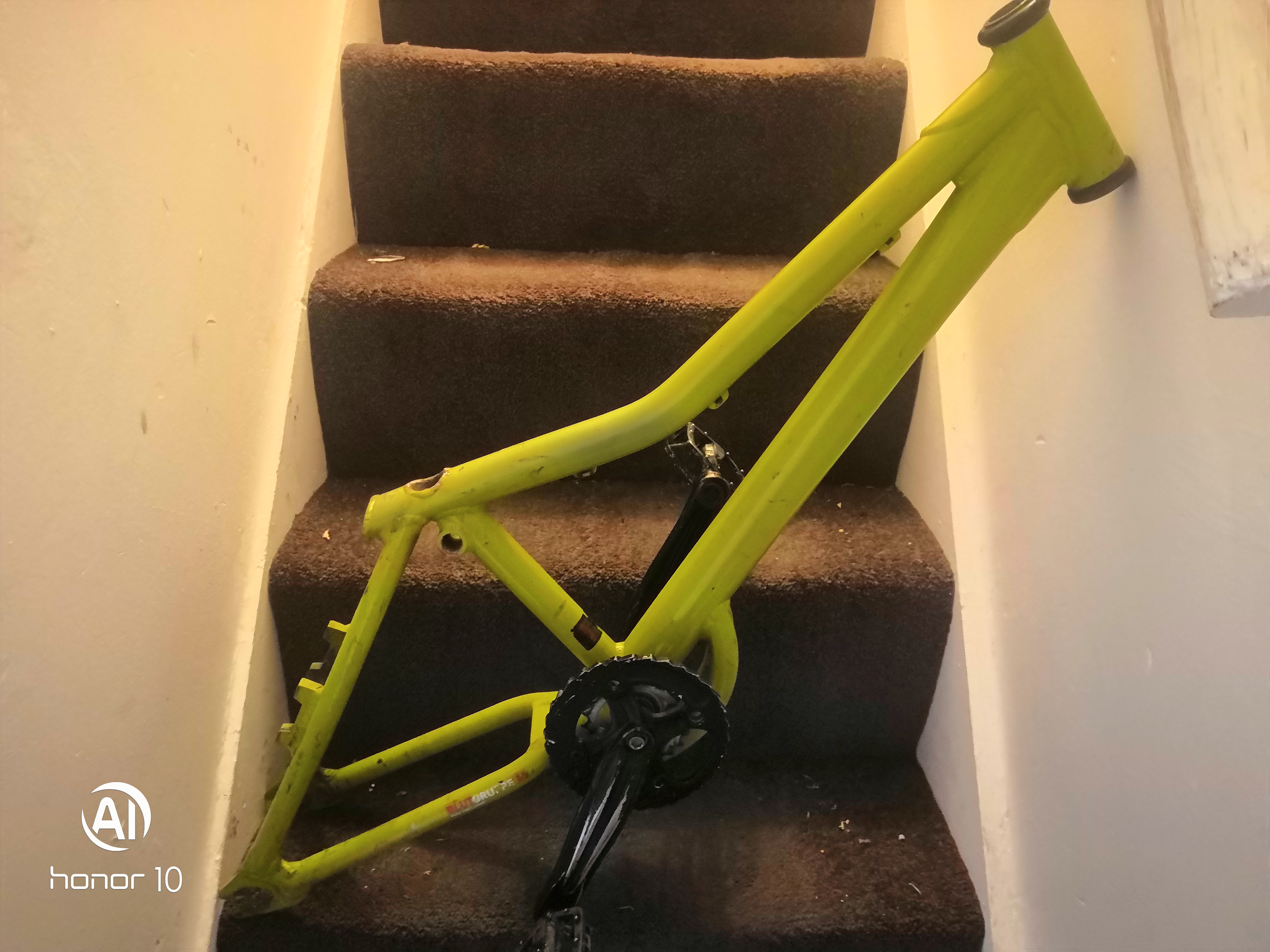

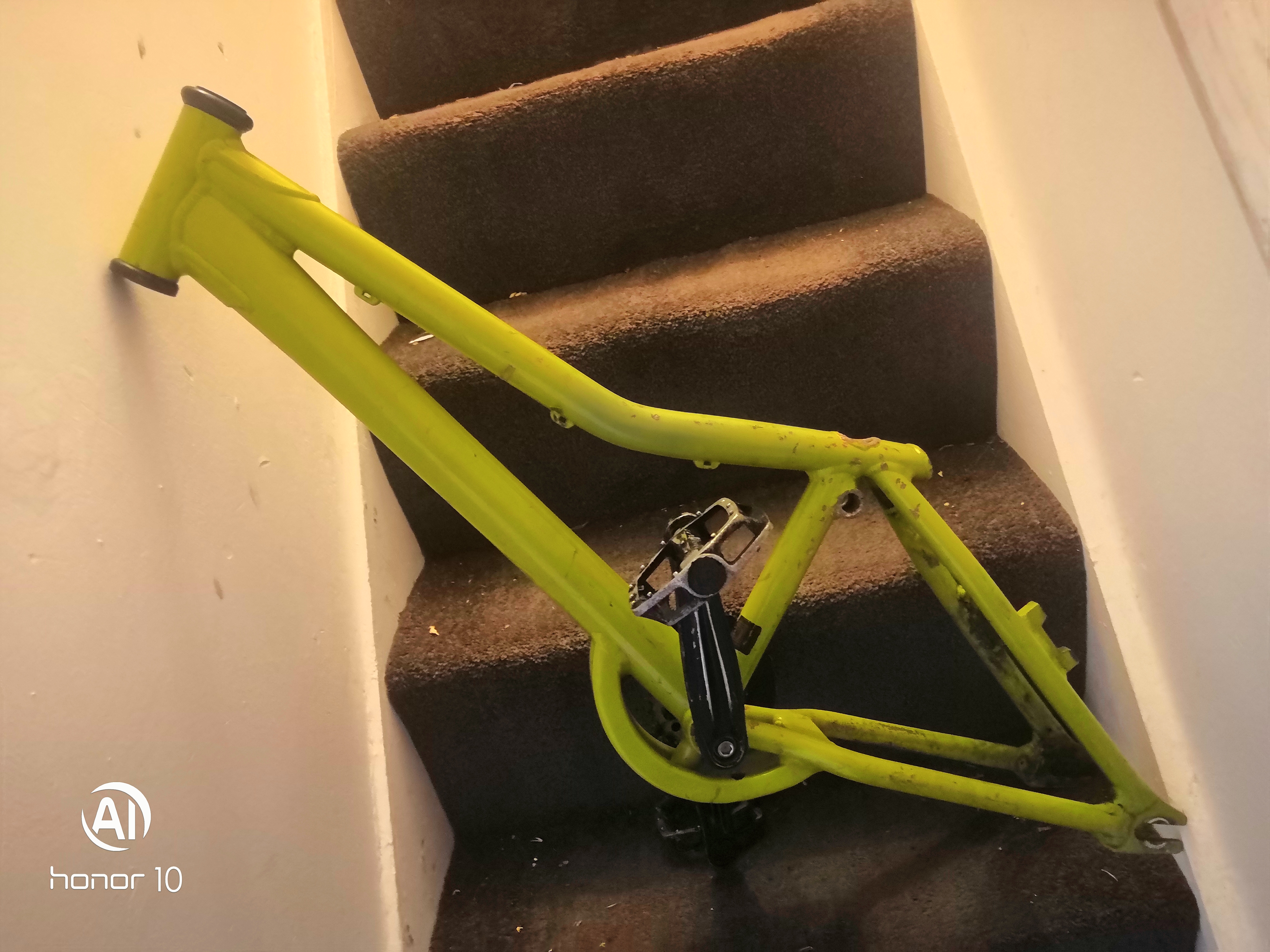

Gavin cross Posted April 26, 2019 Report Share Posted April 26, 2019 I have this very old trials frame... (looks like a comp style frame to me??) and I Just wondered if anyone knows what frame it is? I did trials as youngster on a monty and I gave up around 15 years ago. I've recently got back into cycling and want to use trials as a way of advancing my skills like pedal and break control. So im thinking of building it back up just for that really. But would love to know what make it is. Thanks in advance Quote Link to comment Share on other sites More sharing options...
Tony Croft Posted April 26, 2019 Report Share Posted April 26, 2019 Quote Link to comment Share on other sites More sharing options...
Gavin cross Posted April 26, 2019 Author Report Share Posted April 26, 2019 Awesome that looks like the one. Now I need to find out if it's worth a bit of restoration or just rebuild and play? Don't know if it will be worth the time. Quote Link to comment Share on other sites More sharing options...
J.KYDD Posted April 27, 2019 Report Share Posted April 27, 2019 Re-build and play. Restore it if you want, but it wont be worth any more as a result Quote Link to comment Share on other sites More sharing options...
ogre Posted April 27, 2019 Report Share Posted April 27, 2019 if memory serves they take a 14mm axle hub on the back wheel which limits your choice of hubs to very beefy bmx ones. make sure you get a threaded hub so you can put a good trials freewheel on there. if the frame the only part you have? you might be better off getting a complete new bike. Quote Link to comment Share on other sites More sharing options...
ogre Posted April 27, 2019 Report Share Posted April 27, 2019 i don't think it's a mission looking at the headset actually... i think they ran with a 1.5" headset not the standard 1 1/8 which that looks like. either way if it's a mission prodigy frame then you either need to get a headset that takes the smaller steerer or get your hands on the original mission forks will fit that bike. Quote Link to comment Share on other sites More sharing options...
ogre Posted April 27, 2019 Report Share Posted April 27, 2019 if it's not a mission then it could be a base or an onza, measure the dropouts and the headset to find out Quote Link to comment Share on other sites More sharing options...
Mark W Posted April 29, 2019 Report Share Posted April 29, 2019 Onza T-Pro was the first thing I thought of as I thought the Mission head tubes looked way chunkier because of the difference in steerer size. Quote Link to comment Share on other sites More sharing options...
AdamAllen Posted April 29, 2019 Report Share Posted April 29, 2019 Da Bomb Pro Quote Link to comment Share on other sites More sharing options...
Gavin cross Posted April 29, 2019 Author Report Share Posted April 29, 2019 It's got a 1-1/8" steerer if that helps at all? Quote Link to comment Share on other sites More sharing options...
Mark W Posted April 29, 2019 Report Share Posted April 29, 2019 It'll probably be an Onza or Da-Bomb in that case then - it doesn't matter toooo much which one it is as they're all essentially the same frame from the same place as far as I know. As far as compatibility goes: - Headset: it'll need a standard 1 1/8" headset (not internal or integrated), - Dropouts: 110mm spaced (which you'll need to use with chain tugs to tension your chain), but you can use a 116mm hub if you dick around with spacers (depending on the specific hub) - Rear wheel: You'll need a 19" rim and tyre - Brakes: You can either use a hydraulic rim brake with some 4-bolt brake clamps or get some 4-bolt to V-Brake adaptors and use a V-Brake if you'd prefer - Gearing: If you're going to run that crankset, if it's a 24t chainring you'll need to use a 16t freewheel on the rear to get the right gear ratio They're not bad frames, but if it's going to cost you a lot to do it up and get it rideable then it may be worth looking at getting a second hand complete bike. Trials bikes don't hold their value well so you can pick up some bargains here and there. If it's looking like it'll cost you £300-400 to get it working, going for a second hand complete would be a better bet as you'll be able to get a more modern bike with more up to date geometry for the same price. Quote Link to comment Share on other sites More sharing options...

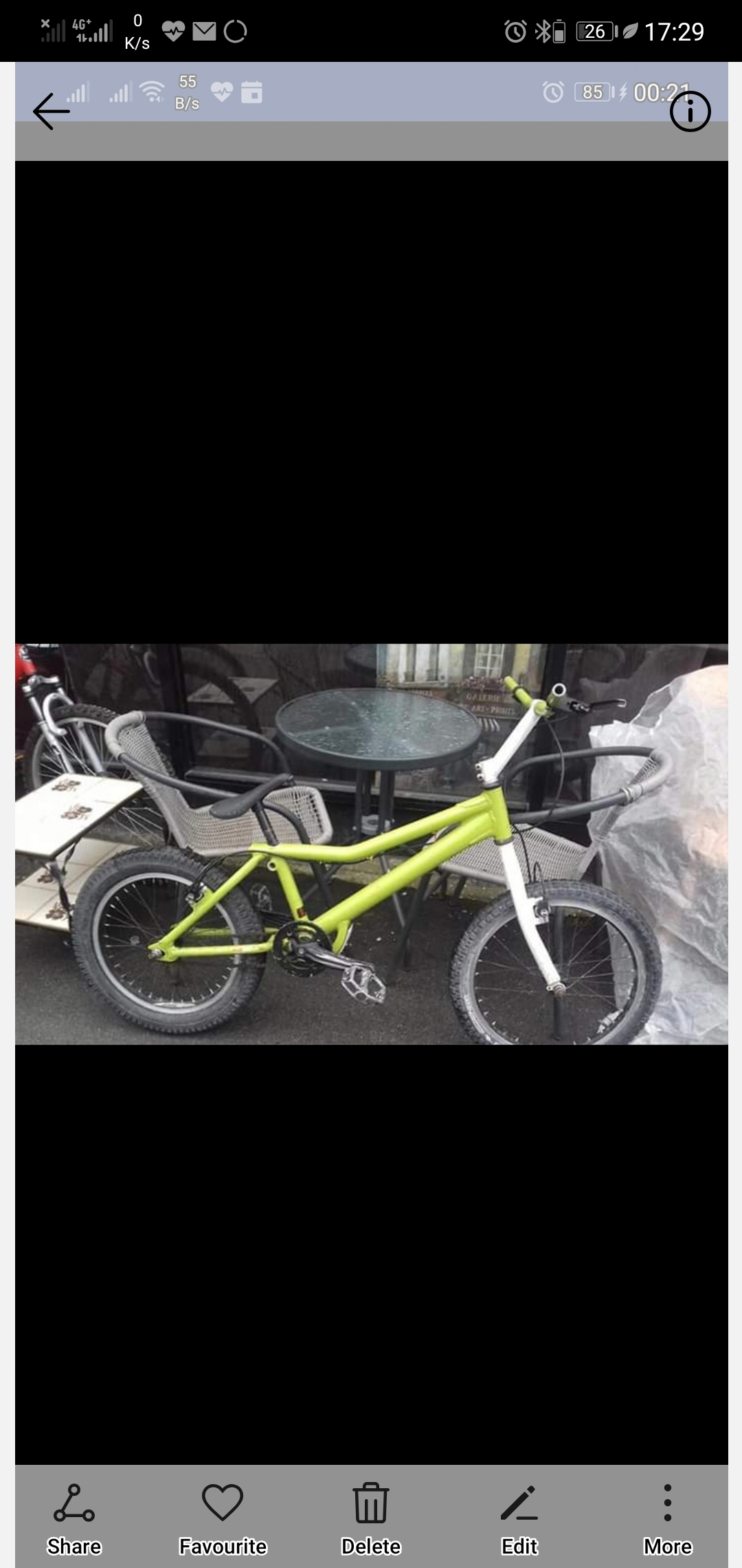

Gavin cross Posted April 29, 2019 Author Report Share Posted April 29, 2019 This is it built up,. Quote Link to comment Share on other sites More sharing options...
Rossy Posted July 11, 2019 Report Share Posted July 11, 2019 Isn't this a prototype inspired? Quote Link to comment Share on other sites More sharing options...
