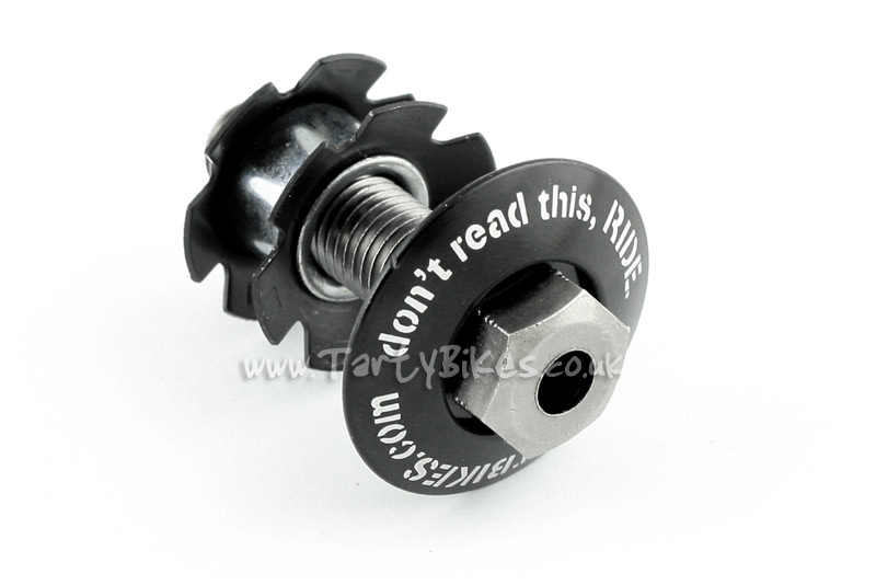

Mark W Posted November 20, 2018 Report Share Posted November 20, 2018 A little bit longer shouldn't really affect the performance too much - they'll still be way shorter than you'd find on a full-size bike, and people use V-Brakes on those with no problems. You can route a V-Brake cable through the steerer, but they are a bit fiddlier to do. The cable has to wrap around the fork leg and the noodle will go into the caliper upside down, so you may find you need to tweak the angle of the noodle/buy a noodle with a different angle. It's just a case of trial and error working out the right cable length for it to work basically. If you buy a long cable and just trim it down bit by bit until you get a nice smooth curve leading to the noodle you should be fine. You'll need to get hold of one of these and hammer the existing star nut out: 1 Quote Link to comment Share on other sites More sharing options...
old boy chez Posted November 21, 2018 Report Share Posted November 21, 2018 bmx linear brake cable is what you are after along with the star nut mark said . Linear cable you can wrap around its twice and will feel the same as normal. 1 Quote Link to comment Share on other sites More sharing options...
