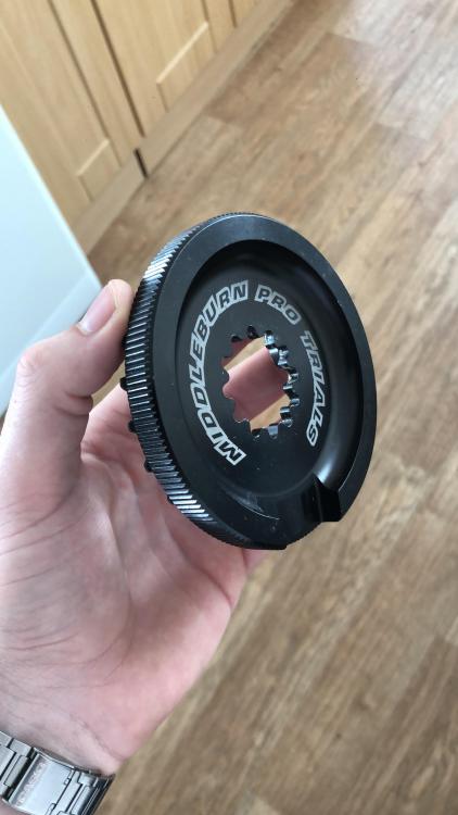

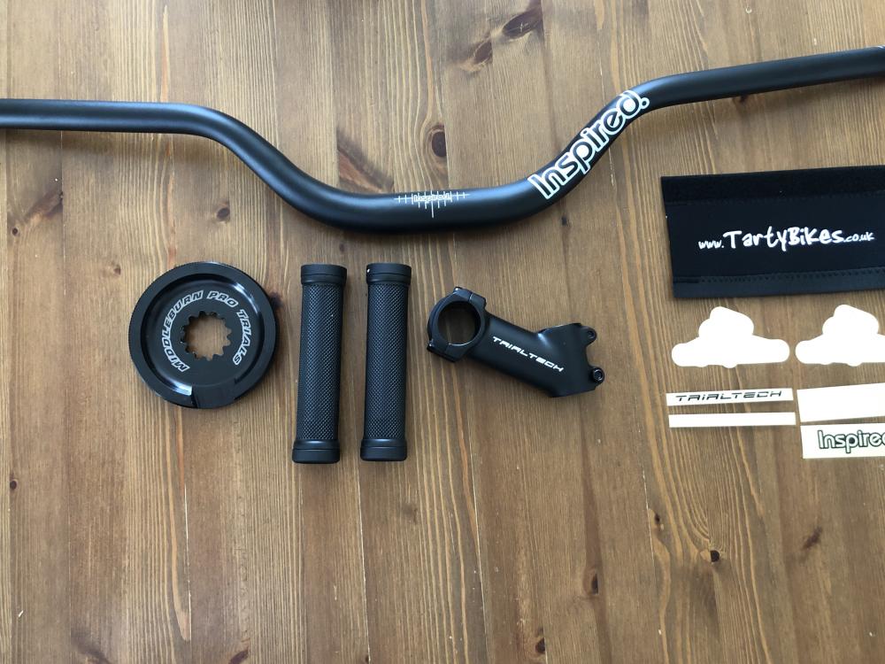

First thing was to change the bar and stem, and get some colour coordination, so with a bit of advice from @Ross McArthur on geometry I went for inspired riser bars and a 90mm 35 degrees trial tech stem, some new grips and managed to find a NOS black middleburn bash ring on eBay - happy days!
@Ross McArthur thanks for the advice, the bar and stem set up feels great!

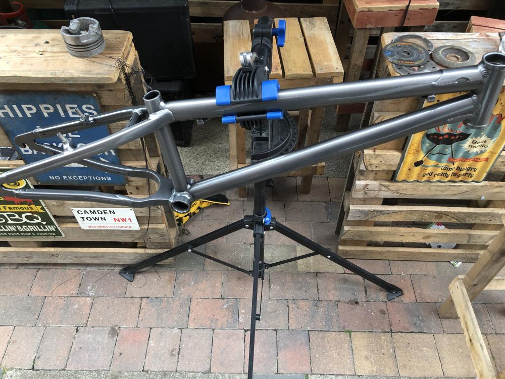

Decided on getting the forks done at the same time as the frame and settled on grey for the colour. Shot blasted and powder coated for £30 (frame and fork) seemed a bargain to me! I’m collecting them this afternoon so fingers crossed the finish is good!

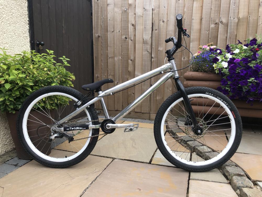

I had a bit of time on Monday evening spare, so up next was the wheels...

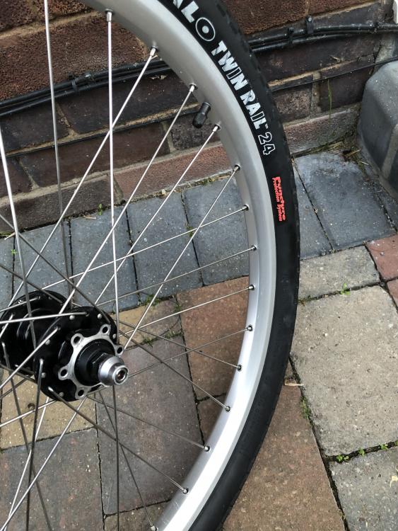

I kind of like the white rims but they were tatty - I didn’t want to eat into the budget changing them, but the paint finish was old and flakey so I decided to strip the paint instead:
I used Nemesis paint stripper from screwfix, it was £25 but I didn’t have to use much, there are some good alternatives out there too, Wicks’s own brand stuff is very good and is sold in smaller amounts.
https://www.screwfix.com/p/nemesis-paint-varnish-remover-2-5ltr/2698t
Wasn’t to sure how they would look, but I’m delighted with the results... makes them look like new!

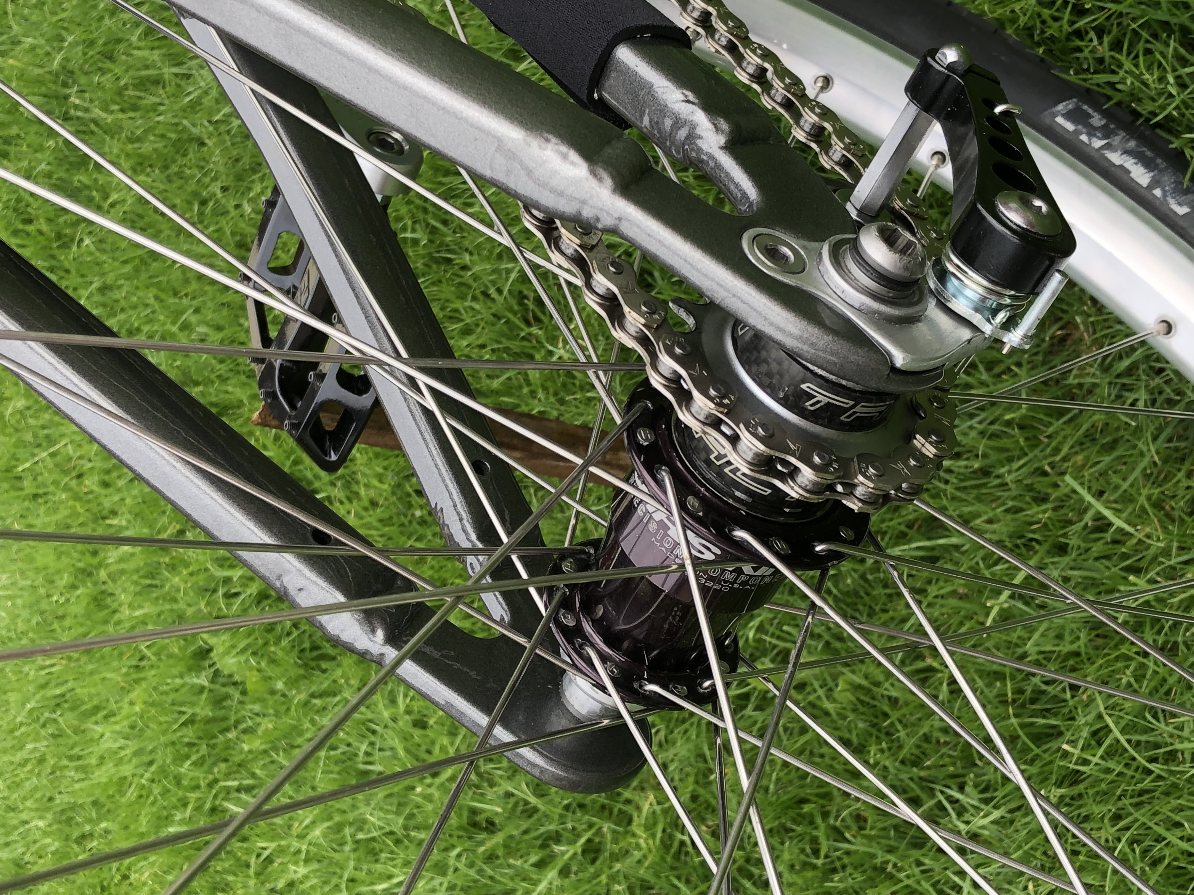

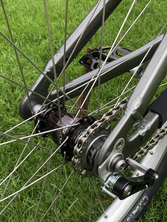

4-Jeri chain tensioner - can’t wait to tidy the clutter at the rear triangle and take that horrendous rear mech off. The bike should look a lot cleaner. Planning to run the chain pretty short.

Hopefully you can get a good tension on that chain with the single wheel pully.

Im not 100% on that model tensioning up but if it can and you can get the tension right it would be a good move. It'll be something along the lines of taking the spring out and flipping it round? I recently found a super cheap tensioner on ebay which does exactly that. https://rover.ebay.com/rover/0/0/0?mpre=https%3A%2F%2Fwww.ebay.co.uk%2Fulk%2Fitm%2F202382814823 doesn't come with a bolt to mount it though... I've had mine on for a while and it works a treat.

Tensioner fitted and seems to be doing the job well, not had a proper ride yet but messing around on kerbs it was pretty solid. Thanks for the link though, I’ll bear that in mind!

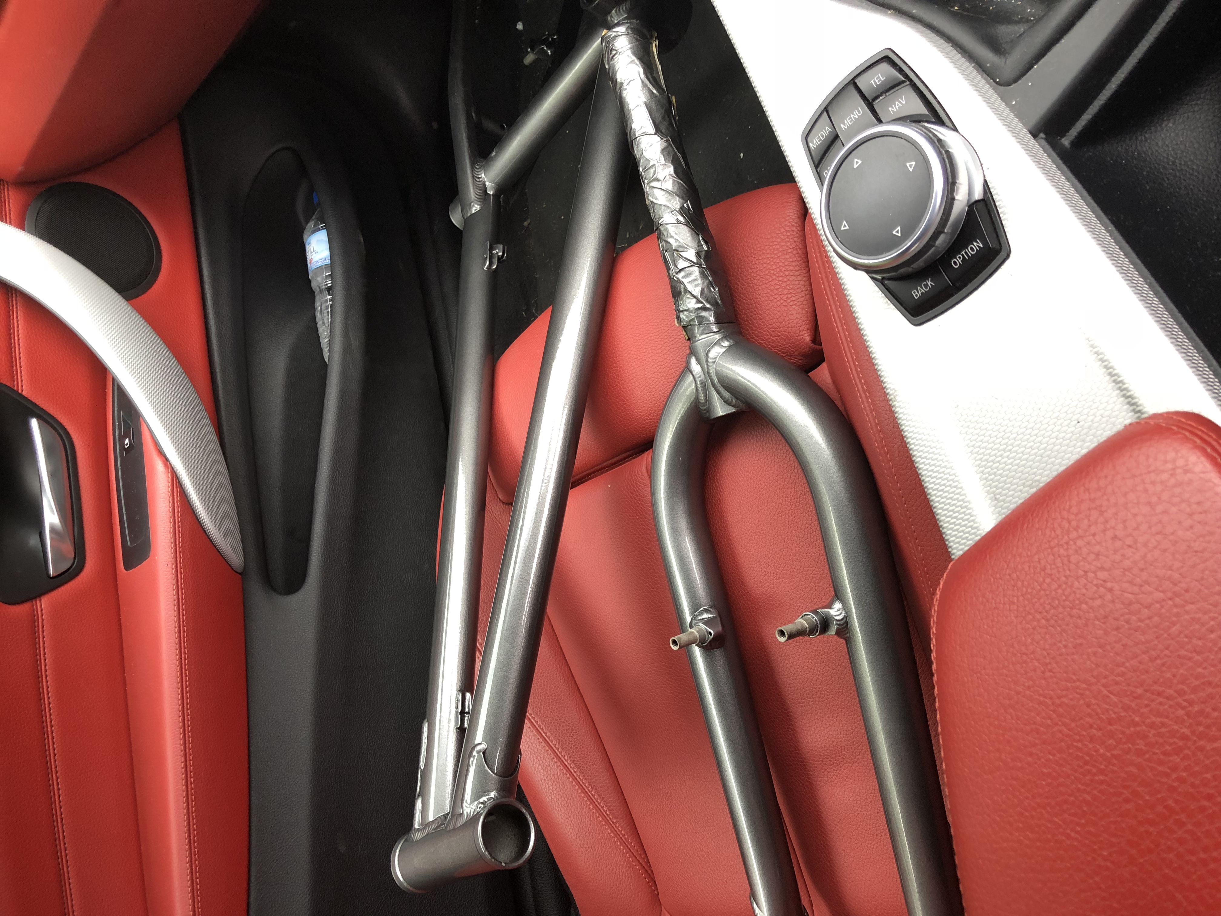

Progress update...
I picked the frame and fork up this afternoon and I was really impressed! Especially considering the price. here’s a pic in transit (riding shot gun haha):
The finish is incredibly glossy, it was still warm when I collected it, fresh out of the oven.
Another couple of pics so you can see it in daylight:
Looks so fresh, and cleaner without those cable tabs :D

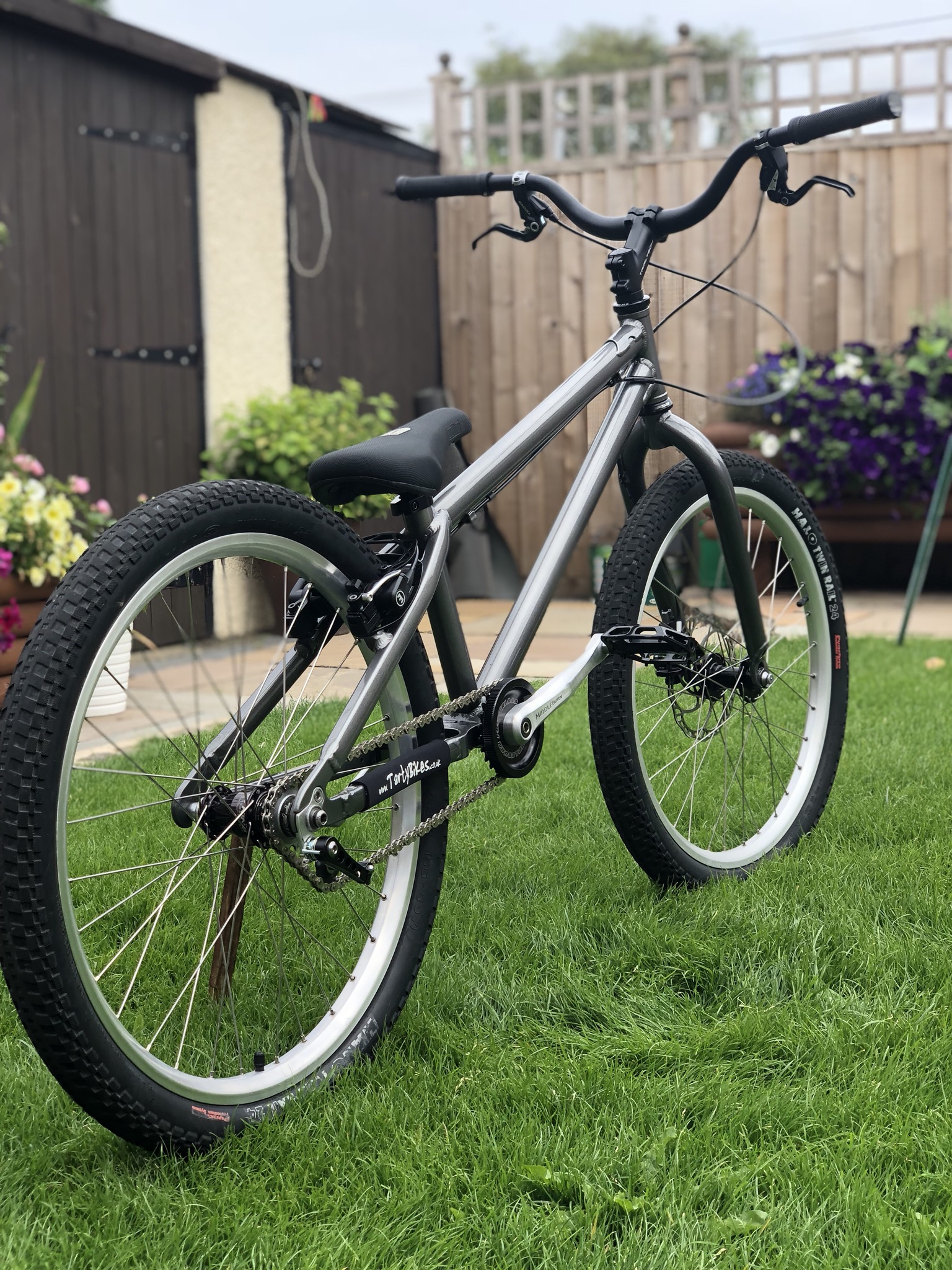

After a good few hours work here is how far I got:
Please excuse the seat (new one arriving tomorrow). I also get some better pictures up.
I love the way it’s turned out.
I’d also love to say it was a simple build, truth is, it was a sod.
Despite the painters capping the BB, some paint made it onto the threads - that made things difficult from the get go. Perseverance paid off though, lots of sweat and tears later the threads were clean and the BB was fitted.
Next up, fitting the headset and forks... nothing to go wrong here I’m thinking. Couldn’t have been more wrong! The star fangled nut decided to spin in the centre, so I couldn’t nip up the headset. Lots of swearing lead me into the garage looking for some inspiration for a quick fix... managed to find an unused new nut... sweet! Apart from the fact echo forks have an alloy steerer that’s considerably thicker than the steel counterpart - meaning the new nut wouldn’t fit (balls!). Decided to cut some extra slits and hammer the thing in, which worked surprisingly well!
Getting over the worst of he problems, I looked forward to setting the HS33 set up, only to get it out the box and immediately remember how fiddly these are to set up on evo mounts haha. But enjoyed doing it and did it with the tyre off for ultimate accuracy. Was surprised how much plastic is on them now, bit cheeky when one now costs pretty much what two used to (I remember a pair being £90!)
Anyway, slapped the tyre on, put it on the bike, inflated to 50psi. Bolted the wheel up spun the wheel which abruptly stopped, checked the far side to find the tyre had not seated correctly, resulting in a fat bulge of tube trying to escape the rim. Argh!
Worse things have happened, cracked on, got everything in the photo fitted, and went for a little spin. Straight away I noticed he chain jumping - the alignment needed sorting, so whipped the rear cog off and adjusted the spacers, also flipped the chain ring over to give the fat chain more clearance from the beefy middleburn bash.
After a few choice words I put it all back together then went for another spin...
I have to say I love the way it rides, popped up a manual and managed the whole street on the first go, a true case of love at fir...second sight haha.
working away tomorrow, so Friday will be the next chance I get to finish it off, but all that’s needed now is the front brake and seat, and I’ll need to trim the rear hose and rebleed the HS33. I’ll look into the custom stickers over the weekend too :)

@Ross McArthur do you have a pic of that tensioner on your bike? Not a big fan of how much the 4-Jeri sticks out and might get one of those
