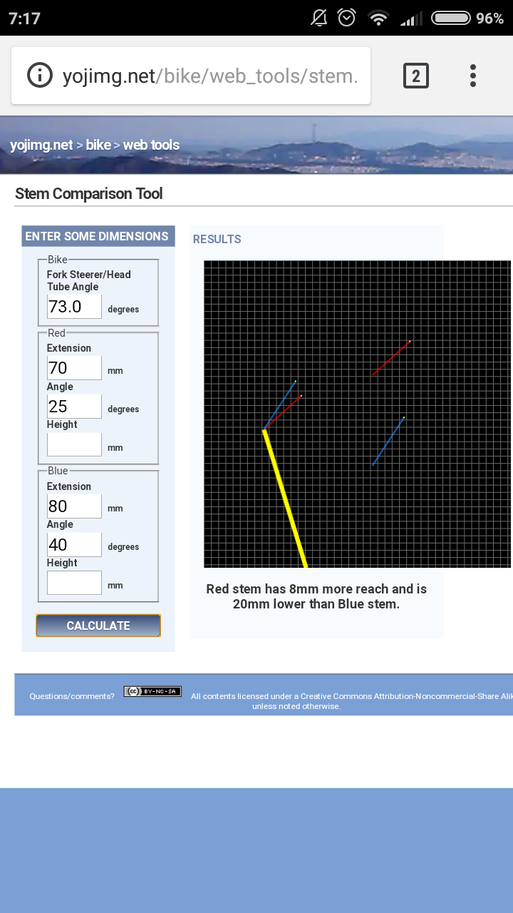

dk2 Posted August 6, 2018 Report Share Posted August 6, 2018 Hi im currently running a Arcade frame with hope stem (70mm at 25 deg). Im looking to get a shorter feeling bike, with a higher front end as a bonus. My question is if anybody is riding the 80mm at 40deg stem, and pros/cons for it. thanks in advance. Quote Link to comment Share on other sites More sharing options...

Mark W Posted August 6, 2018 Report Share Posted August 6, 2018 I went from the 70x25 to a 70x35, and then made the switch to an 80x40. It basically gives you exactly what you're looking for. Those stems work really well on bikes with steeper head angles like the Arcade 1 Quote Link to comment Share on other sites More sharing options...

dk2 Posted August 10, 2018 Author Report Share Posted August 10, 2018 Stem is mounted, and test...feels great on the bike... Quote Link to comment Share on other sites More sharing options...
Mark W Posted August 10, 2018 Report Share Posted August 10, 2018 Winner May need to spend a bike of time tweaking bar position as they may need to shift a little from where you'd normally put them, but glad you're finding it a positive change so far. Quote Link to comment Share on other sites More sharing options...
