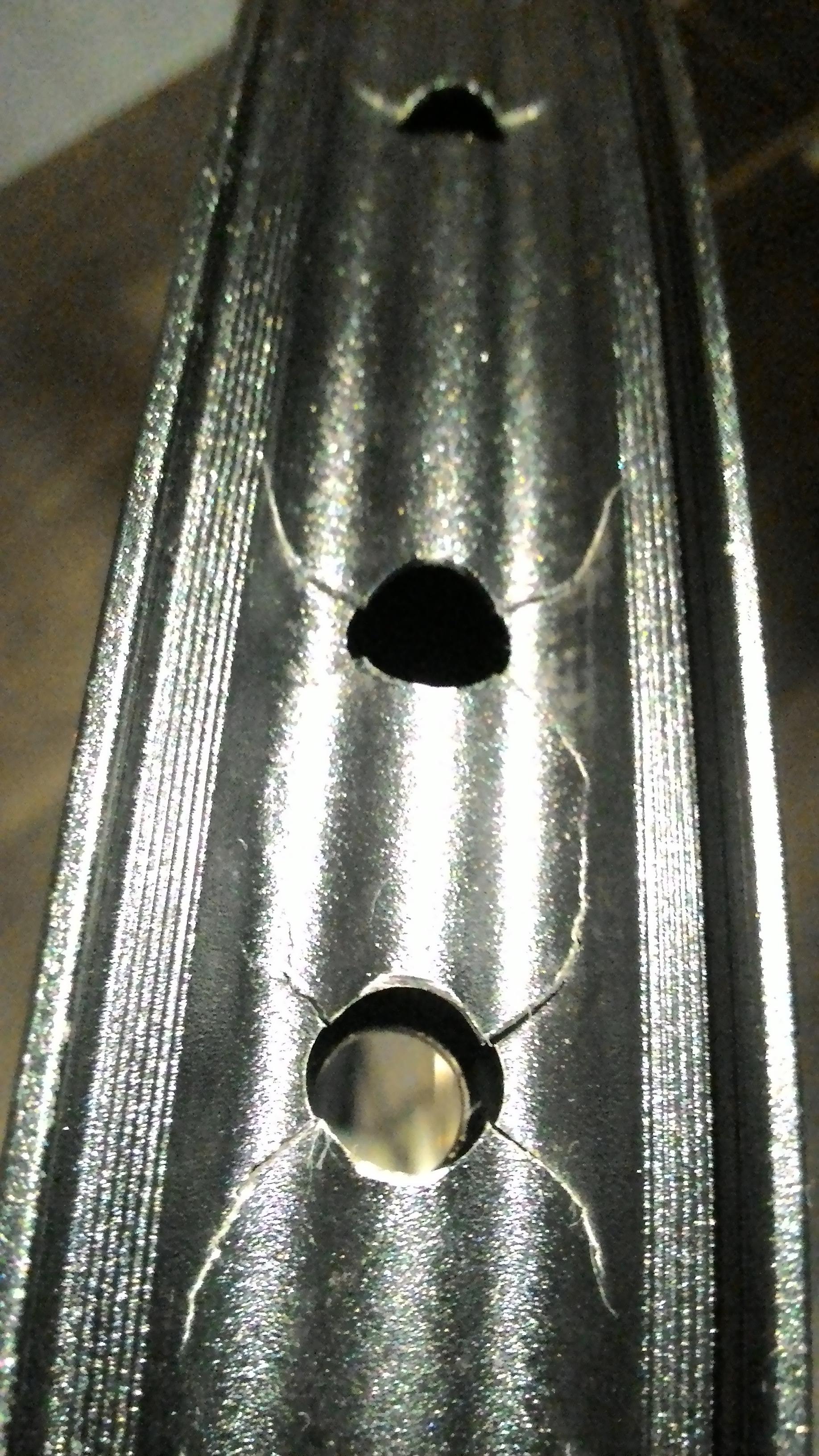

andrey-p Posted July 9, 2018 Report Share Posted July 9, 2018 Hi, I noticed this cracks in all inner holes on my Spank rim on rear wheel. Does anyone have any idea why this happened? Quote Link to comment Share on other sites More sharing options...

andrey-p Posted July 9, 2018 Author Report Share Posted July 9, 2018 19 minutes ago, Luke Rainbird said: Nasty. Have you spoken to Spank about it at all? Yes, I emailed this pic to Spank. I riding on this rim about 12 months. But I used mail forwarding service for shipping from Webcyclery to my country, so I can't use warranty Quote Link to comment Share on other sites More sharing options...

Mark W Posted July 9, 2018 Report Share Posted July 9, 2018 There was the Spank Spike Race 33 which is the latest version of the Spikes. Weird it's cracked the inner wall like that either way - be interesting to see what Spank say! Quote Link to comment Share on other sites More sharing options...

Al_Fel Posted July 10, 2018 Report Share Posted July 10, 2018 I can't help but notice that it looks like the holes on the inner wall are the same size as the outer wall? It also looks to me like the nipples have been on the outer wall? Am I seeing things that aren't there? If you had a wheel built up with the spoke nipples resting on the outer wall I'd expect to see cracks like that. Quote Link to comment Share on other sites More sharing options...
monkeyseemonkeydo Posted July 10, 2018 Report Share Posted July 10, 2018 43 minutes ago, Al_Fel said: I can't help but notice that it looks like the holes on the inner wall are the same size as the outer wall? It also looks to me like the nipples have been on the outer wall? Am I seeing things that aren't there? If you had a wheel built up with the spoke nipples resting on the outer wall I'd expect to see cracks like that. I reckon the hole facing us is the valve hole. My guess is the others reduce down for the spokes. Seriously odd goings on though! 1 Quote Link to comment Share on other sites More sharing options...
Luke Rainbird Posted July 10, 2018 Report Share Posted July 10, 2018 Spacing compared to the spoke hole in the background suggests valve hole too 1 Quote Link to comment Share on other sites More sharing options...
Al_Fel Posted July 10, 2018 Report Share Posted July 10, 2018 Good shout boys. I couldn't see the woods for the trees then haha! 1 Quote Link to comment Share on other sites More sharing options...
andrey-p Posted July 10, 2018 Author Report Share Posted July 10, 2018 Wheel was built in a workshop with a good reputation and I had no problems with it. But couple months ago spokes start loose tension to fast. I was thinking this is nipples problem and order new sapim polyax. Yesterday I got new nipples and see this when taken off rim tape. Quote Link to comment Share on other sites More sharing options...
