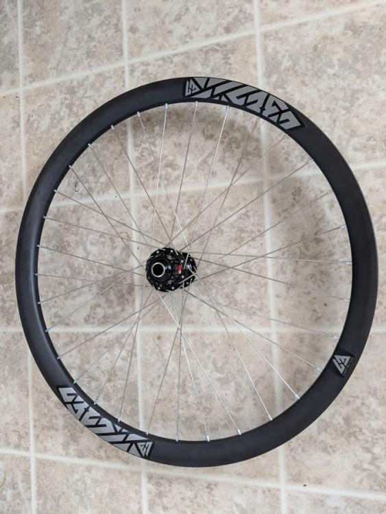

Swoofty Posted June 22, 2018 Author Report Share Posted June 22, 2018 Nextie got back to me about this and they said they would NOT recommend the setup I was seeking on their hookless rims (Holy Rollers, tubes, 40 psi). They didn't offer an alternate setup that would be more appropriate, however. No response from Light yet. Quote Link to comment Share on other sites More sharing options...

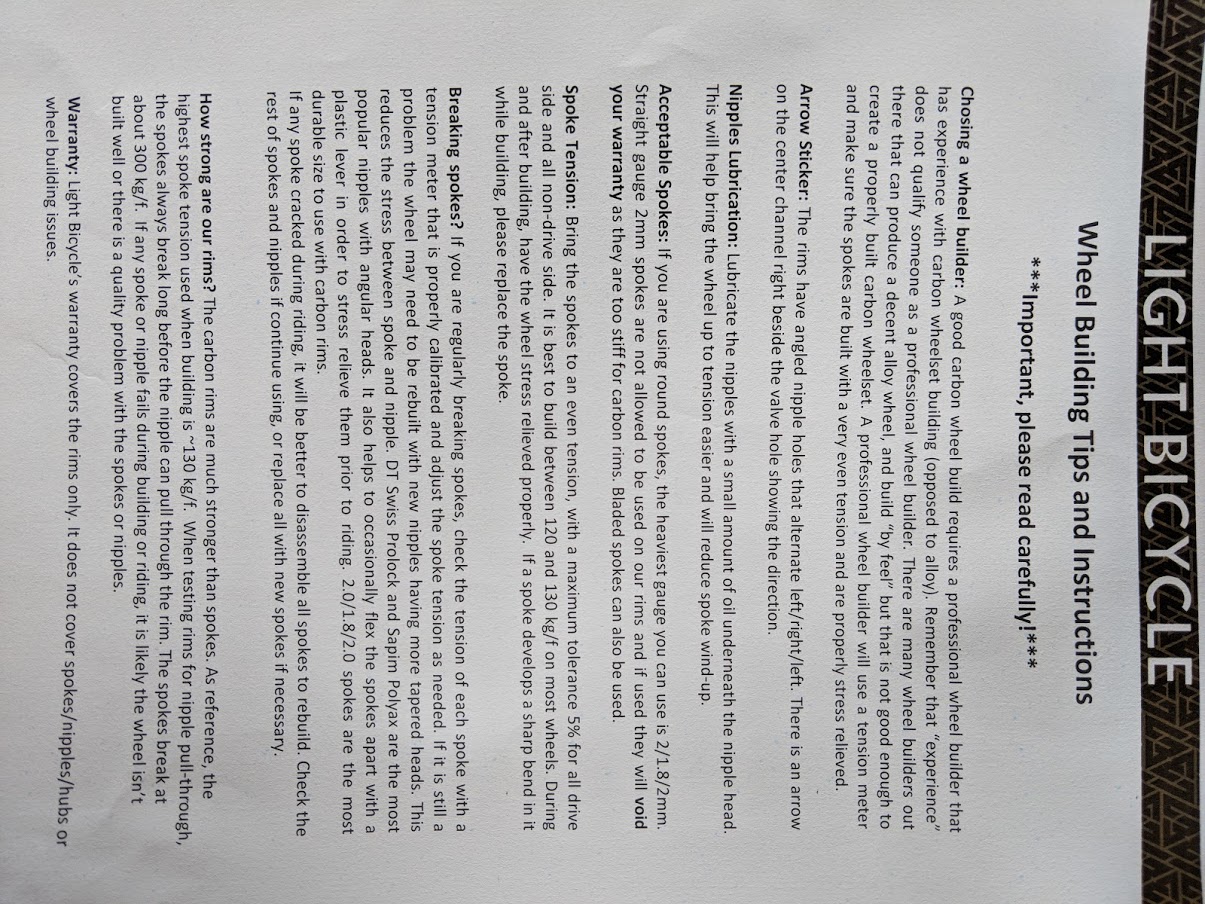

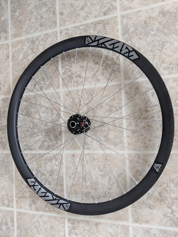

Swoofty Posted July 9, 2018 Author Report Share Posted July 9, 2018 Increasing my carbon footprint. Got the Light rim and laced it up to a DT Swiss 240. I didn't have a chance to ride it this weekend, sadly, so it might be next weekend before I can check it out. They are deep rims and it took me extra time to find a tube with a 48mm presta valve. The rim came with building instruction which I have included below; interesting reading. I'll let you know how it all goes. 1 Quote Link to comment Share on other sites More sharing options...

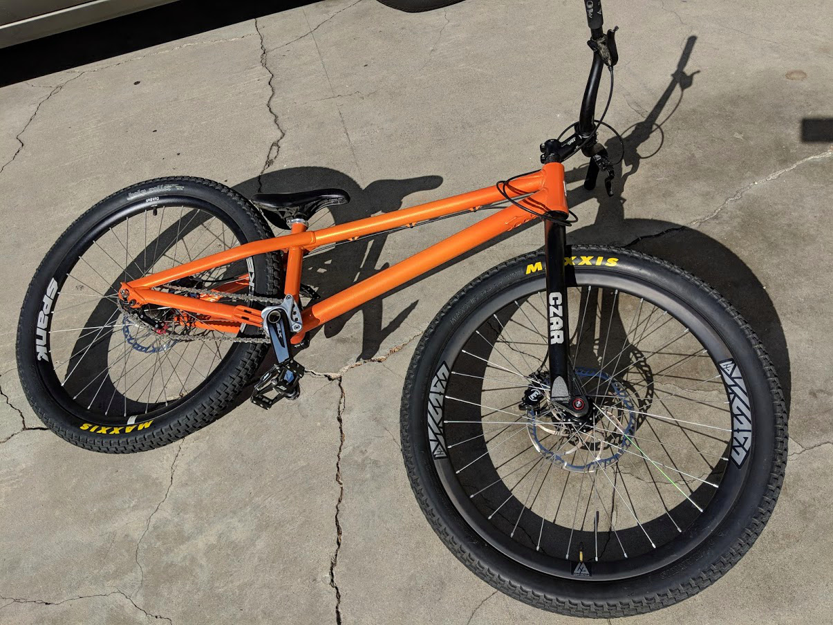

Swoofty Posted July 15, 2018 Author Report Share Posted July 15, 2018 Finally got 2 days of riding on the new Light carbon rim and so far so good. The Holy Rollers were pretty tight on the rim (and not new either) so they should stay put. I'm running 35-40psi with a tube and no issues yet. I tried to do as many front wheel punishing moves that I could so it's as good a test as I can muster so far. I'll give a long term review down the road. 2 Quote Link to comment Share on other sites More sharing options...
