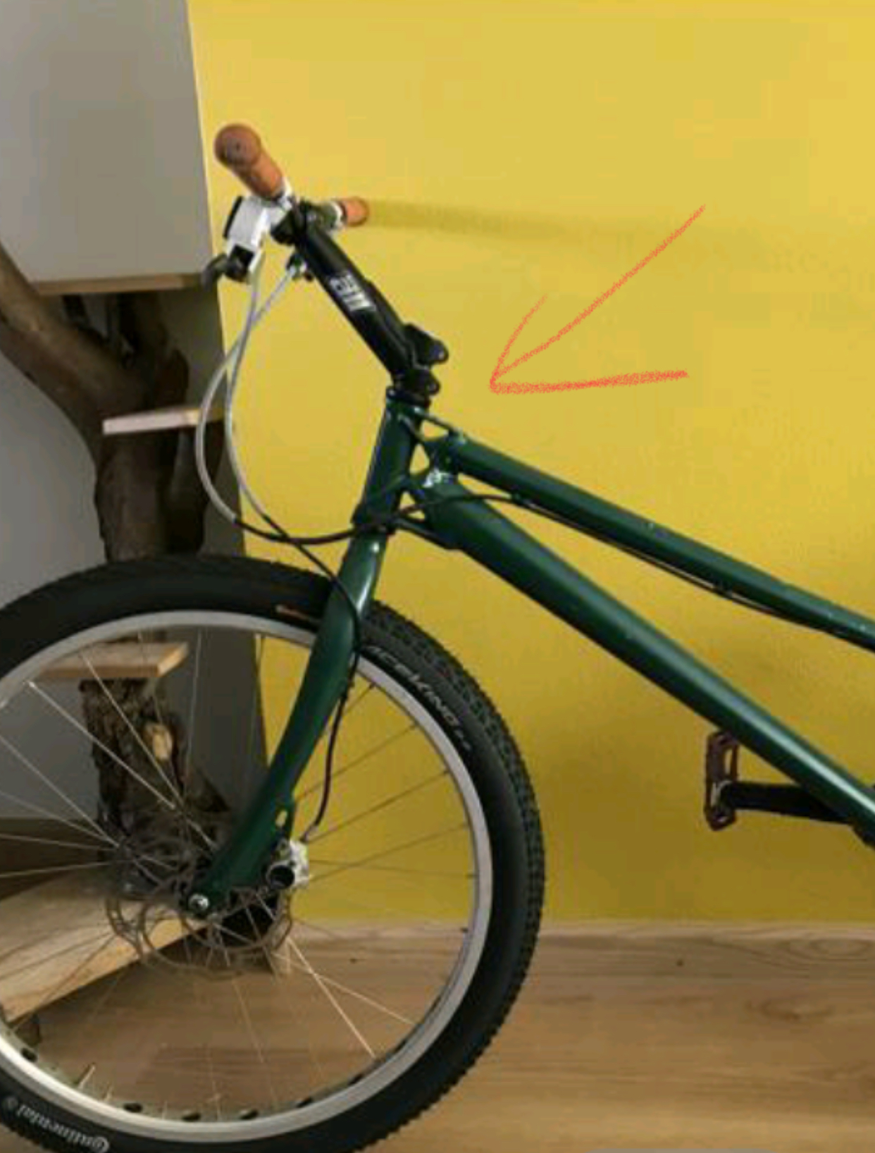

Senna Posted May 8, 2018 Report Share Posted May 8, 2018 Hi evryone i got a question. I am going to buy my first trial bike. And i want to know if this bike is good. Its a koxx xtp frame Quote Link to comment Share on other sites More sharing options...
onza wanabe Posted May 8, 2018 Report Share Posted May 8, 2018 People really used to like them only problem i ever thought might be a flaw is the head tube welds but thats my opinion Quote Link to comment Share on other sites More sharing options...
cwtrials Posted May 8, 2018 Report Share Posted May 8, 2018 Depends on how much you're paying for it. Looks like a decent build and would be a good first bike. Check the frame good for cracks. Quote Link to comment Share on other sites More sharing options...

Senna Posted May 9, 2018 Author Report Share Posted May 9, 2018 Im paying 250 euros for it and its second hand. Its isnt used much. Quote Link to comment Share on other sites More sharing options...
AndyT Posted May 9, 2018 Report Share Posted May 9, 2018 the whole bike? jump on it. assuming there are no cracks, XTP used to be drooled over... I had a version that didnt have that crazy head tube situation, it was awesome. wedge master. does it have the big production number still stamped on it?? Quote Link to comment Share on other sites More sharing options...
Senna Posted May 9, 2018 Author Report Share Posted May 9, 2018 I don't know if there is still a big production of it. I found only one website that selled the frame Quote Link to comment Share on other sites More sharing options...
AndyT Posted May 9, 2018 Report Share Posted May 9, 2018 the whole bike for 250 ??? or just the frame... numbers will be up here Quote Link to comment Share on other sites More sharing options...
Senna Posted May 10, 2018 Author Report Share Posted May 10, 2018 I made a deal with the seller. Now its 175 for the whole bike 1 Quote Link to comment Share on other sites More sharing options...
Dave Anscombe Posted May 10, 2018 Report Share Posted May 10, 2018 (edited) 175 euros is a great price ...But i know what i would do ,and thats remove the paint and check for cracks ,If theres no production number where andy t suggested its a czar ''copy of xtp'' Congrats on your first trials bike Edited May 10, 2018 by Dave Anscombe Quote Link to comment Share on other sites More sharing options...
Senna Posted May 10, 2018 Author Report Share Posted May 10, 2018 Thanks. And i actually really like the paint. And do you mean the czar fram of the street trials. Quote Link to comment Share on other sites More sharing options...
AndyT Posted May 10, 2018 Report Share Posted May 10, 2018 Before the street trials hype czar made a frame that looked very similar to that. in my mind czar, echo, adamant, zhi, zoo.... all made in the same place and were sometimes questionable quality. Koxx held a much higher price tag, more boutique- welds and finishing were usually better than the others but there are always flukes... I had many of every kind of frame, never broke any myself. also never had a brisa Do you want to ride like danny macaskill? this is a trials bike, it is not going to be happy trying the street trials moves in any way. it will not spin, bunny hop, manual etc. It’s long and low... For 175, who cares if it is cracked- the parts alone are worth twice that, buy it, enjoy it!! assuming you want to ride... TRIALS... it is an awesome trials bike. Quote Link to comment Share on other sites More sharing options...
