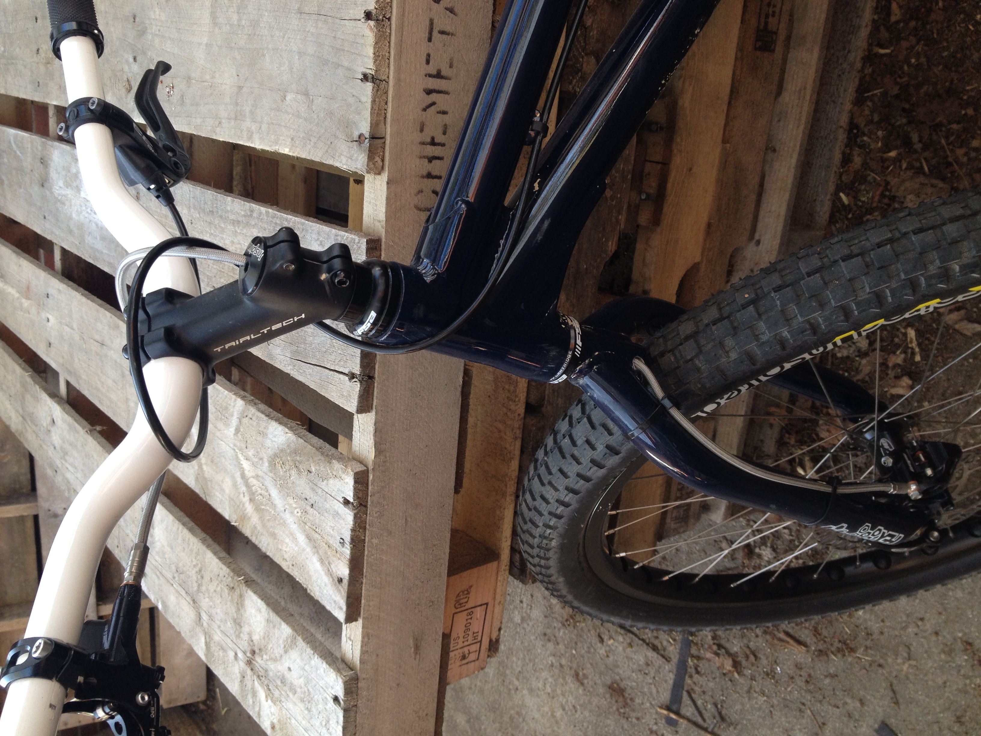

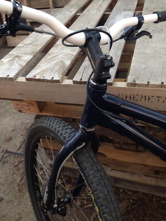

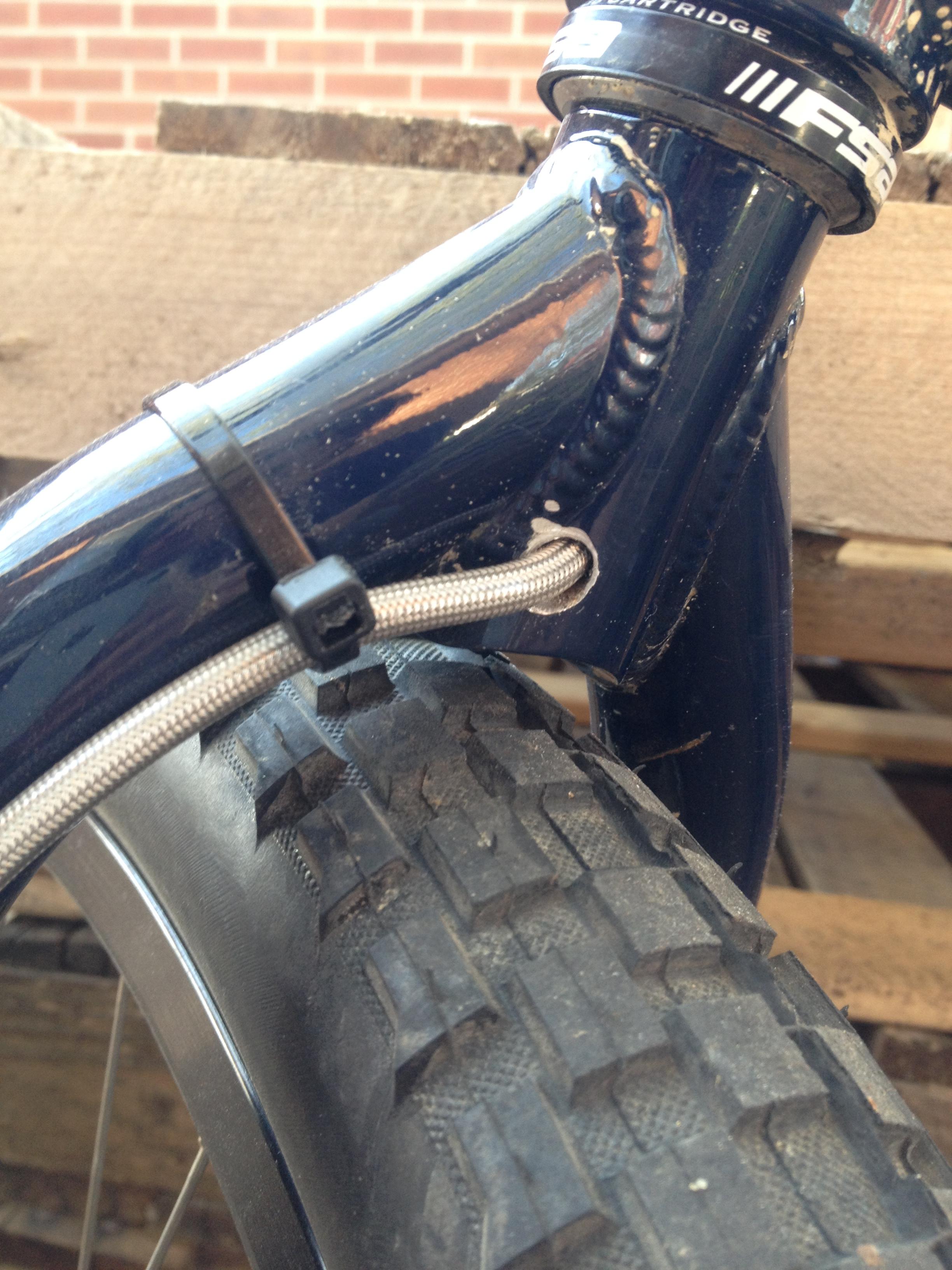

Shadytree Posted May 5, 2018 Report Share Posted May 5, 2018 I cannot find any info on how to route the front brake cable through the steerer tube on a hex. I have the threaded top cap with the hole for the cable but there is not enough space between the tire and the fork to clear. The only way I can see is to drill a hole in the back side of the steerer on the fork. Is there something I am missing? Thanks. Quote Link to comment Share on other sites More sharing options...
Topsy Posted May 5, 2018 Report Share Posted May 5, 2018 Don't think there's anything you're missing. My mate took a file to it. Quote Link to comment Share on other sites More sharing options...
Shadytree Posted May 6, 2018 Author Report Share Posted May 6, 2018 I drilled a hole in the back of the fork's steerer. Worked fine. Thanks. Quote Link to comment Share on other sites More sharing options...
Futurepoke Posted May 7, 2018 Report Share Posted May 7, 2018 Could you please upload a photo. Just curious how it's look like. Quote Link to comment Share on other sites More sharing options...
Shadytree Posted May 7, 2018 Author Report Share Posted May 7, 2018 Here you go... Much cleaner 1 Quote Link to comment Share on other sites More sharing options...
