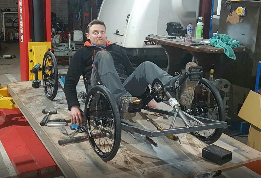

AdamR28 Posted January 9, 2020 Report Share Posted January 9, 2020 6 Quote Link to comment Share on other sites More sharing options...
Luke Rainbird Posted January 9, 2020 Report Share Posted January 9, 2020 That face Quote Link to comment Share on other sites More sharing options...
AdamR28 Posted January 9, 2020 Report Share Posted January 9, 2020 It's my best 'will some bits fall off or not when I get to ride the thing' face Quote Link to comment Share on other sites More sharing options...

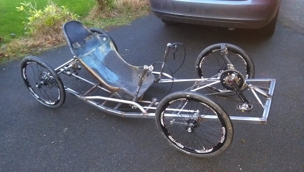

AdamR28 Posted January 19, 2020 Report Share Posted January 19, 2020 Commuted home yesterday... needs a few small tweaks but no bits fell off! A bit more testing to do then ready for bodywork. Much tougher to pedal than I expected - it's allll about the quads, I didn't realise how much MTB uses core, arms, and other leg muscles too! Ed, don't suppose you know what yours weighed? 5 Quote Link to comment Share on other sites More sharing options...
forteh Posted January 19, 2020 Report Share Posted January 19, 2020 The fat end of 40kg I reckon It was really energy sapping on the hill at curby! The wingracers car (no. 1 plate and winners last season) was about 26kg Quote Link to comment Share on other sites More sharing options...
AdamR28 Posted January 20, 2020 Report Share Posted January 20, 2020 There's a hill at Curby? Guess you don't feel it in a car! Thanks for that, need to check weight but hoping to be near that 26kg... Quote Link to comment Share on other sites More sharing options...
forteh Posted January 20, 2020 Report Share Posted January 20, 2020 After the end of the straight about halfway round the bend it starts to climb, it's only a slight incline but after the first few laps you soon realised it was there when the speed dropped off Quote Link to comment Share on other sites More sharing options...
AdamR28 Posted January 20, 2020 Report Share Posted January 20, 2020 Makes sense now you think about it! I can certainly see how hills are an issue with additional weight... Quote Link to comment Share on other sites More sharing options...

AdamR28 Posted January 31, 2020 Report Share Posted January 31, 2020 Well, it works, and it drifts like every RWD car should Weighs almost bang on 30kg like this. Engine needs a lot of work if we're going to trouble the top boys! 5 Quote Link to comment Share on other sites More sharing options...
