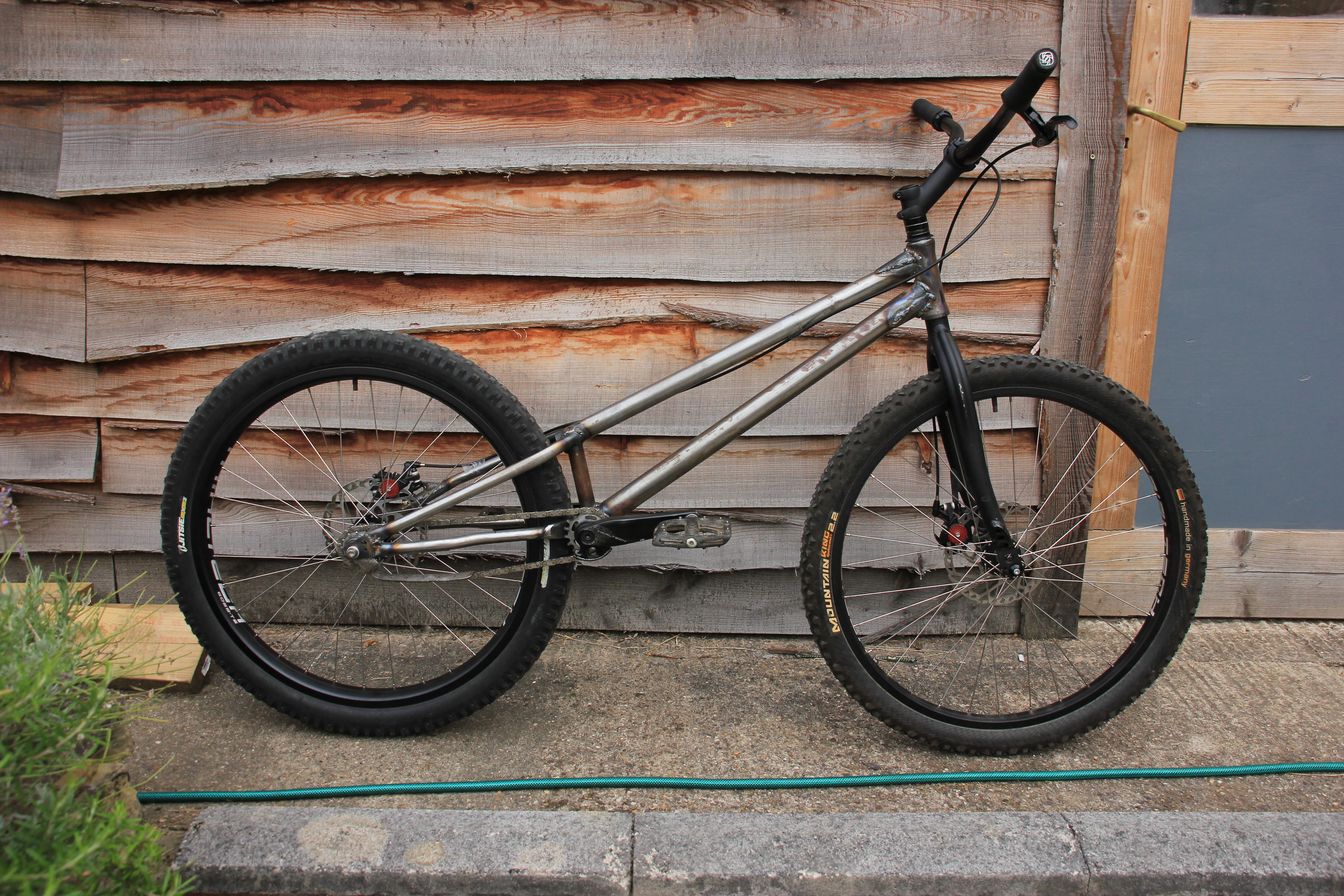

forteh Posted July 5, 2022 Report Share Posted July 5, 2022 1 hour ago, Topsy said: One part of me is most surprised that this worked out cheaper. Looks brilliant! Only cheaper because I have a tame CNC operator at work and we're not massively busy in the factory at the moment 1 1 Quote Link to comment Share on other sites More sharing options...
Topsy Posted July 5, 2022 Report Share Posted July 5, 2022 Okay, that's a very nice thing to have. Quote Link to comment Share on other sites More sharing options...
