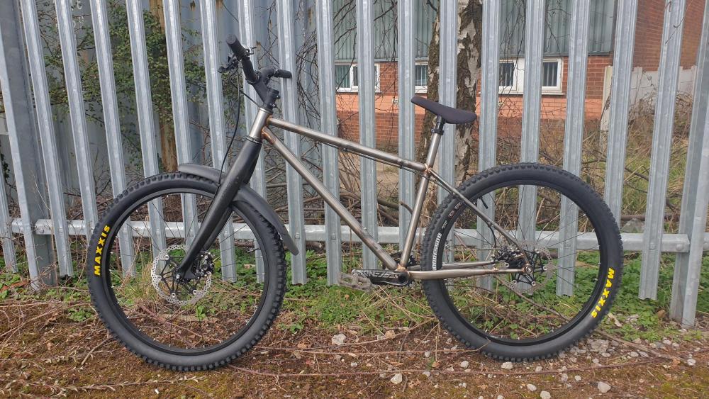

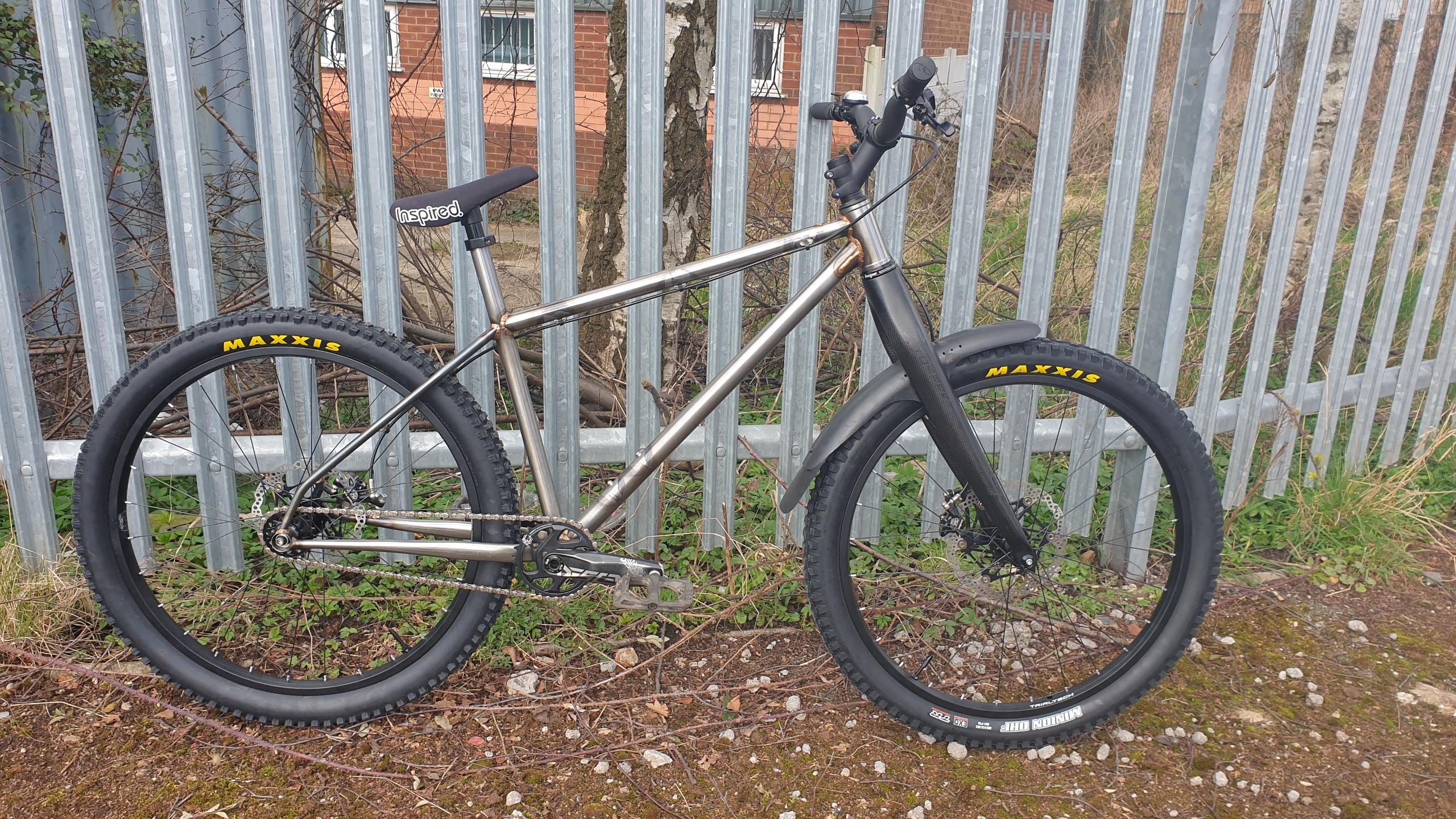

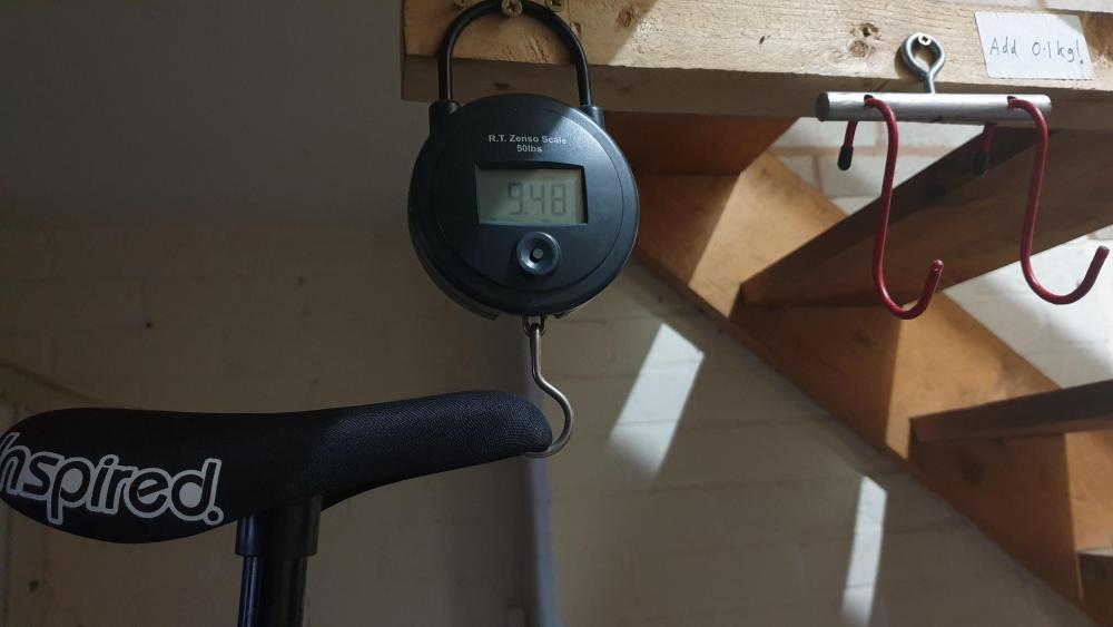

Got it built up:
Light!

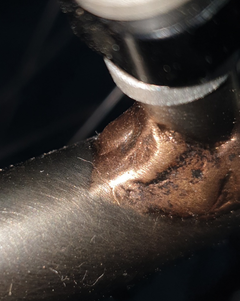

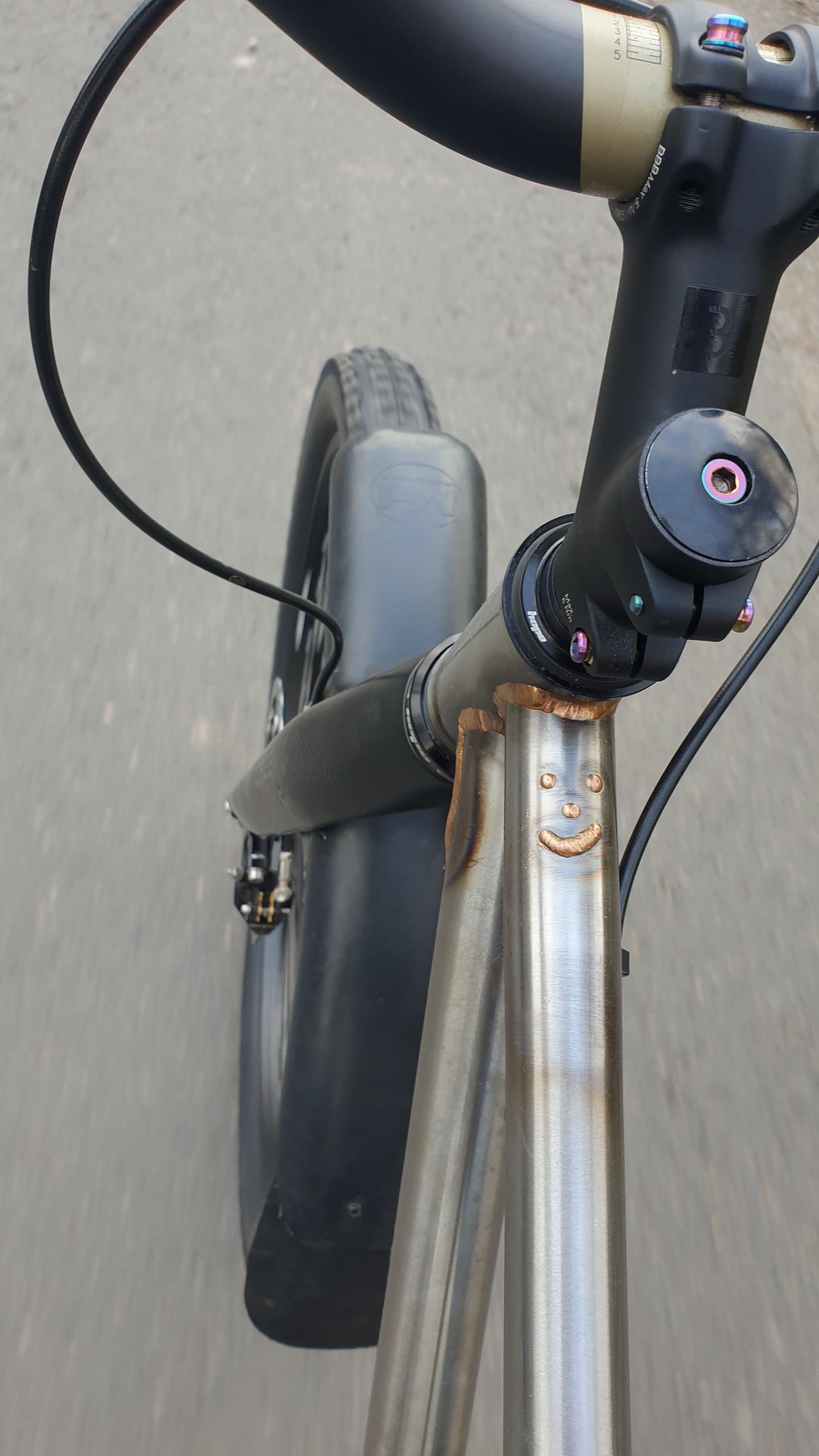

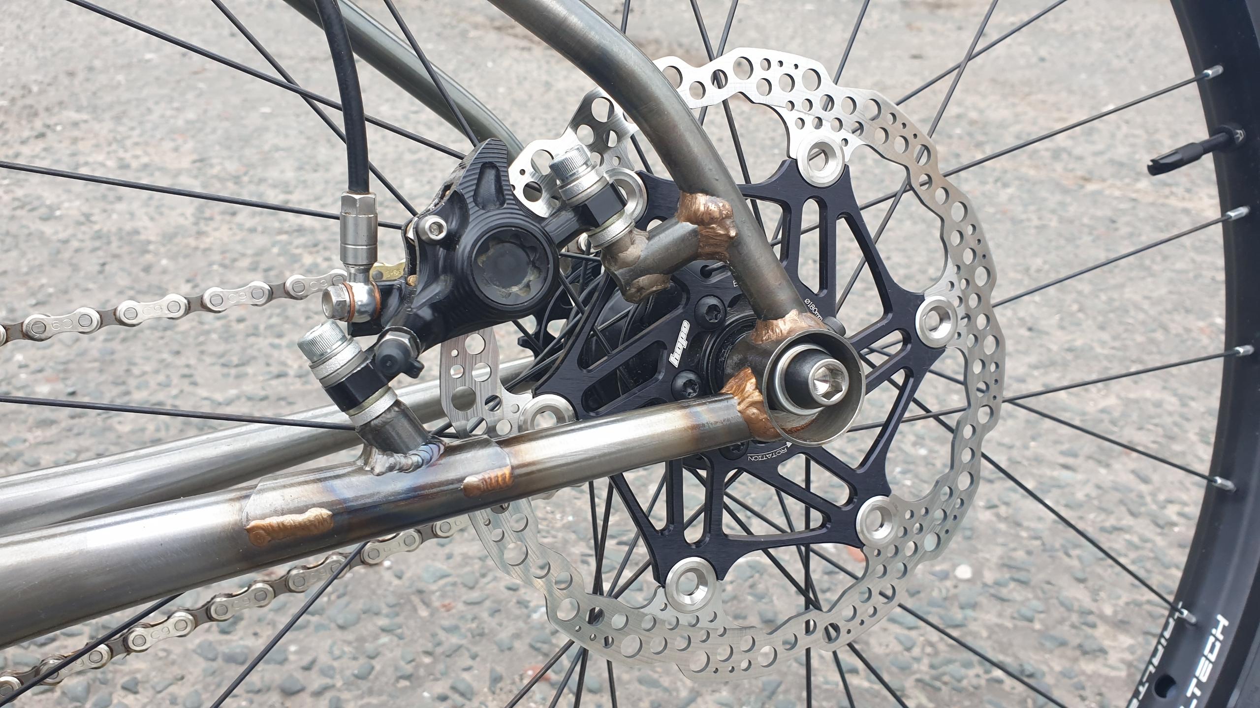

About 10 mins of playing about on the car park and a few small rocks / low walls, and I found the above.... arse. Super disappointed. I think the butting must have ended close to the dropout, so the tube there was 0.6-0.7mm thick...
But, I decided there were positives, in that I had found it early so would be able to fix it rather than have to fit a new chainstay.

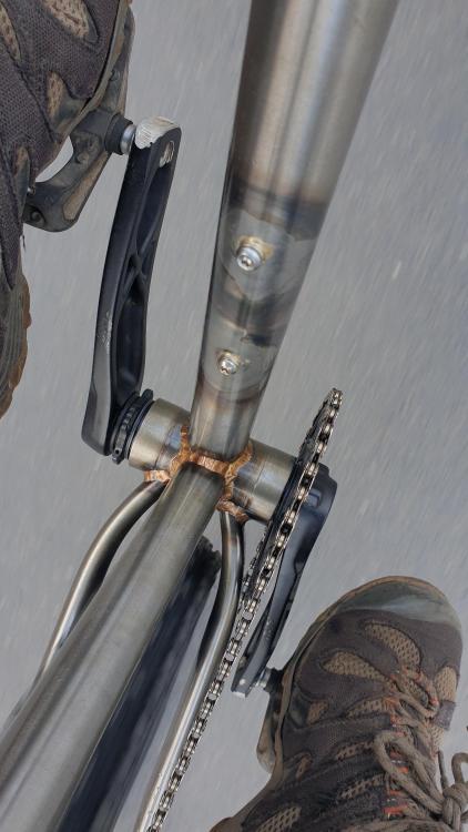

In terms of heat treatment / heat affected zone (HAZ), in theory this is reduced as you need to put less heat into the tube for the TIG braze. However, my testing showed there still is a HAZ and that it's not really much (if at all) different to normal TIG welding.
One benefit I can imagine though is that the ductility of the silicon bronze filler material is huge - something like 65% elongation to break. Steel is around 20%. So, in theory the fillets are 'stretchier' and could load up the tubing less. In turn this could make the frame feel 'springier' and more compliant.
This certainly ties in with how the bike rides - it is so nice! It just floats over those awful eyeball-shaking vibration-inducing micro bumps. There's a descent round here I know well which is pretty smooth but then the last few hundred metres turns into fist-sized rocks. You hit the section at about 20mph and previously it was a real effort to maintain speed and just hang on to the bike - pretty scary to be honest. But last night it kind of floated over. Hard to explain. I guess this is what the 'steel is real' brigade have been on about for years.
Here's a badly out-of-focus photo from a quick blast last night. The bike absolutely flies, both up and down :D
Happy bunny!

Shame about the crack, but a nice and simple modification to just pop it on a gusset at least!
Full-build looks ridiculously nice. If ever I were to do distance-riding again... :wub:
That info about the ductility is nuts! I've never really felt a difference between steel and alloy frames other than the harshness of engagement resonances, but I guess that could be symptomnatic of tiny little frames.

Dave - thanks. The dropouts are something I wanted to work really hard on, so many modern frames are hugely bulky and ugly in this area, so I figured there had to be a neater way... so far, it works perfectly. Wheel doesn't move when riding, have had it in and out again and it went back in exactly the same place, no need to adjust the brake and chain tension spot on. Winning :D

Man maths answer... About £200. I made the BB shell and dropouts on the lathe / milling machine from tube / solid bar, bought the rest of the tubing. Its really nice quality stuff, about the sort of 'level' a custom builder would use in a ~£1000 frame.
Real answer: you need to add consumables (gas, the expensive filler rod - for both the actual frame and all the test joints I did - silver solder for the braze ons), any tools I bought specifically for the project (at least a set of quality holesaws). There's also the tooling used (welder et al, milling machine, lathe) which technically I already had, but would never have got a decent result without them.

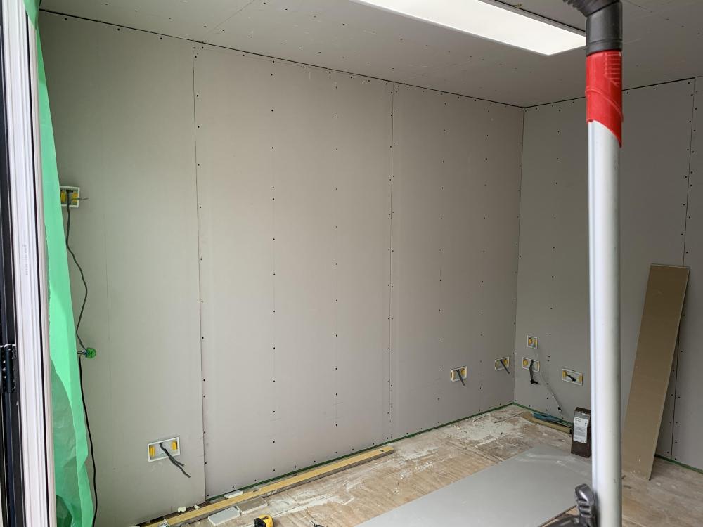

fully clad and finished most of a coat of treatment (2 to go :ermm:), fitted the isolator for the ac, and finished the main boarding ready for the electrician. Might do the floor next as a break and to get rid of some of the big piles of parquet blocks.

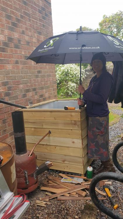

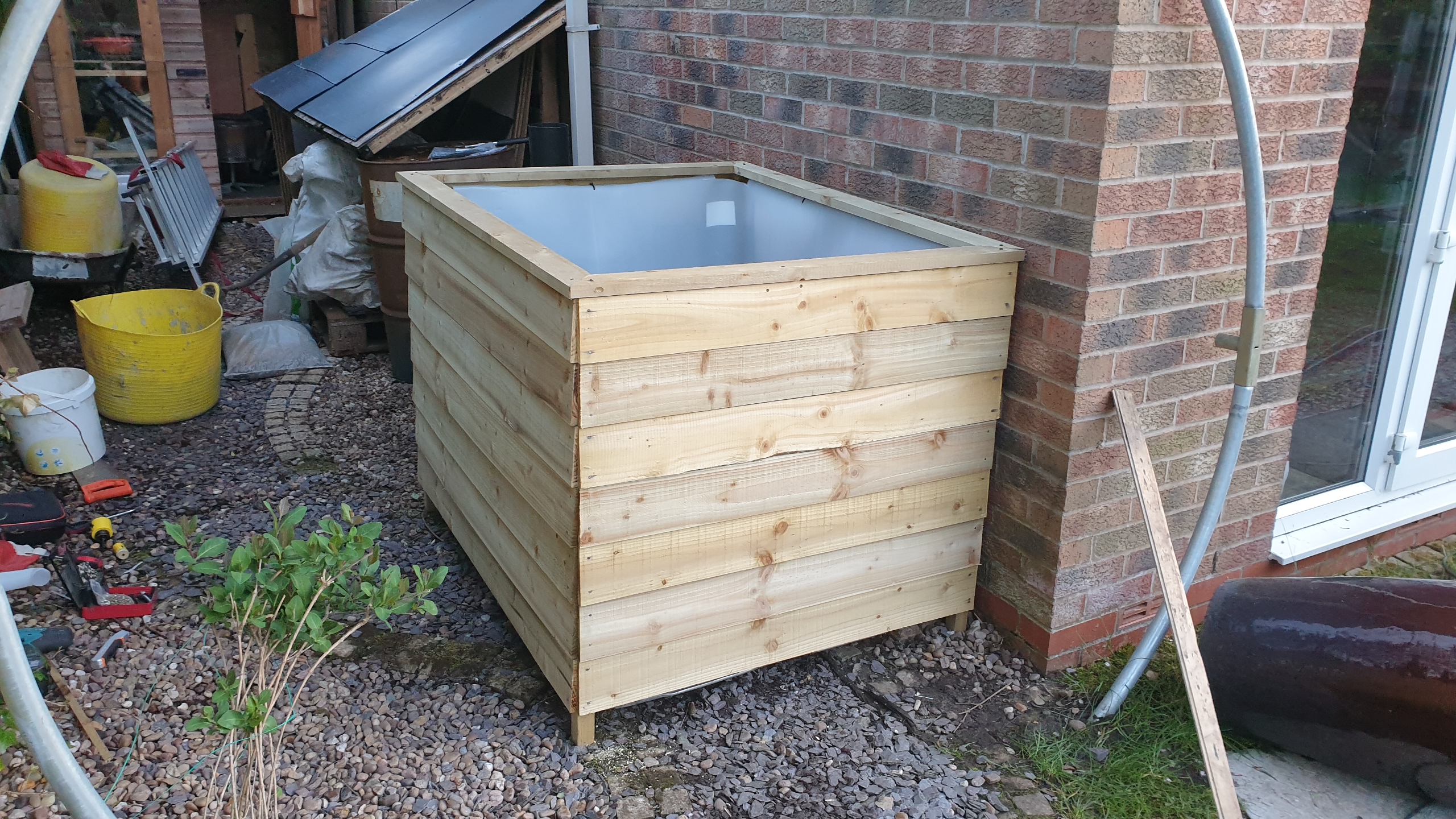

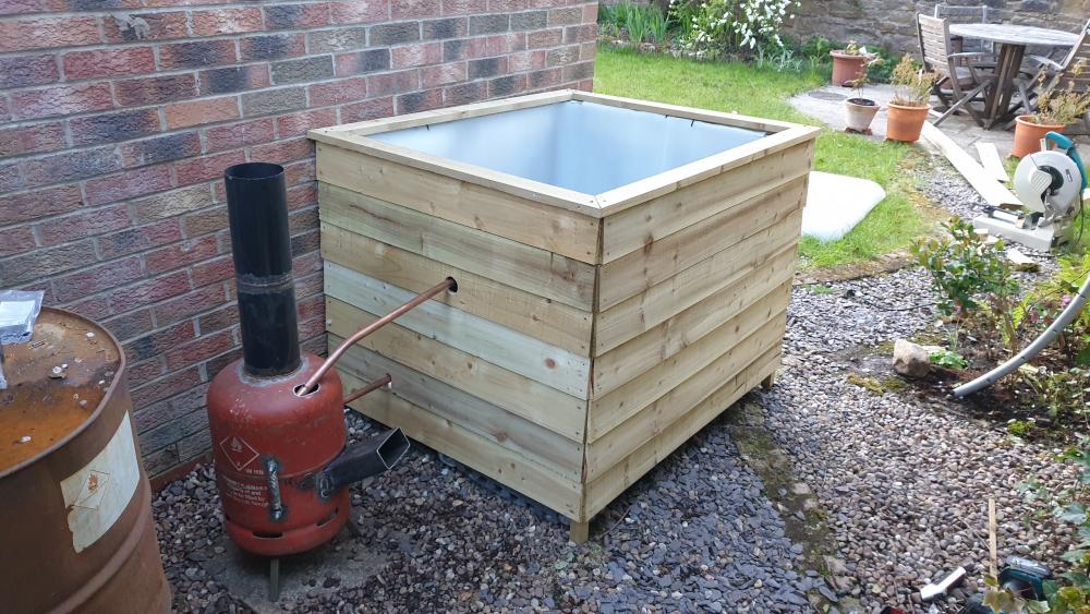

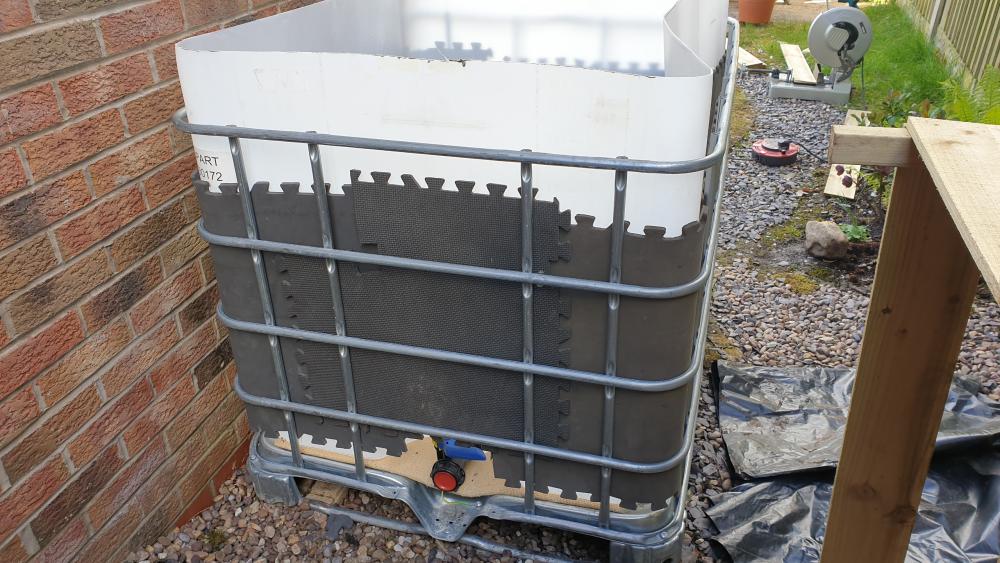

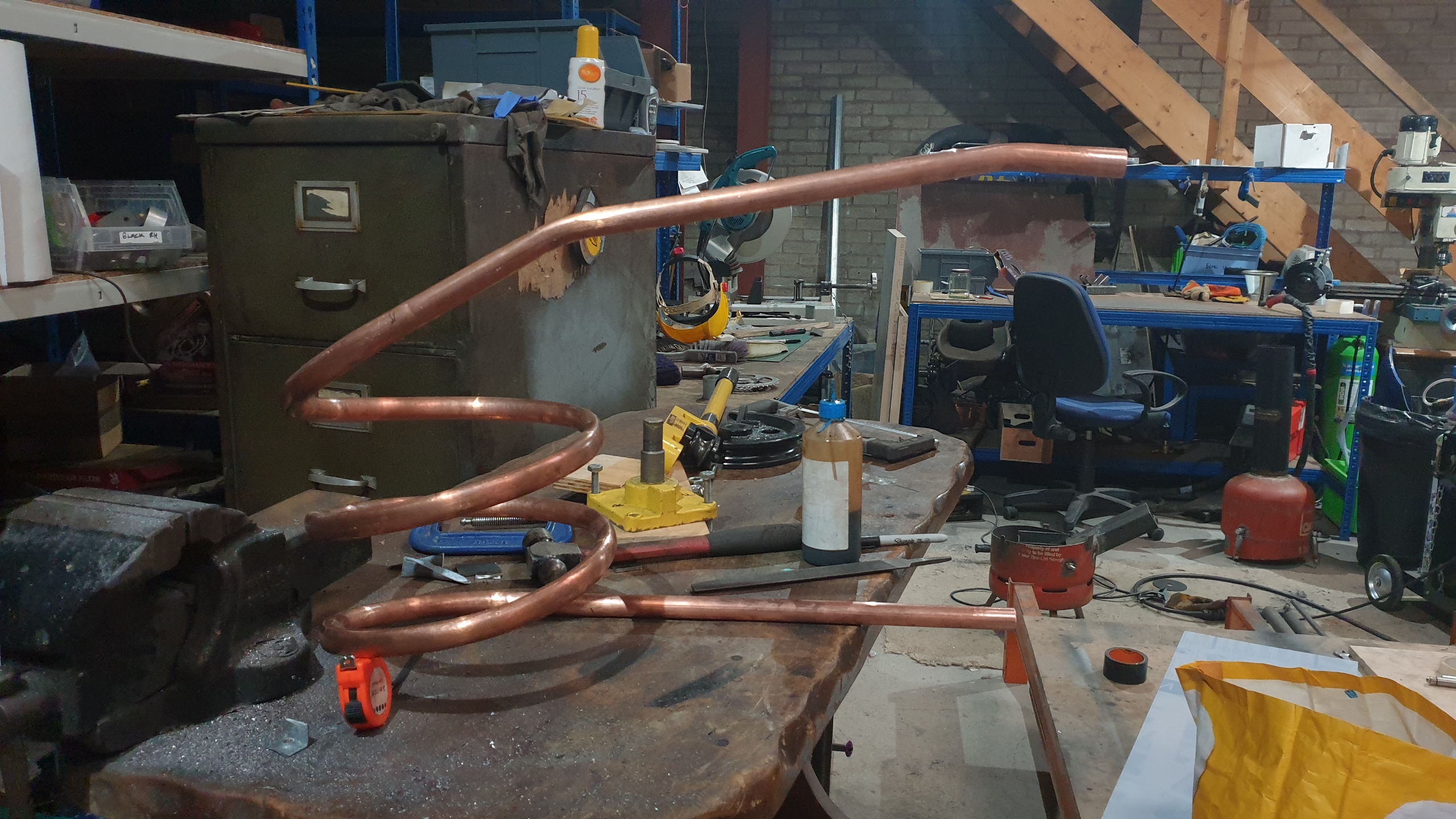

I recently built an off grid hot tub from an old IBC, a dead propane cylinder, a bit of copper tubing, and various recycled insulation type stuff.
First attempt did not go to plan, was way too cold at starting temp and I use crap wood. Even so, the temp went up 4 degrees an hour, but we never actually got in past our thighs :lol:
Will try again in the next week or so now its a bit warmer, and the heater has had a small tweak...

  On 6/9/2021 at 8:12 PM, Adam@TartyBikes said:
Looking pro Rowan!

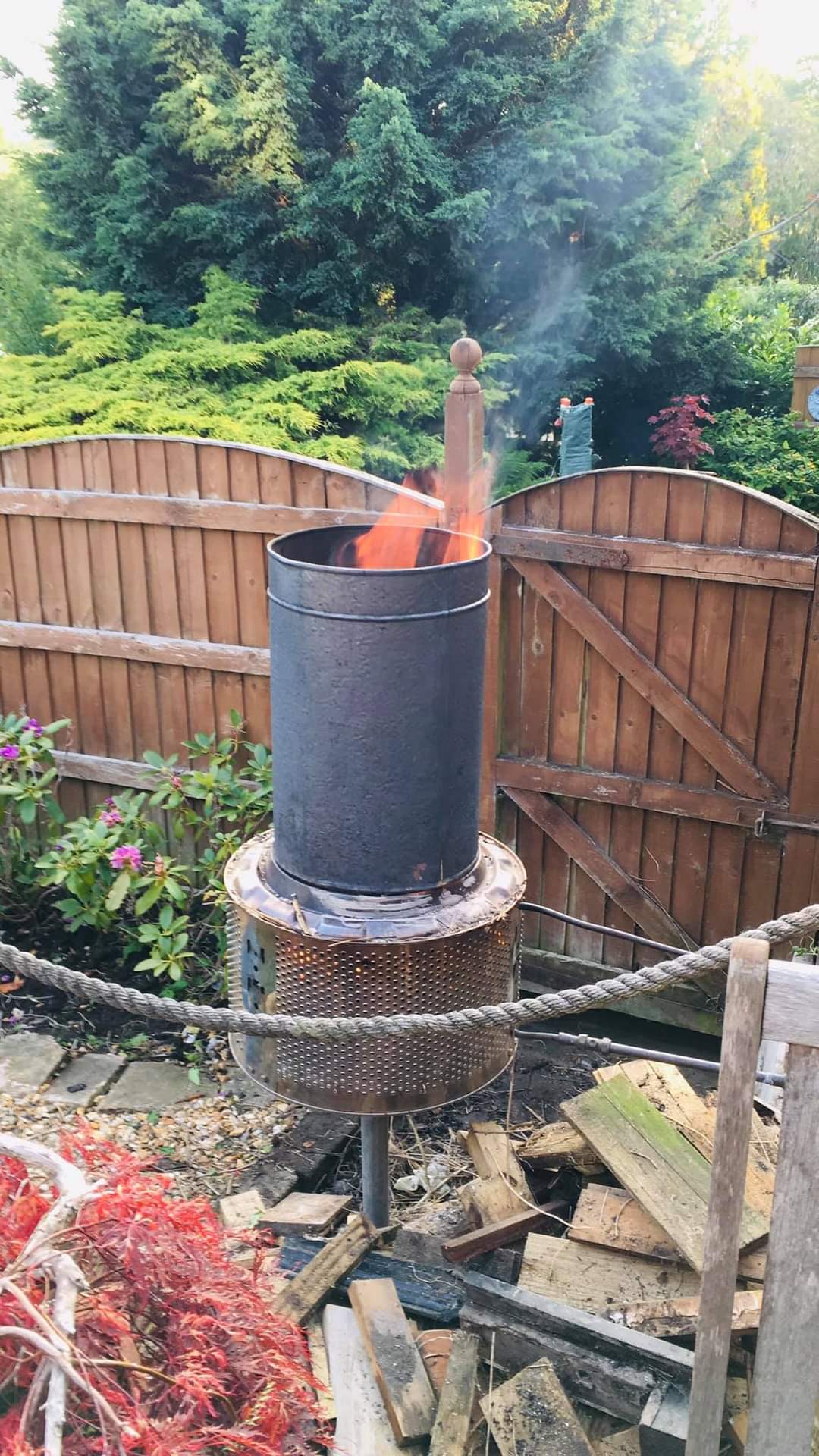

Mate of mine did exactly the same but he heated it with a log burner made from a washing machine drum, works an absolute treat too!

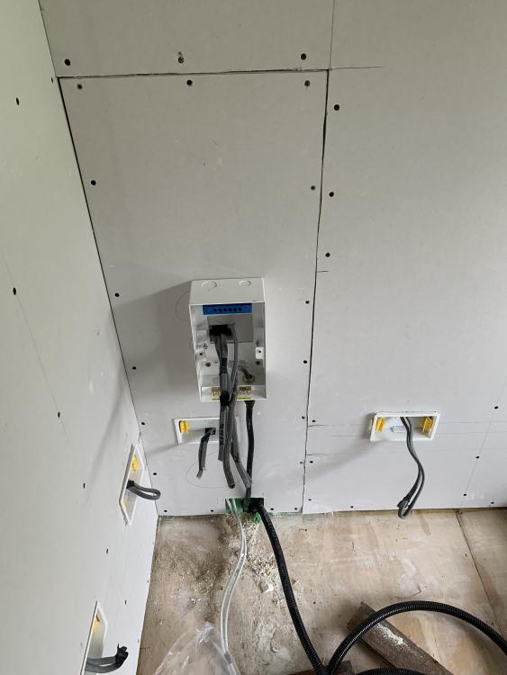

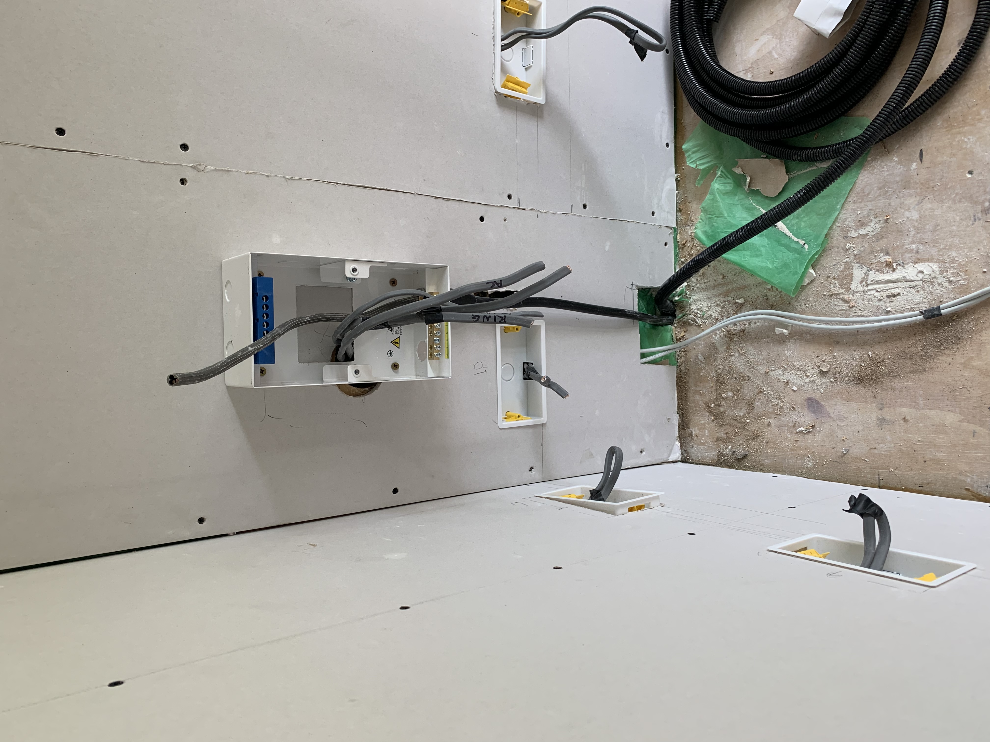

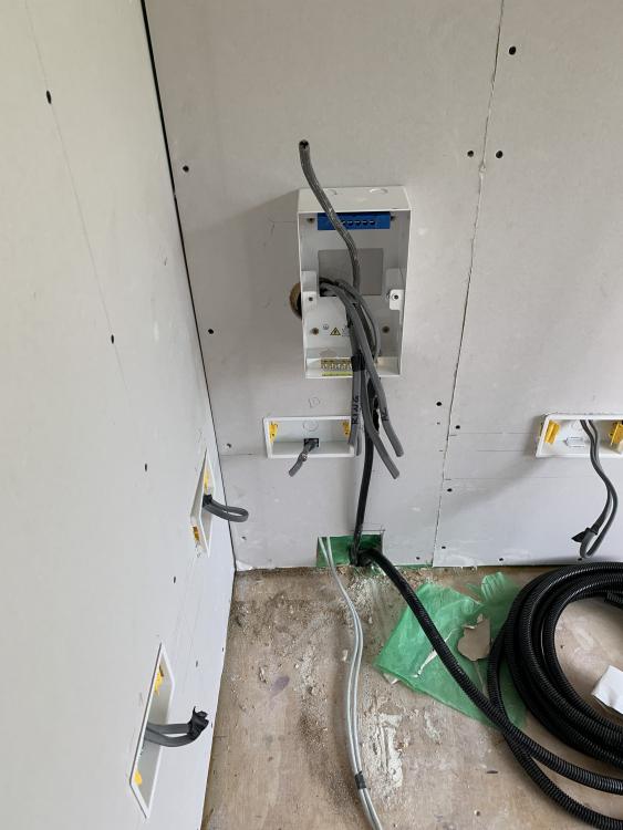

Classic tradesmen….
my usual electrician didn’t do this job it was one of his guys though…
Measure twice…
9670B10F-A9B9-4030-94BB-133D8A1B3A84.thumb.jpeg.a4e276a2864e2fdf585061351d29e51f.jpeg67AE612D-53E9-4D4E-857F-4A3EF0938544.thumb.jpeg.fbe6c7f175d3a90fc2536b23ab34d862.jpeg
I guess partly my fault as I thought the armoured cable could go rear entry, but still they cut that hole so close to the socket it wouldn’t have stayed in the wall.
luckily that’s where they left it for the day so I changed the board. It would have been a complete pig to repair after they finished. It took 10 minutes…
Hot tub works :D
Took 3.5 hours to heat, then we spent 3 hours in it last night. Eyes, nose and skin don't get battered like normal which is a bonus. The water coming out of the heater coil was boiling (!) so that should kill any nasties. It even maintained 36 degrees for over an hour after we'd stopped feeding the fire!
Next upgrade: a better, more insulated lid, in two halves so we can keep it partly covered for winter use.
  • Like 5
