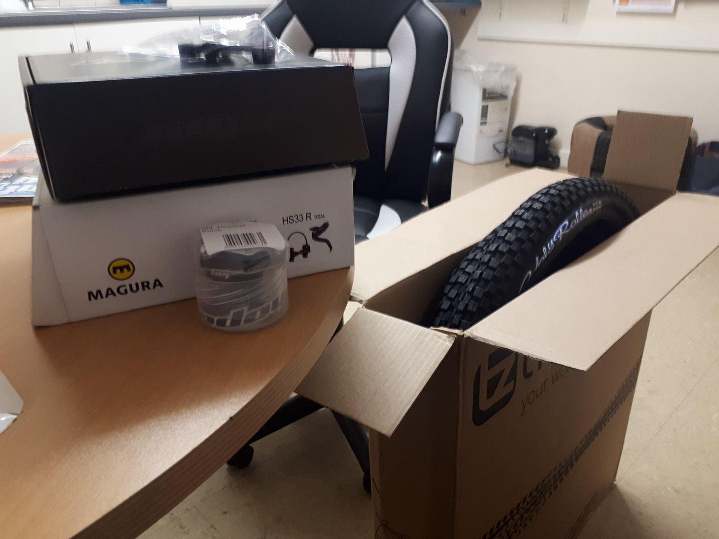

Culshaw95 Posted January 8, 2018 Author Report Share Posted January 8, 2018 More bits arrived today. Tyres, Hope Headset, rear Magura and Hope Trialzone Front brake and then got another crankset arrived tomorrow so hopefully i'll have better luck with them. I tried the magura clamps in hope that they'd be offset enough for my rear wheel but my fears came true so new wheel so its all nice fresh n new 1 Quote Link to comment Share on other sites More sharing options...
