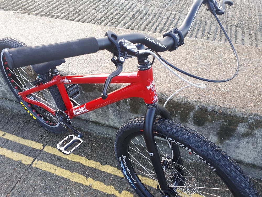

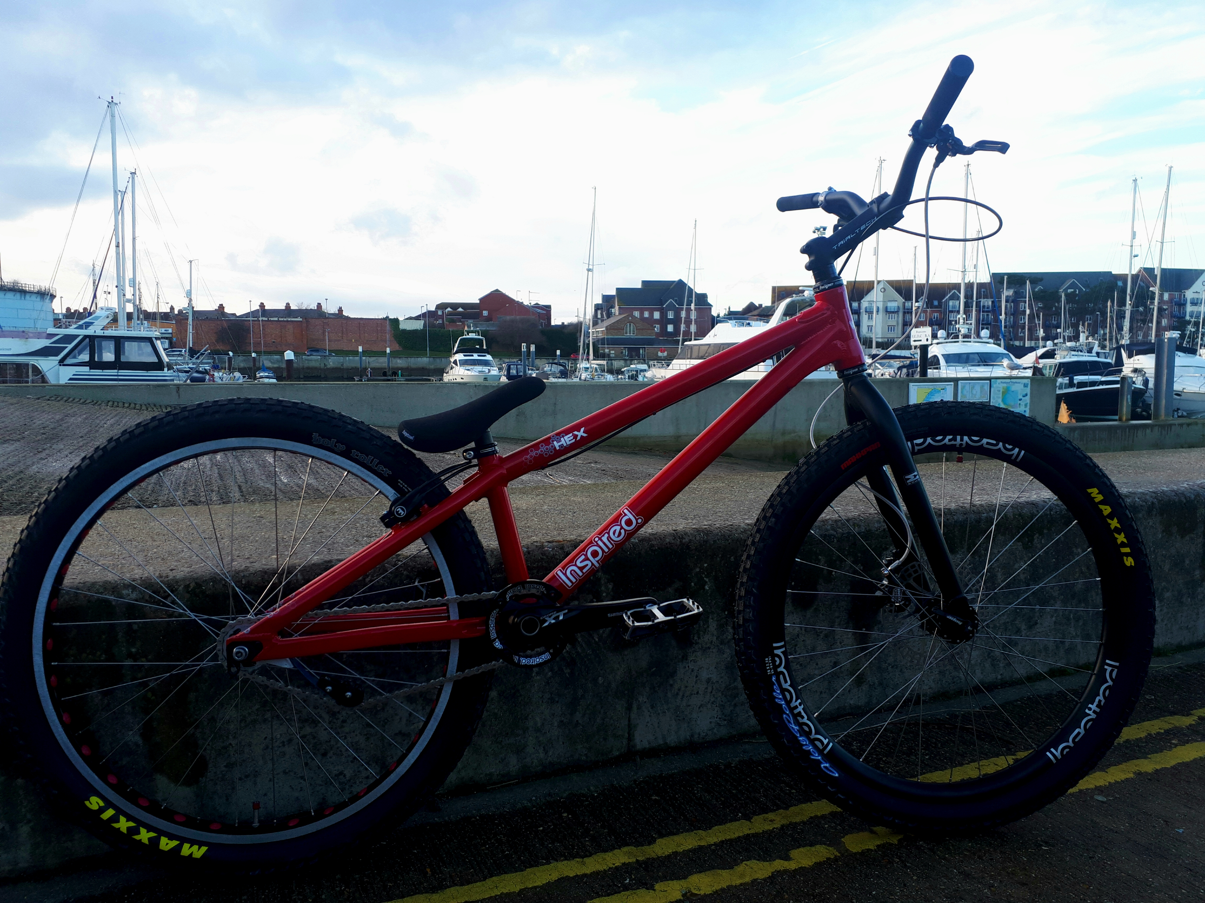

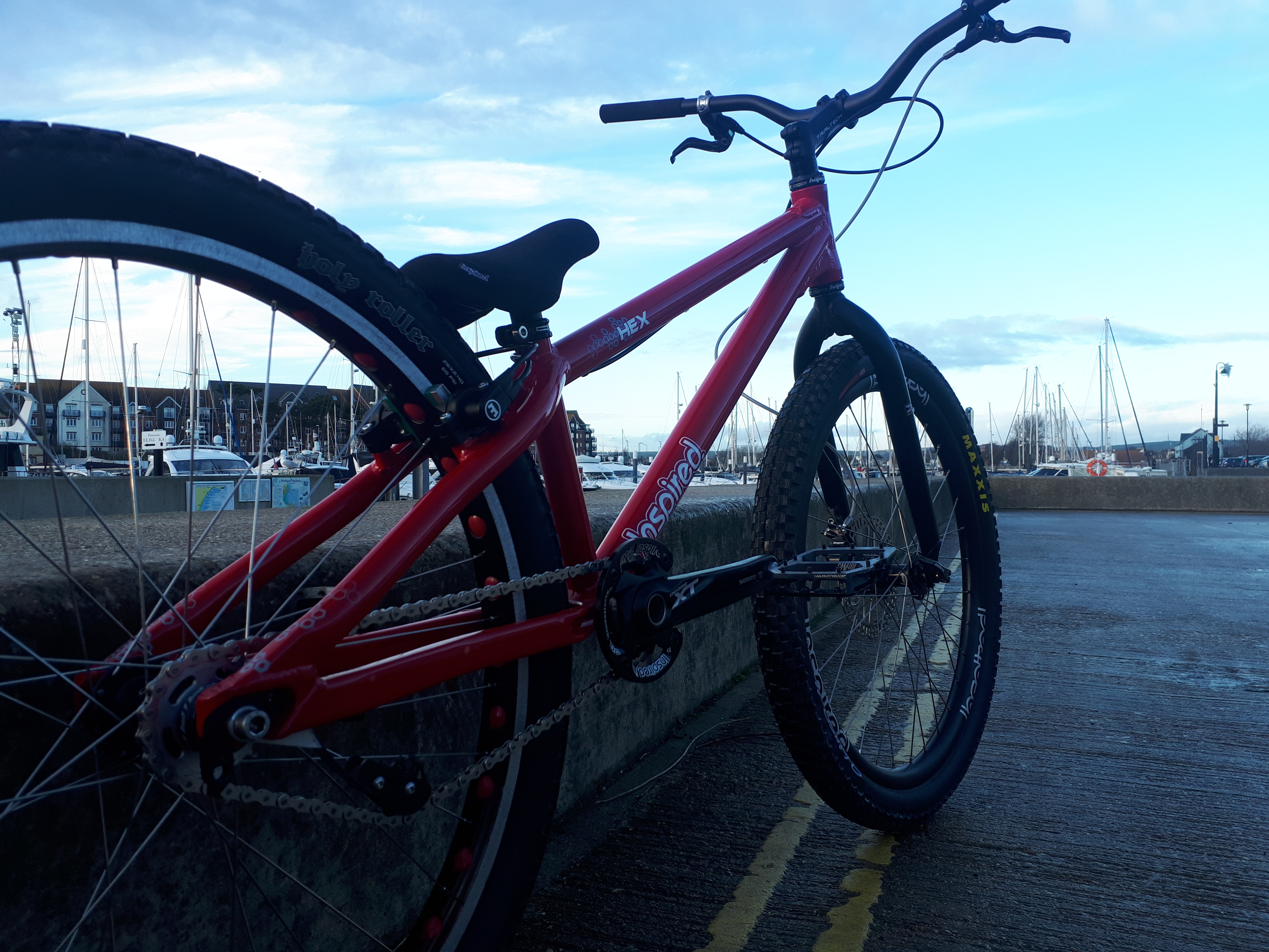

So i've now grown to dislike my current set up after several years of tinkering about to make it how I like so time to start of the new year with a bike build. It kinda went down hill 3 years ago butI seem to prefer starting from scratch and tend to enjoy my bikes more when doing so. So here we are back at this topic and it's finally up n running. Actually impressed with how it rides and have a week off next week to get some propped riding in!20180119_153344.thumb.jpg.2c0994d3ed31ab010d5eea9152276cec.jpg20180119_152757.thumb.jpg.f0d5e55238239668106c052924e322e0.jpg20180119_152823.thumb.jpg.4ae781ce60162cba0793d8c97a134e77.jpg

1 hour ago, Paperclip said:
Exciting, I like a build thread. Is the frame brand new?
Got the frame second hand on ebay have only has storage marks so a scuff on the right side on the bb which is going to be covered up by a bottom bracket so that's no issues, a mark on the head tube which will be covered by a headset and few little marks I wont see under the bb area so no complaints there to be honest
Sounds like a rather nice buy. What are the wheels you're putting on the build? I just built a pair of 26" wheels for my hex and found great options for disc specific rims but not so many options for magura apart from Inspired, DMR DeeVee and Backline's.
I would possibly try the RaceFace cranks on the bike promptly also as these was an option for myself but was worried they might with the 22t cog catch the frame.
I've had the rear wheel for about 4 years now and still going strong which is an Echo TR rim on a Pro II hub, only had to true it once and I had the guys at tartys build me the inspired wheel with Pro 4 hub alongside their shopping list or something on the box? haha. But i've made a big order on Tredz bikes as i can get discount on there which i saved myself about £150 on there which is pretty good going so got a magura rear brake and Hope Trialzone for the front and then tyres, headset, and bb. Only downside is i'll have to wait a little longer for them to arrive but need to sell my 26" Zoo! first to gain space somewhere in my garage...

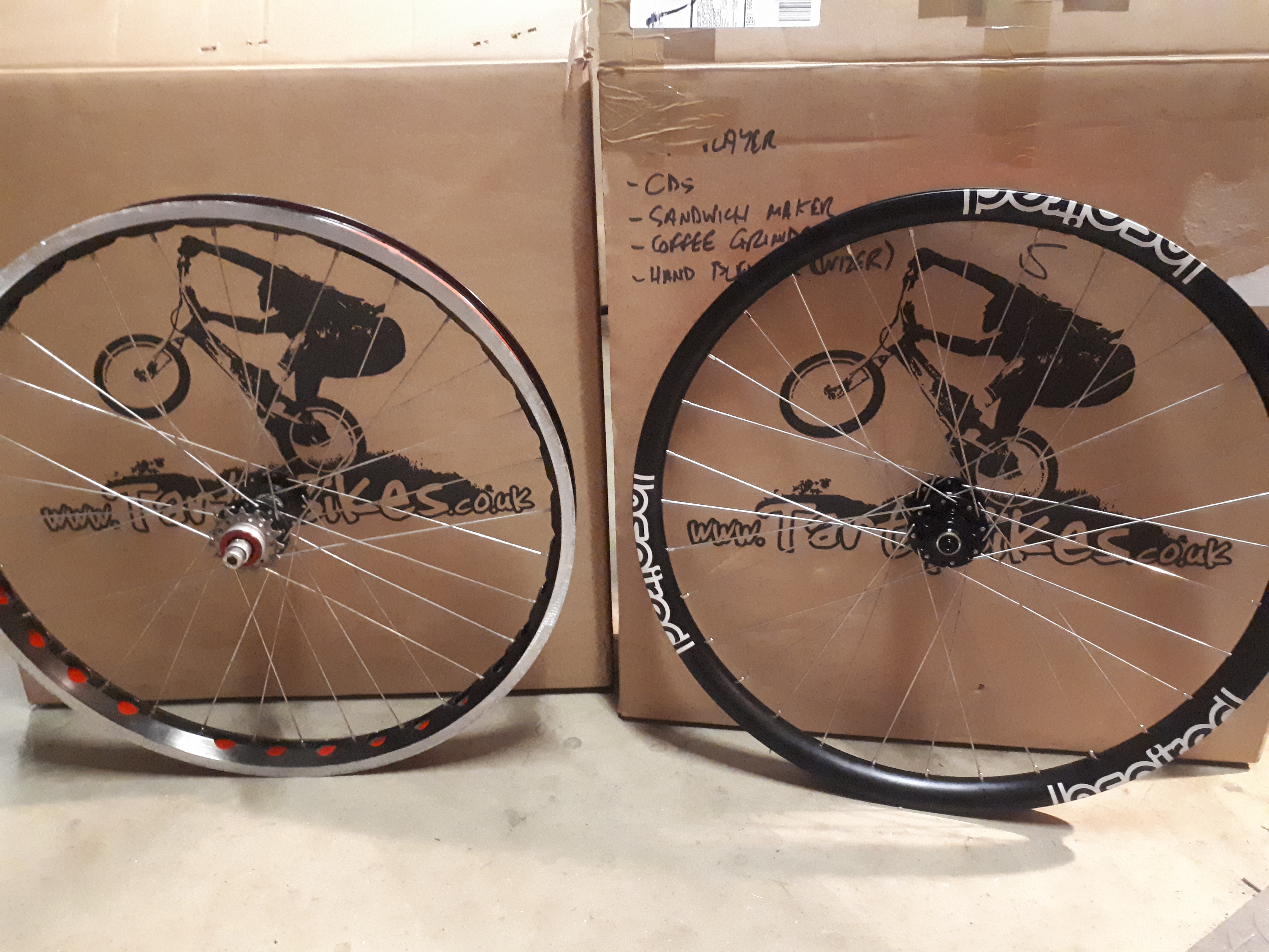

Well it looks like I'll have to get one of them rims -_- just put my rear wheel in to try with these slaves I have and there's no chance without either offset clamps which don't seem to be a thing anymore so guess its gonna be a deevee rim. So anyone wanna buy a Hope Pro II on a 44mm Echo TR rim? haha...
