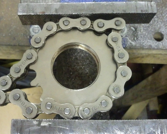

Mark W Posted December 11, 2017 Report Share Posted December 11, 2017 Doooooon't get a chain whip! They're OK for using to undo cassette lockrings, but they're in no way strong enough to take a fixed sprocket off. The amount of calls I got when I was at TartyBikes from shops saying "It's impossible to take off, I've broken ___ chain whips trying" was mental. This is a rough idea of what to do: But essentially, wrap some chain around the sprocket, clamp that in a vice then turn the wheel off. It's best if you've got two people involved - shocking works best, so giving it a 3 count then trying to unscrew simultaneously is the way to go, not just gradually loading it up with more power. Tyre on and inflated to make life easier! 1 Quote Link to comment Share on other sites More sharing options...

Mark W Posted December 12, 2017 Report Share Posted December 12, 2017 No worries Can't remember if it covers it in the video, but if you find the chain/wheel slip around in the vice, you can 'pinch' a little triangle of chain (so instead of wrapping around like it normally would, you create a little peak by one tooth by making a little triangle of chain). That stops it being able to spin as it can't force it's way through the vice. 1 Quote Link to comment Share on other sites More sharing options...
AdamR28 Posted December 12, 2017 Report Share Posted December 12, 2017 1 Quote Link to comment Share on other sites More sharing options...
Djrouge Posted December 12, 2017 Author Report Share Posted December 12, 2017 Aaaahh, I get you now. Thanks Mark and Adam for explaining that. I can imagine pulling my hair out with it slipping in the vice. Very clever solution to that, you guys have obviously done a few of these 1 Quote Link to comment Share on other sites More sharing options...
