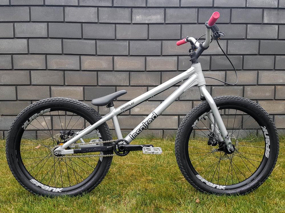

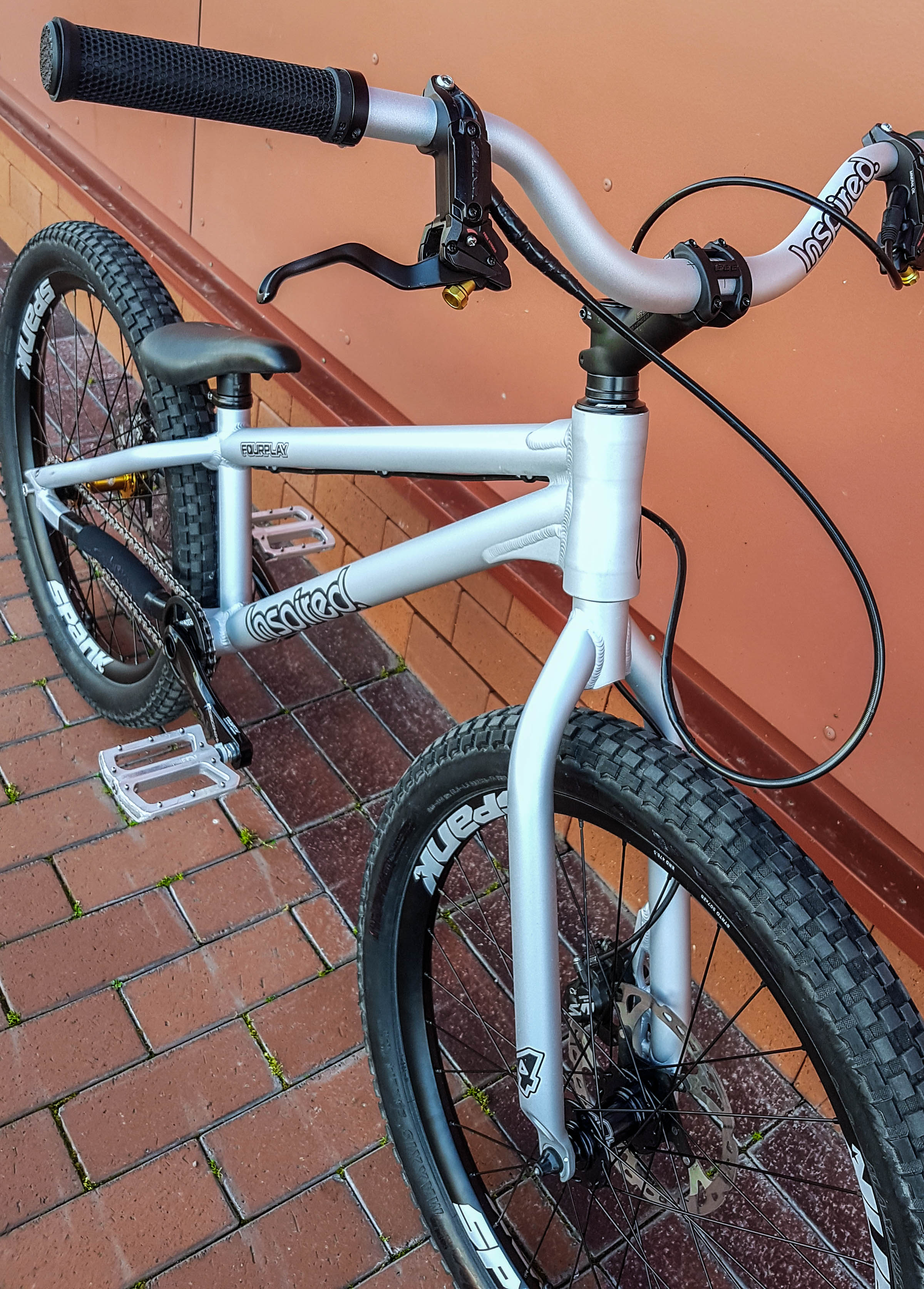

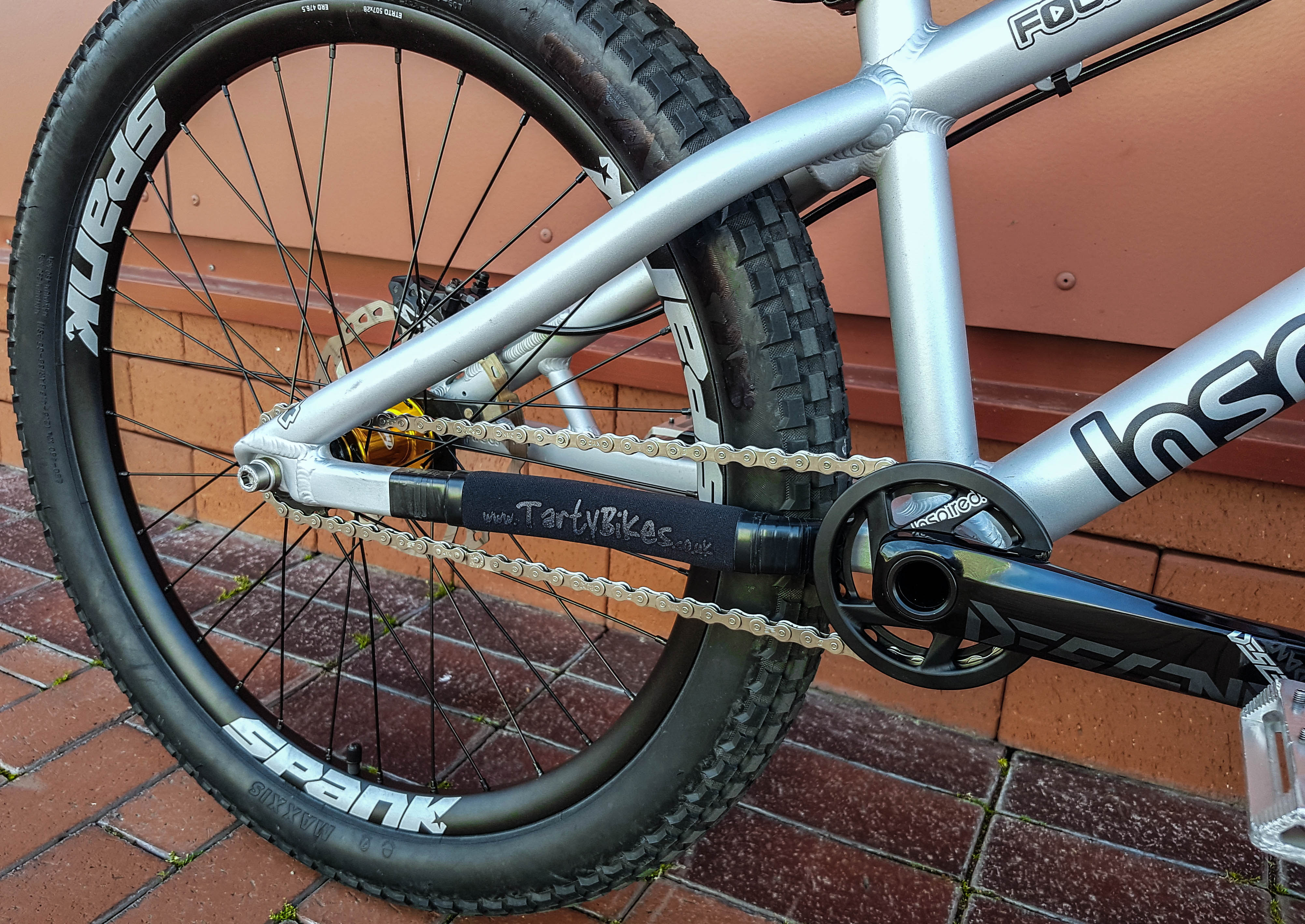

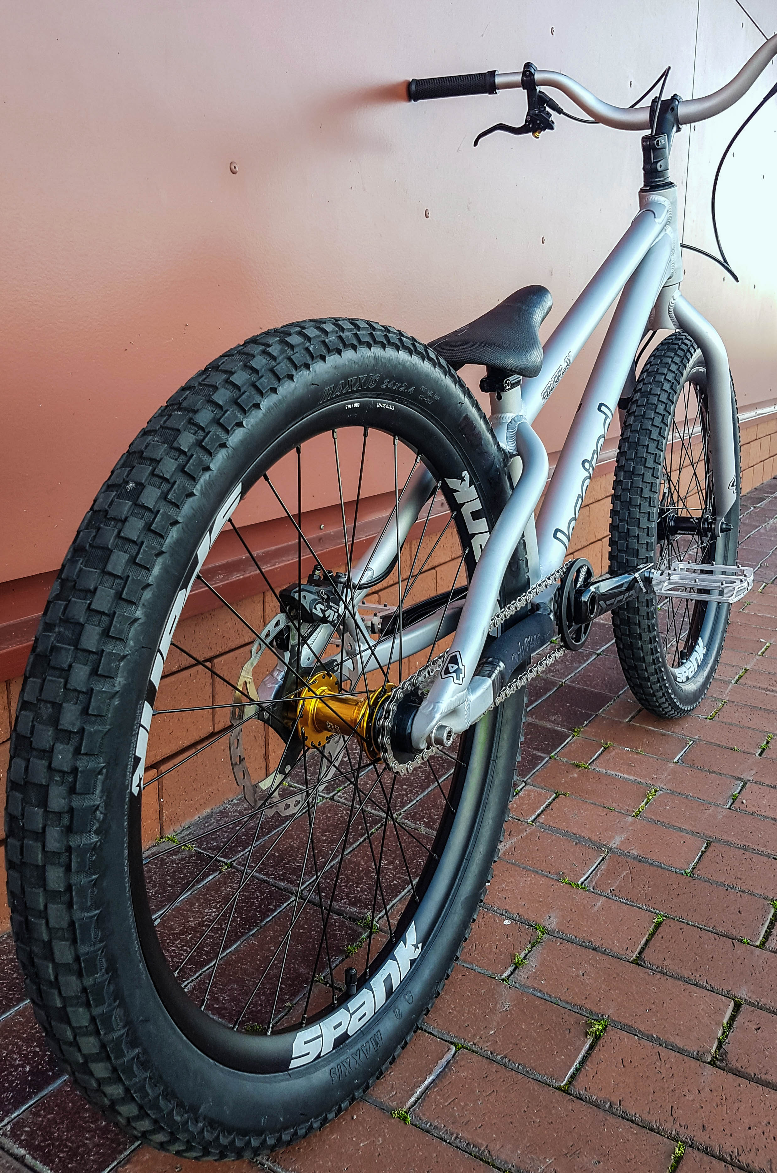

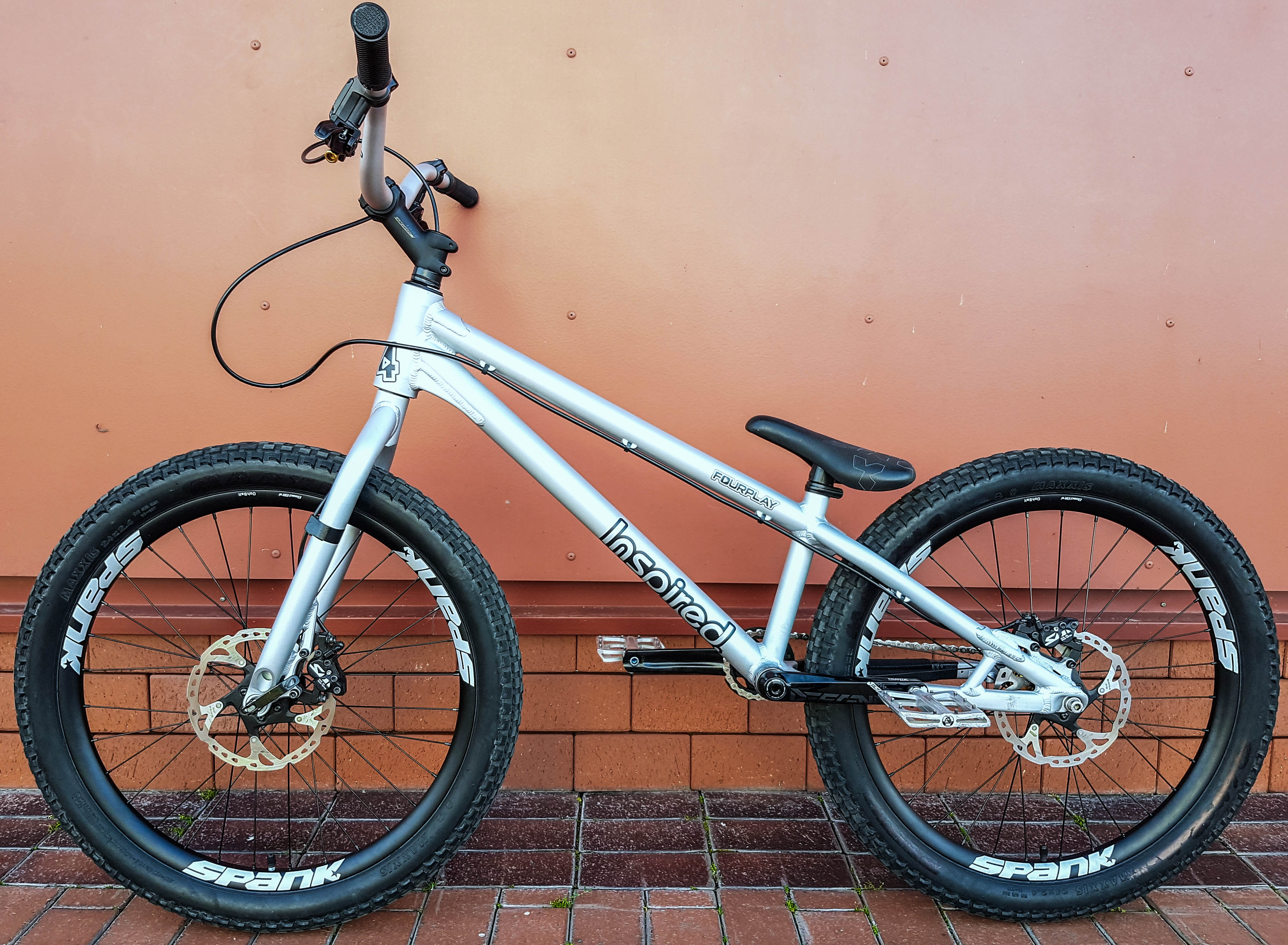

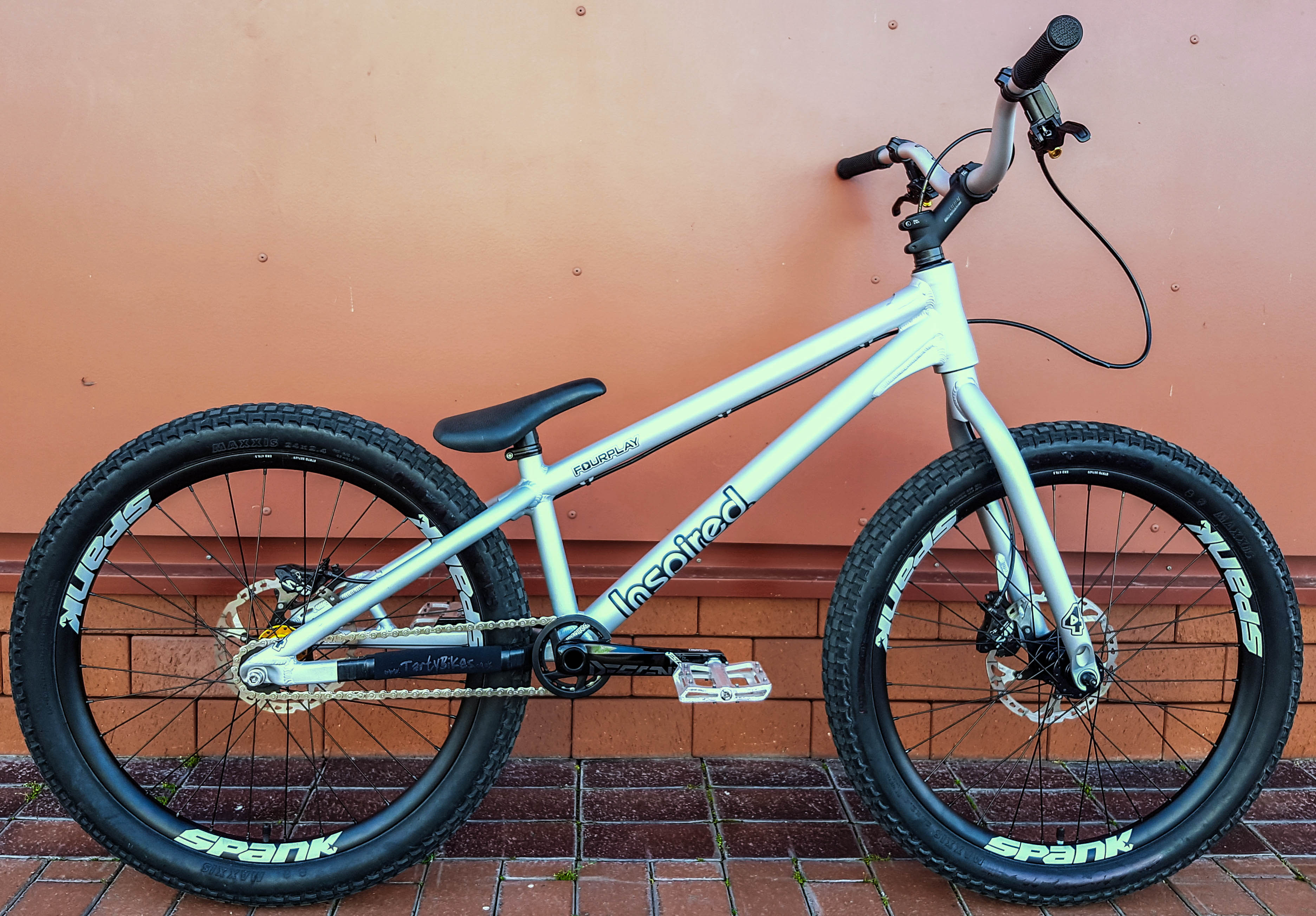

Petras Posted August 3, 2017 Report Share Posted August 3, 2017 (edited) Finally I built it! Really happy with my new bike, everything just works :D. Too bad I couldn't get gold hope front hub because rear hub looks quite good. Specs: Frame and Fork- Frame: Inspired Fourplay 2014 - Forks: Inspired Fourplay 2014 Wheels - Front hub: Hope Pro 4 - Rear hub: Hope Pro 2 Evo Trials - Cassette Lockring: Pro-Bolt Alloy Lockring - Front rim Spank Spike Race 33 - Rear rim: Spank Spike Race 33 - Spokes: Sapim/Halo - Inner tubes: Continental - Tyres: Maxxis Holy Roller Brakes - Front brake: Shimano Saint M810, 180mm - Rear brake: Shimano Saint M810, 180mm Drivetrain - Bottom Bracket: Truvativ GXP Team - Cranks: Truvativ Descendant 170mm - Bashring: Inspired Truvativ Integrated Bashring - Chain: KMC Z610 HX - Rear Sprocket: Trialtech Sport 16T - Pedals: Nukeproof Neutron Seating- Saddle: Dartmoor - Lite Combo - Seat Clamp: Promax Steering - Headset: FSA Orbit Z – Steel - Stem: BBB Forged (90mm, 35°) - Grips: Sixpack Racing M-Trix - Handlebar: Inspired Arcade Riser Geometry- Wheelbase: 1002mm - Chainstay: 370mm - BB Height: +15mm - Head Angle: 73˚ Weight: 10,5 kg / 23.2 lbs Edited October 27, 2017 by Petras 8 Quote Link to comment Share on other sites More sharing options...

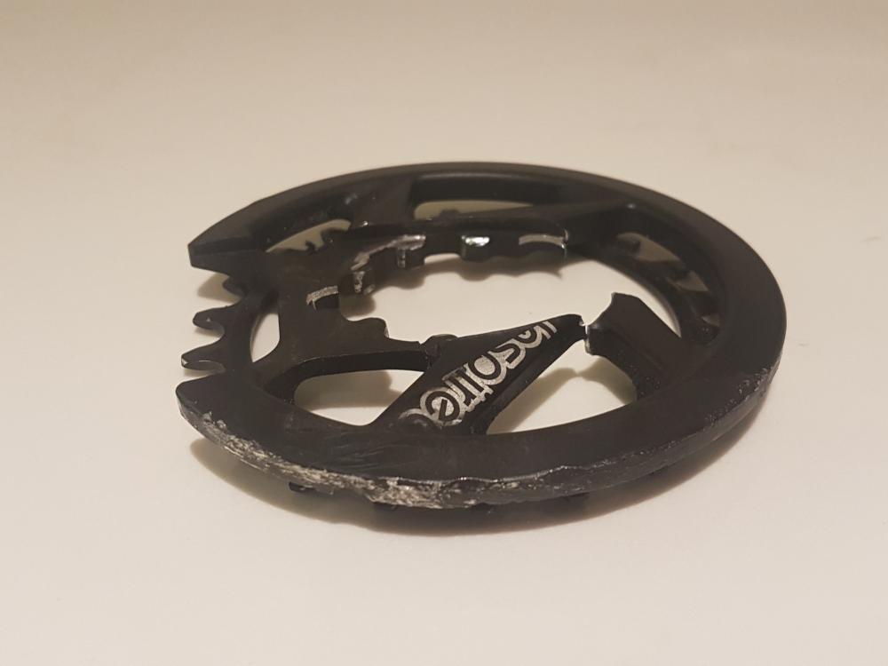

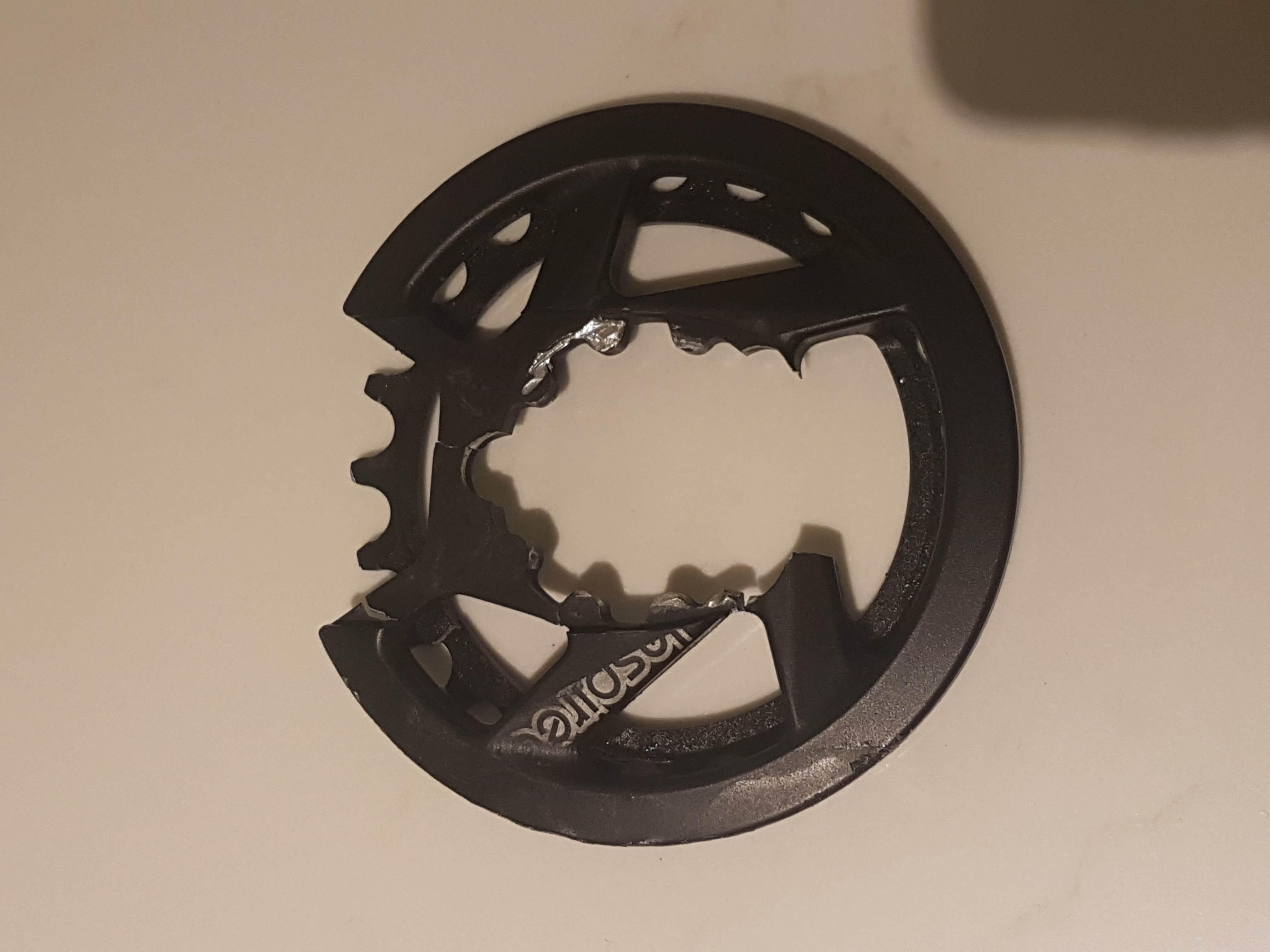

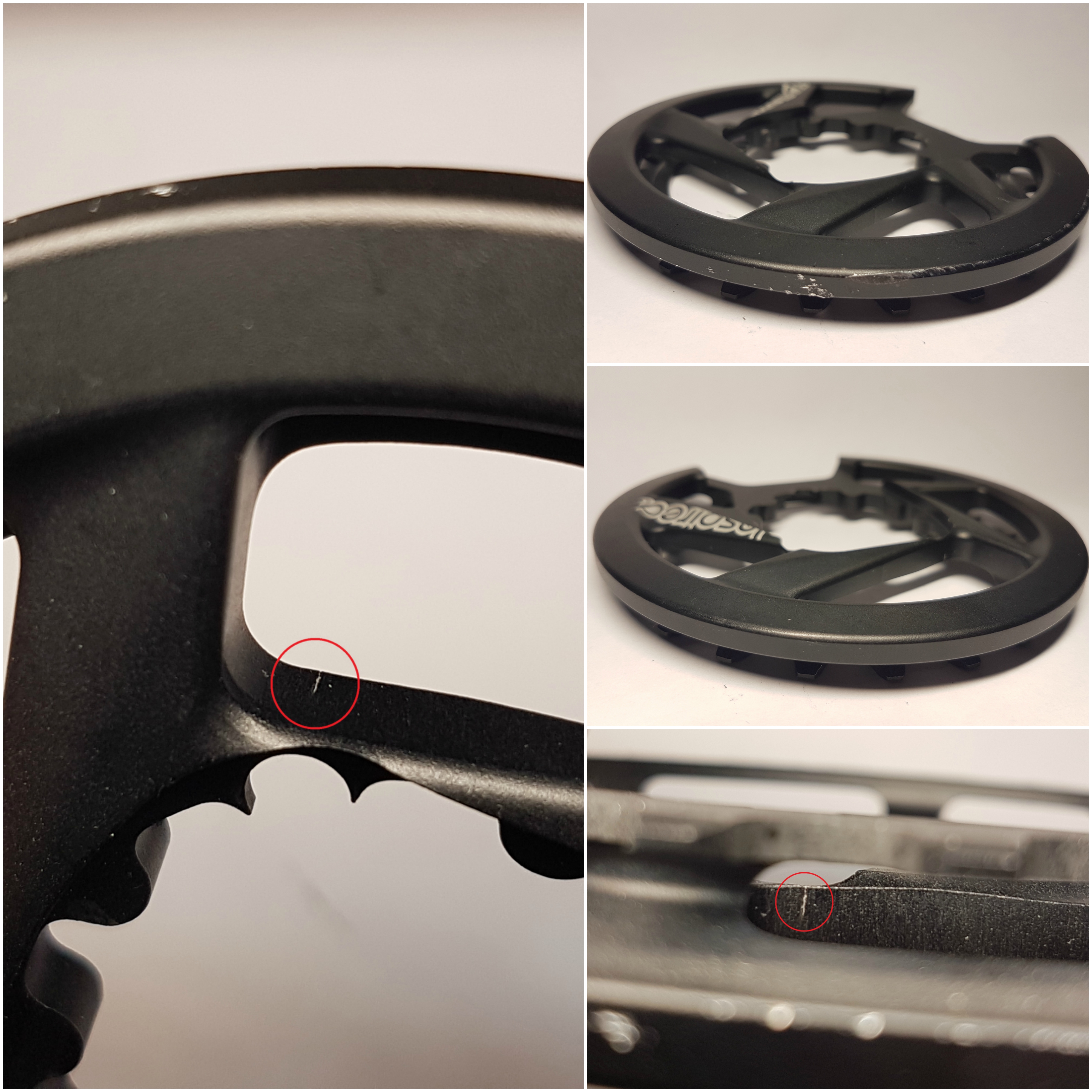

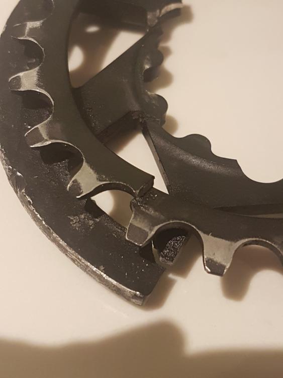

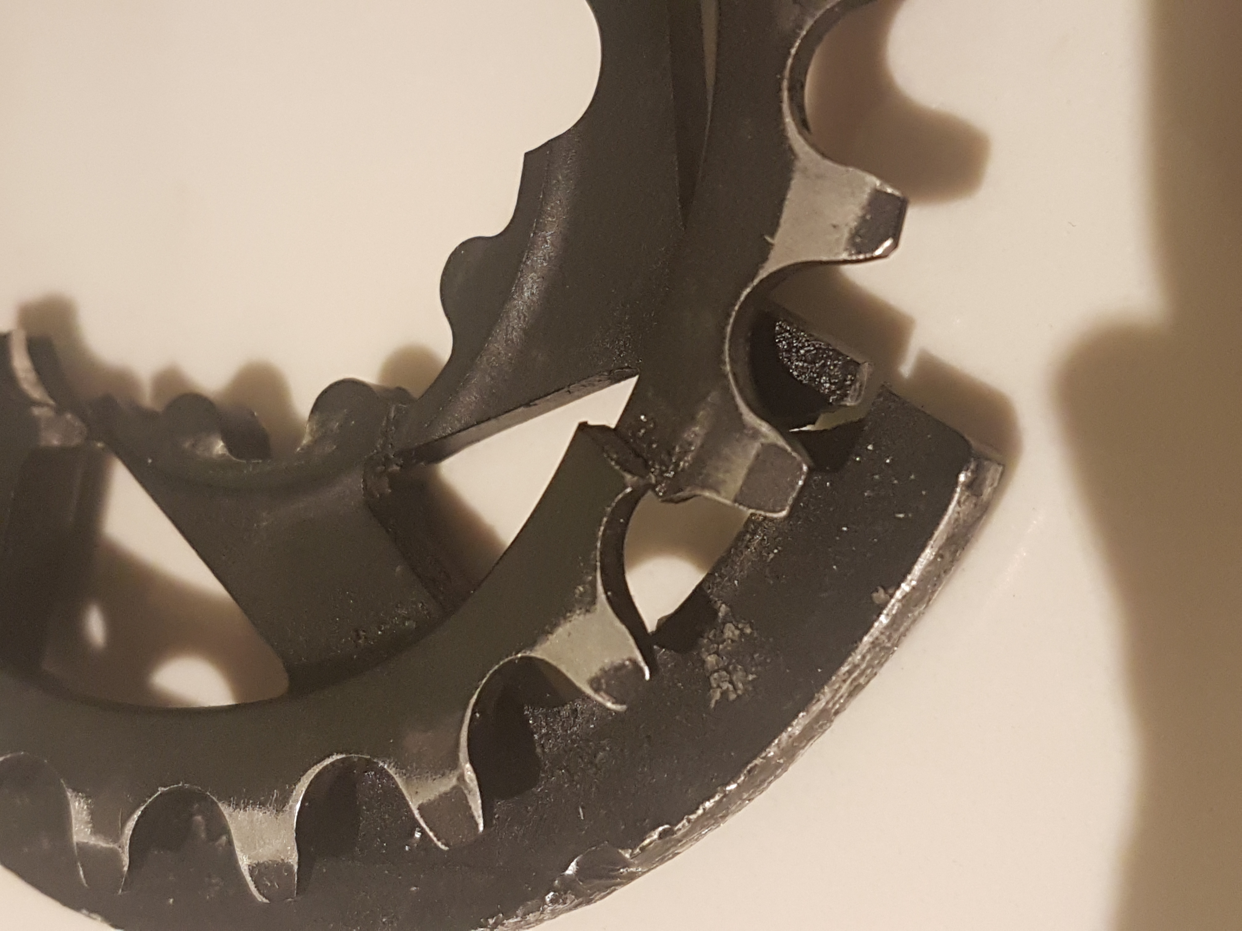

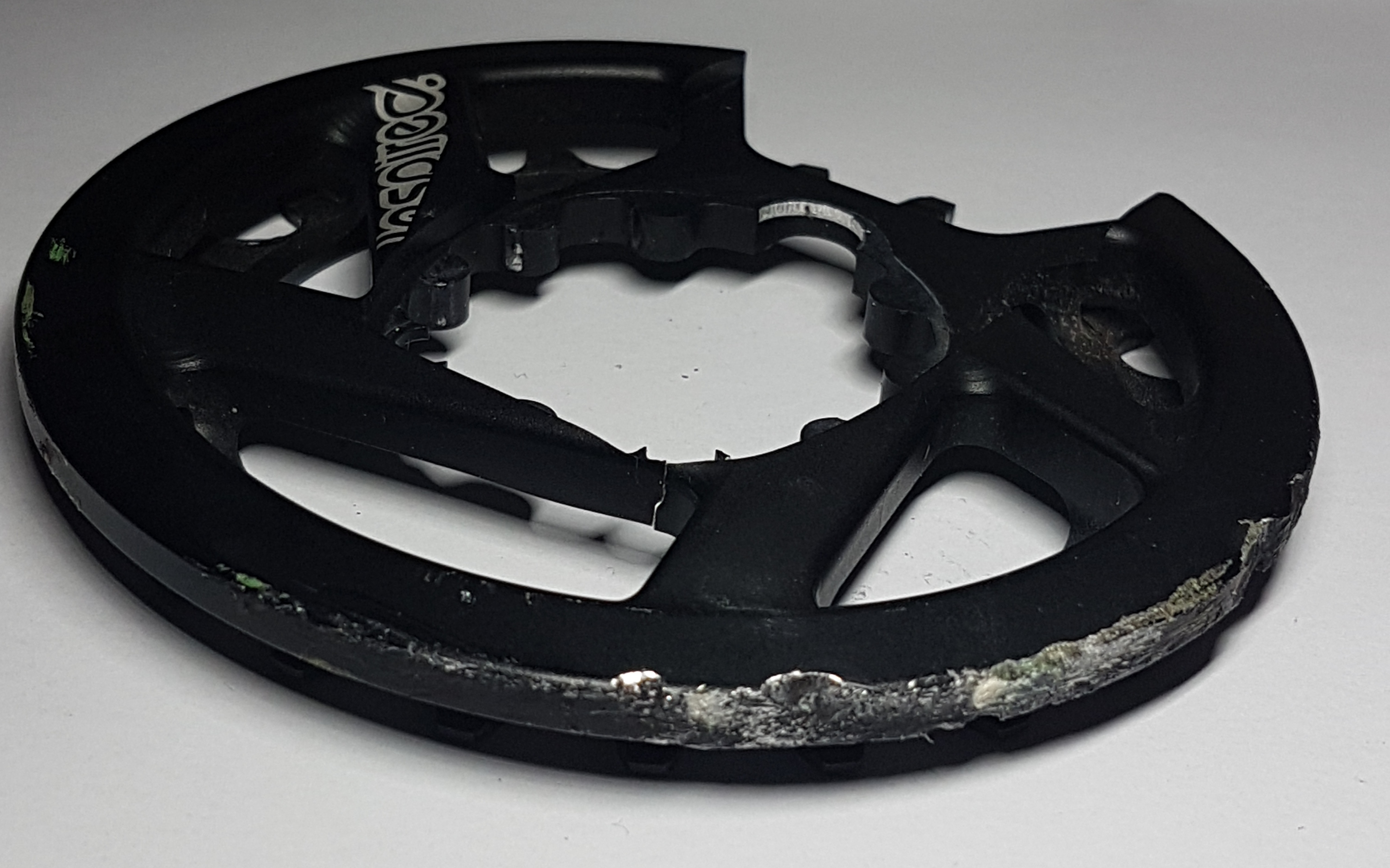

Petras Posted October 18, 2017 Author Report Share Posted October 18, 2017 2 months of riding and it snapped when I did pedal kick 1 Quote Link to comment Share on other sites More sharing options...
Ross McArthur Posted October 19, 2017 Report Share Posted October 19, 2017 Was it a pedal kick off a kerb? Quote Link to comment Share on other sites More sharing options...
Petras Posted October 19, 2017 Author Report Share Posted October 19, 2017 23 minutes ago, Ross McArthur said: Was it a pedal kick off a kerb? something like that 1 Quote Link to comment Share on other sites More sharing options...

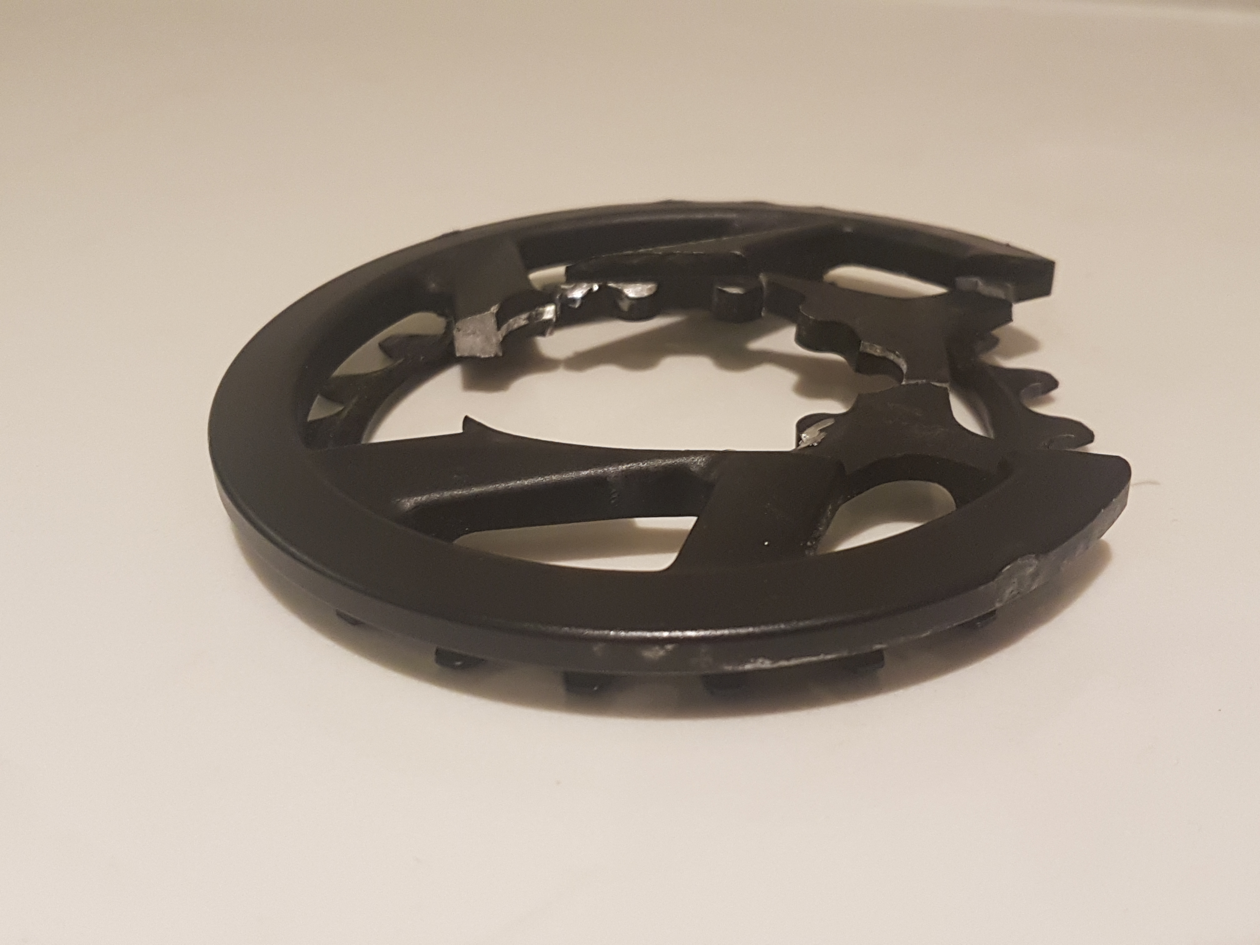

AdamR28 Posted October 20, 2017 Report Share Posted October 20, 2017 I have a feeling it was more to do with ramming it into stuff than the pedal kick Maybe some info about what Inspired have offered to help you out would be a good addition to this thread? 4 Quote Link to comment Share on other sites More sharing options...
Mikee Posted October 20, 2017 Report Share Posted October 20, 2017 I would expect this from a comp bash ring, but not a street one, where things like rails are hit. Shouldn't bash rings be able to take bashes? Or am I old fashioned with my mind set? I've had several bash rings that I have beaten far worse than that, with no problems. There isn't very much material in the area where it has cracked. My unprofessional opinion would be poor design, with Inspired being style/weight conscious to blame. Inspired's Hope bash ring looks far more up to the job of street trials abuse to me. 4 Quote Link to comment Share on other sites More sharing options...
Petras Posted October 20, 2017 Author Report Share Posted October 20, 2017 2 hours ago, Adam@TartyBikes said: I have a feeling it was more to do with ramming it into stuff than the pedal kick Maybe some info about what Inspired have offered to help you out would be a good addition to this thread? Adam, probably I broke it when rammed and it completely broke after pedal kick :). Quote Link to comment Share on other sites More sharing options...
Petras Posted October 20, 2017 Author Report Share Posted October 20, 2017 Inspired wrote me: "Regarding the design of the bashring - the bashring is relatively thin at those points to maximise compatibility, but we tested them extensively pre-release with a variety of our team riders and only experienced one failure (which was Ali Clarkson whilst trying to learn crankslides). Since their release, the number of failures has also been minimal compared to the number sold. Ultimately, bashrings are designed to be a sacrificial part and consequently can be subject to a wide variety of impacts. As mentioned before, only a very small percentage of the number of bashrings sold have broken, so it seems you may have been unlucky with some of the impacts your bashring has received (we noticed in the photos that it appears to have taken some big impacts from the deformation on the outer edge)." Quote Link to comment Share on other sites More sharing options...
Mikee Posted October 20, 2017 Report Share Posted October 20, 2017 Looking back at it, I think the Truvativ direct mount design played a part. It looks a bit weak for trials use, compared to the Middleburn / Hope style spline and lockring. 1 Quote Link to comment Share on other sites More sharing options...

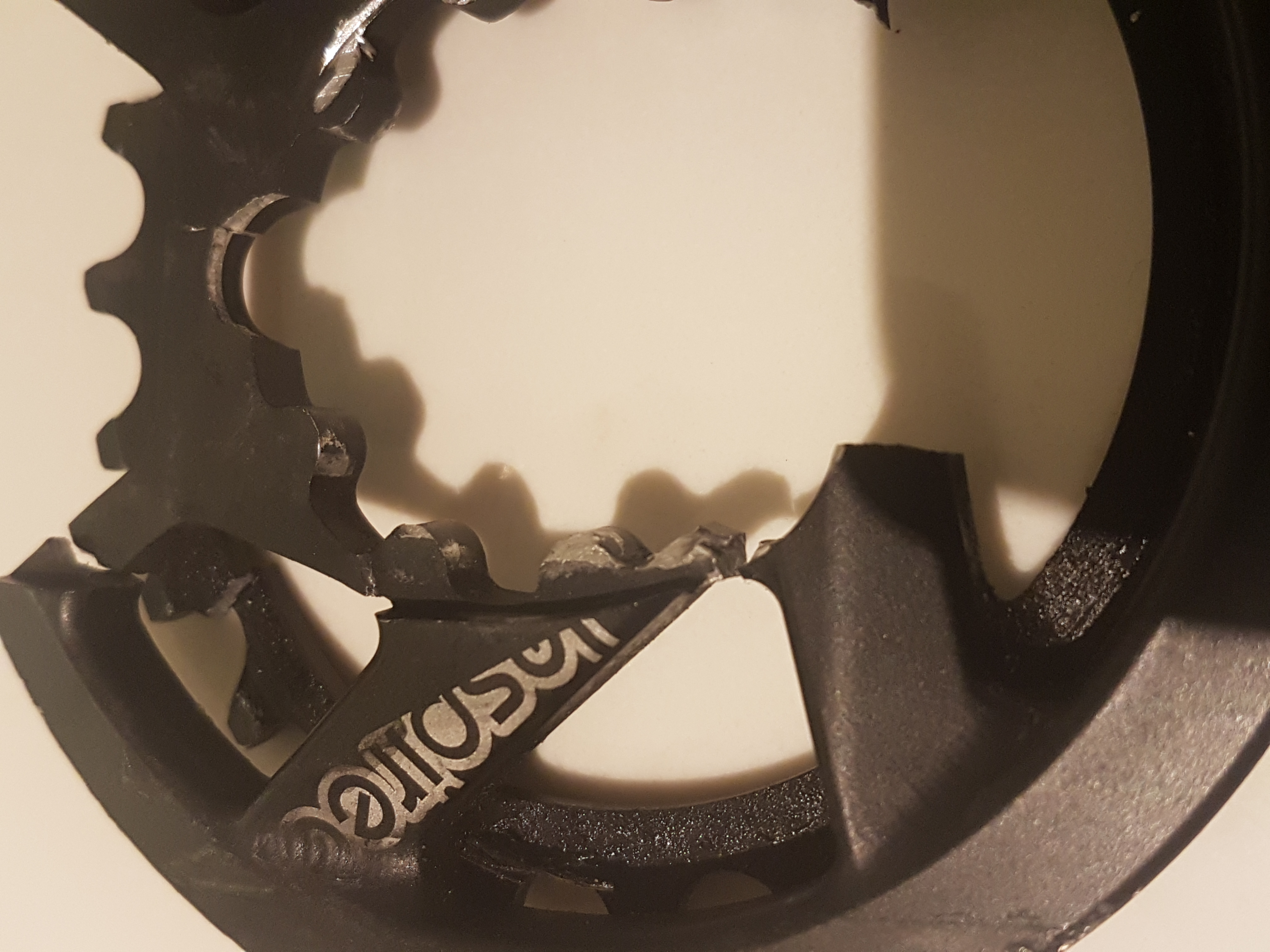

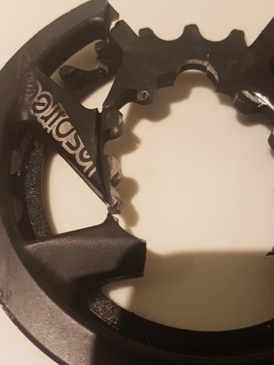

stigofthedump Posted October 21, 2017 Report Share Posted October 21, 2017 Funny, my sons has just broken today. Looks very similar! Admittedly it has been bashed (not as bad as the one in your pictures), however, is that not the whole point of a ‘bash ring’? his is also 2 months old! Quote Link to comment Share on other sites More sharing options...
Petras Posted October 21, 2017 Author Report Share Posted October 21, 2017 (edited) 2 hours ago, stigofthedump said: Funny, my sons has just broken today. Looks very similar! Admittedly it has been bashed (not as bad as the one in your pictures), however, is that not the whole point of a ‘bash ring’? his is also 2 months old! I think we gonna need thread soon just for broken bashrings . Would be interesting to see how your sons bashring looks like. I guess we are just unlucky . Edited October 21, 2017 by Petras Quote Link to comment Share on other sites More sharing options...

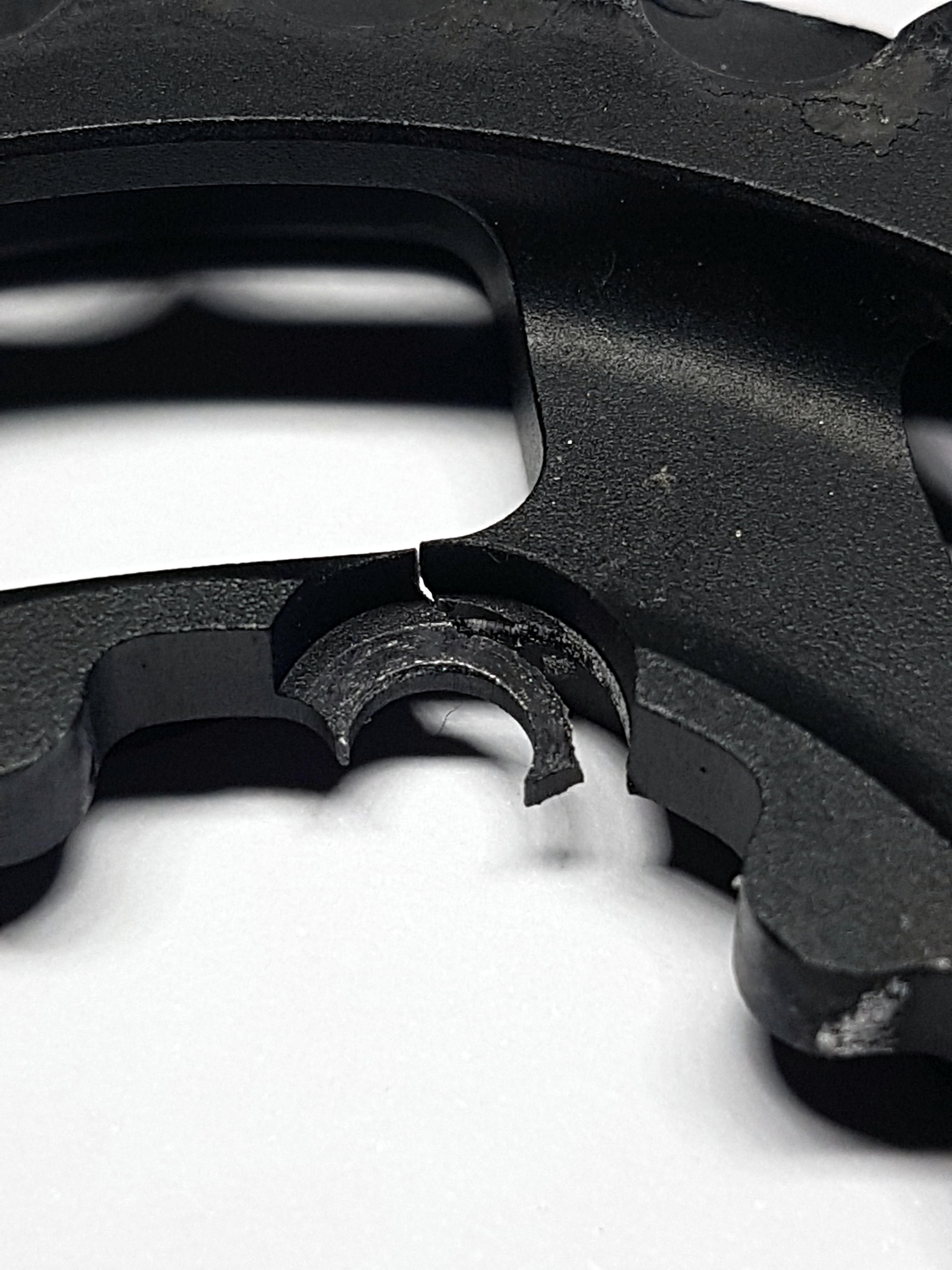

stigofthedump Posted October 21, 2017 Report Share Posted October 21, 2017 Here’s what it looks like..... however, it’s also worth noting that this actually happened when he was doing a 180 and pulled out half way through, so lander at 90. Didn’t hit anything. Obviously don’t know how weak it was before etc, and it has been hit on several occasions. What I would say is that he’s only 14, so the forces wouldn’t be anything like if I was riding it. Also, never had any problem with his old bike (inspired flow Plus). 1 Quote Link to comment Share on other sites More sharing options...

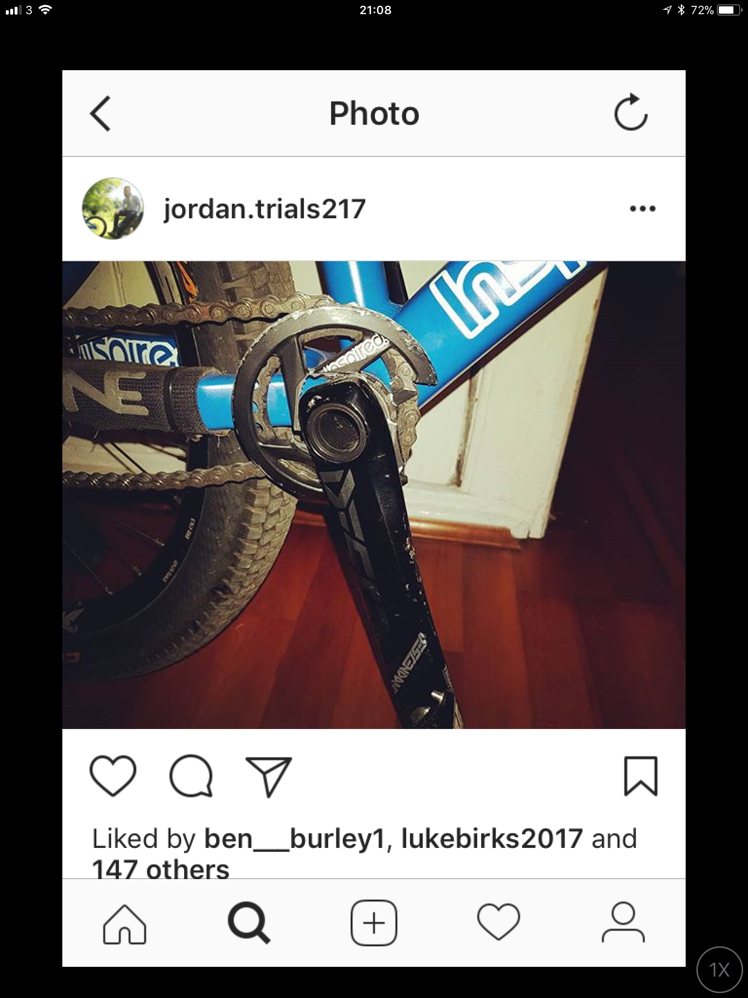

stigofthedump Posted October 22, 2017 Report Share Posted October 22, 2017 Also, saw this on Instagram......... Quote Link to comment Share on other sites More sharing options...
LEON Posted October 24, 2017 Report Share Posted October 24, 2017 (edited) That inner mount bit is too thin to be trials proof. It wouldn't take a tank or a basher to break that. Also surely the arms pointing straight out from the centre would be much stronger than having them like that, leant over like a disc rotor, sort of pre - collapsed. Edited October 24, 2017 by LEON 3 Quote Link to comment Share on other sites More sharing options...

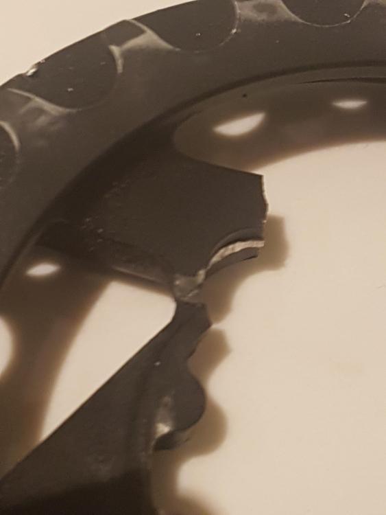

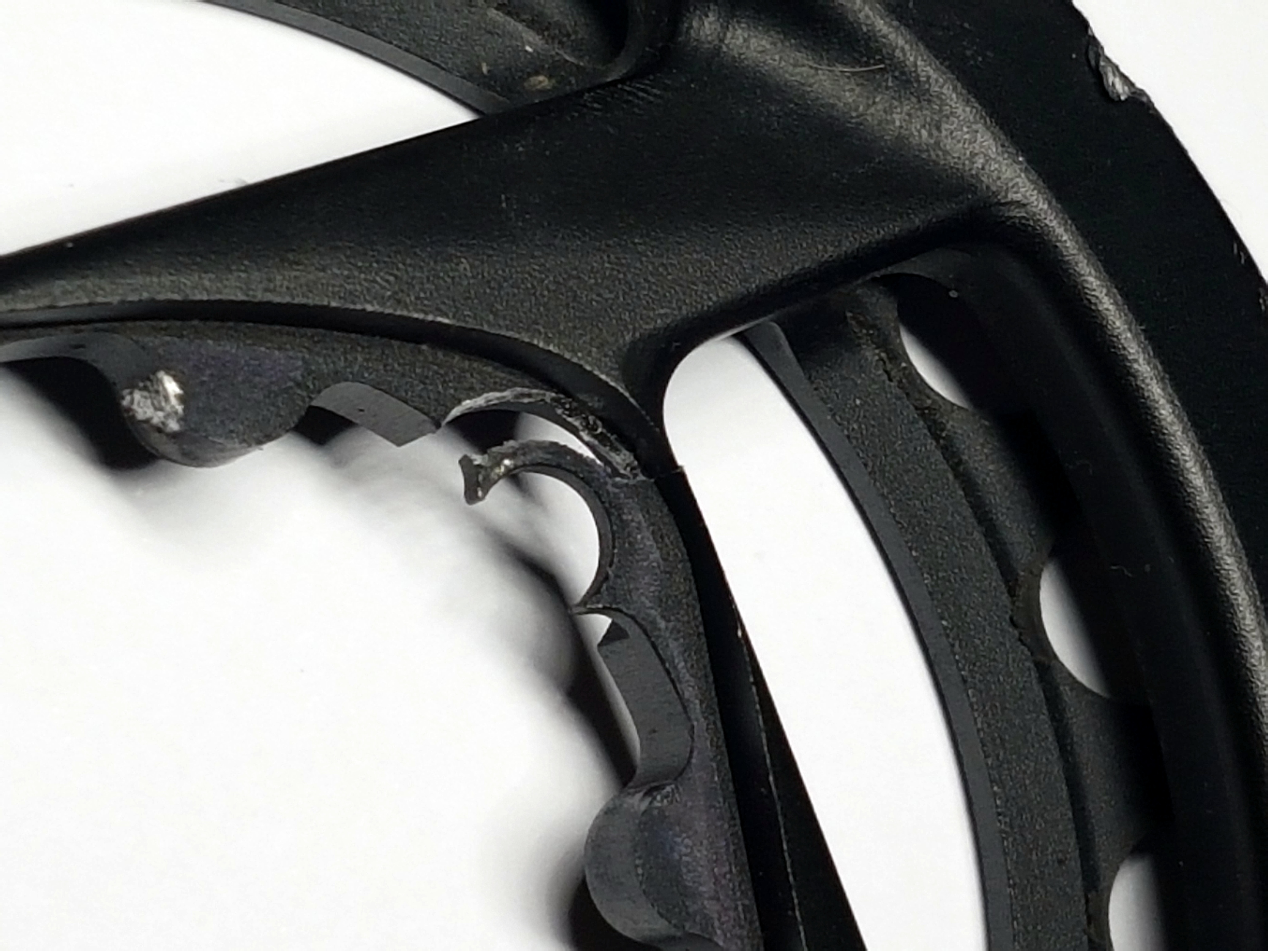

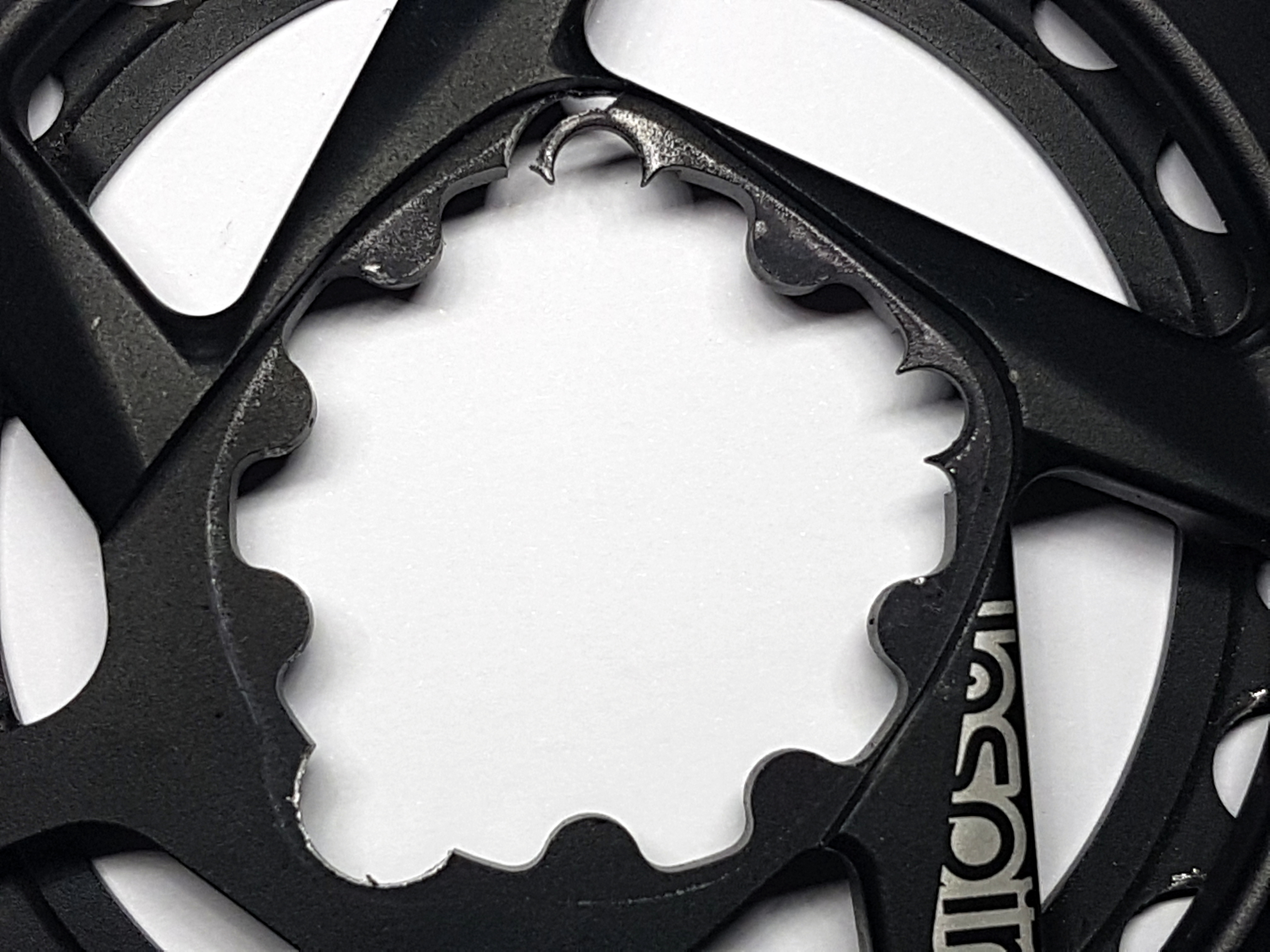

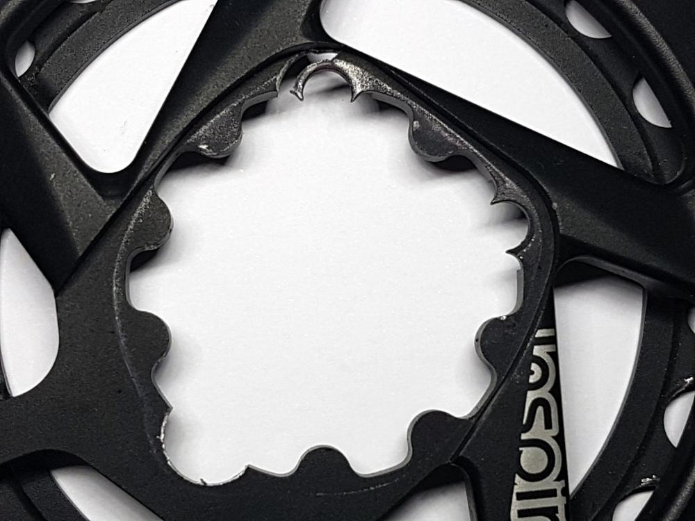

Petras Posted November 23, 2017 Author Report Share Posted November 23, 2017 Well, pictures speak for themselves. 4 rides literally. 2 Quote Link to comment Share on other sites More sharing options...
grenosteve Posted November 23, 2017 Report Share Posted November 23, 2017 Be interesting to see what Inspired say about it this time. Quote Link to comment Share on other sites More sharing options...
Felix_HBtrials Posted November 24, 2017 Report Share Posted November 24, 2017 Wow! These bash are really problematic Quote Link to comment Share on other sites More sharing options...
LEON Posted December 27, 2017 Report Share Posted December 27, 2017 I think they really are just to shield the chain a couple of times, not actually take impacts, is that a revised version? Quote Link to comment Share on other sites More sharing options...
Petras Posted December 28, 2017 Author Report Share Posted December 28, 2017 9 hours ago, LEON said: I think they really are just to shield the chain a couple of times, not actually take impacts, is that a revised version? They do not have updated version of it yet. I noticed that Truvativ chainring have less movement when I put it on the same descendant cranks and inspired chainring has a slight movement on cranks BEFORE screwing on bolts. Bolts do hold chainring in place but hard pedal kick on landing backwards moves it a bit and I suppose thats a major problem. I broke it 2 times on the place, that means something for sure. Well, anyway thats just my opinion Quote Link to comment Share on other sites More sharing options...
