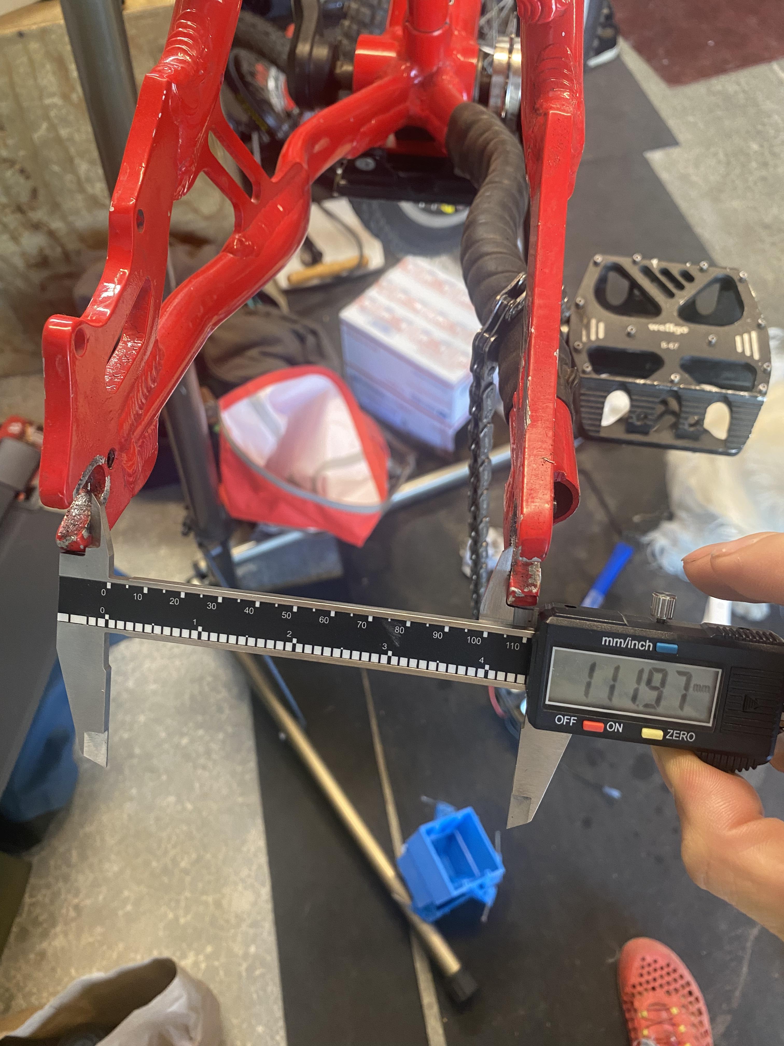

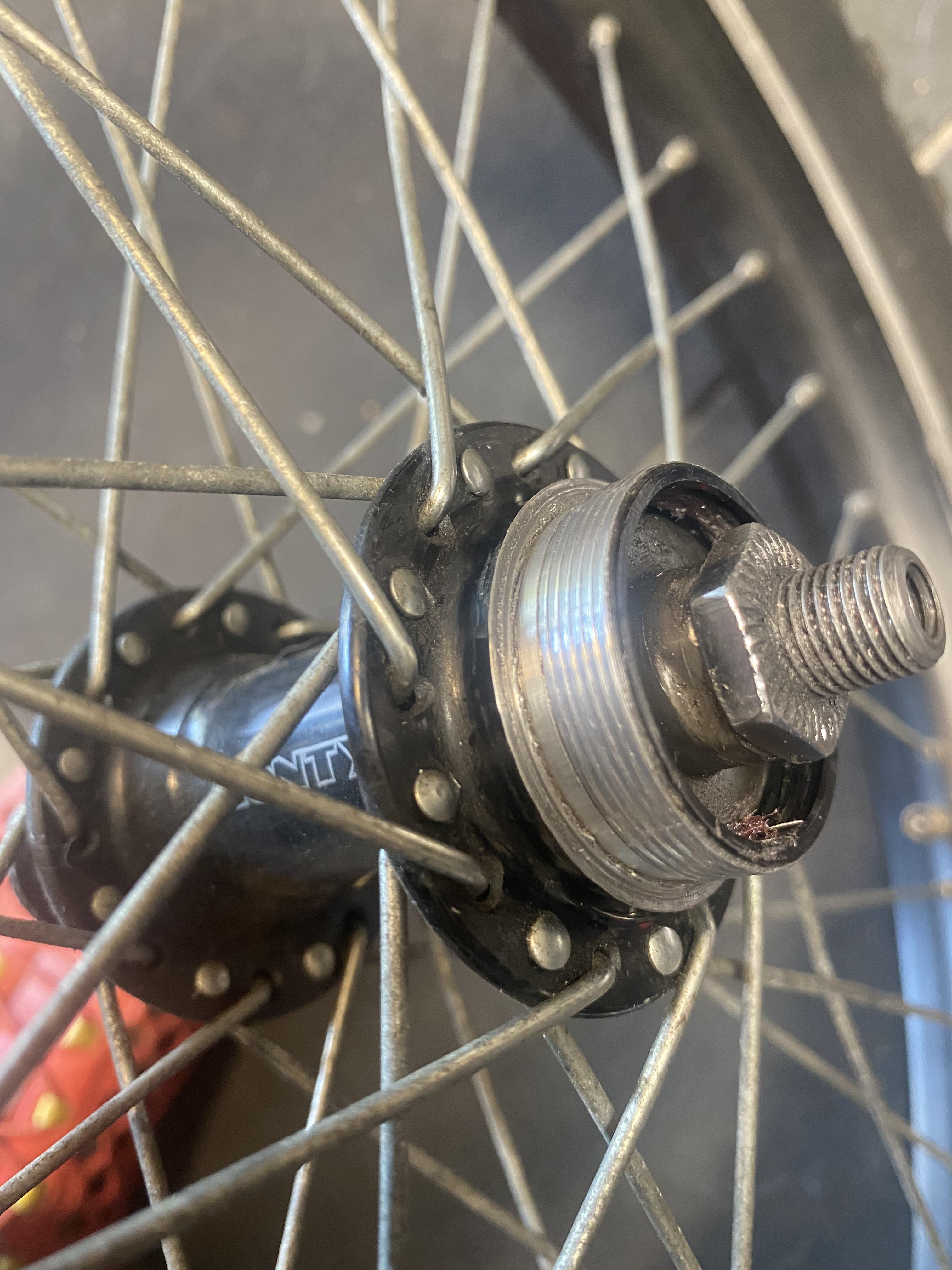

  On 10/3/2022 at 10:27 PM, pzexperience said:
Nice work!
i need a new rear hub for mine. What do you recommend?
Expand
You'll need to check the number of spokes in your current back wheel to see whether it's going to be easier to buy a new wheel or a new hub. Some Monty bikes used 36h rear wheels - if yours has a 36h wheel then getting just a replacement hub will be difficult as not many brands use that drilling any more.
If it's 32h, and if you're using a rim brake and don't plan on using a disc brake in future, the Trialtech Race Sealed rear hub would be a good shout: https://www.tartybikes.co.uk/116mm_fixed_hubs/trialtech_race_sealed_rear_hub/c62p11422.html
Good quality, sealed bearing, not too heavy, should fit that frame fine.
You'll also need new spokes and it would probably be worth getting a new sprocket at the same time to be on the safe side.
