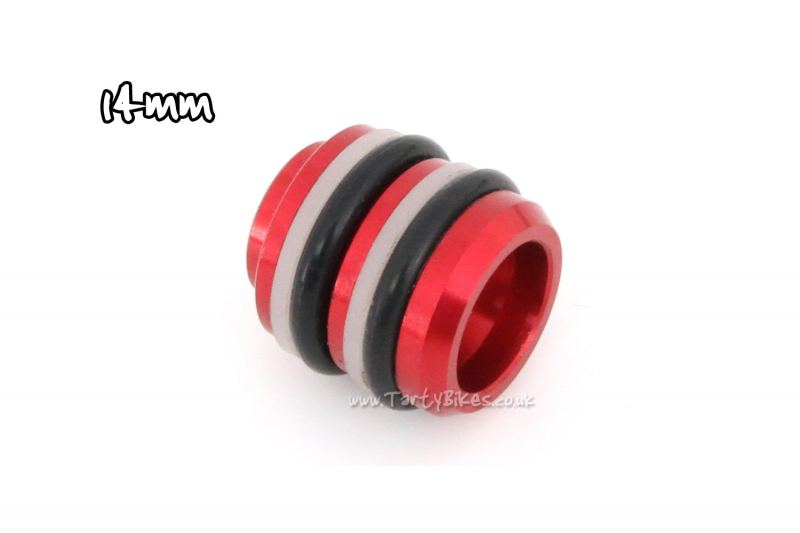

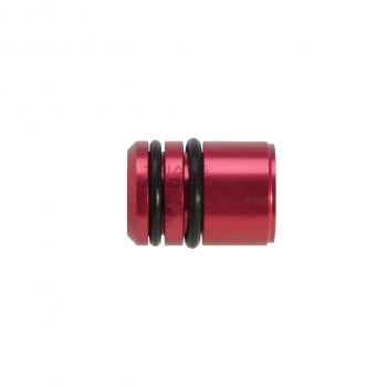

Ross McArthur Posted June 26, 2017 Report Share Posted June 26, 2017 So the older piston is longer, fits the magura spring and has two O rings. The new piston is shorter, two O rings and what looks like a separate set of wipers. Are there any advantages to be had with the shorter piston? Would more fluid be in the brake with the shorter version? Minimal amounts I'm sure.. Anyone had any experience with both to compare? Quote Link to comment Share on other sites More sharing options...
niconj Posted June 26, 2017 Report Share Posted June 26, 2017 I noticed no difference between the two. Quote Link to comment Share on other sites More sharing options...
Mikee Posted June 26, 2017 Report Share Posted June 26, 2017 I had one of those, I think it was the older one. I had problems with slow return speeds, which I couldn't seem to get rid of no matter what it tried. So I stopped using it after about a month. Quote Link to comment Share on other sites More sharing options...
Alex Dark Posted June 26, 2017 Report Share Posted June 26, 2017 The newer one looks to have wear rings or backup rings installed . The former will help support the piston and prevent scoring against the bore ; the latter will allow the o ring to tolerate higher pressures without extruding / deforming ( not needed due to the low pressures involved ) Quote Link to comment Share on other sites More sharing options...
LEON Posted June 27, 2017 Report Share Posted June 27, 2017 I think I've got one of each, all I know is they've saved old worn levers that I couldn't get to work properly with standard pistons. 2 Quote Link to comment Share on other sites More sharing options...
trialsinfrank Posted July 3, 2017 Report Share Posted July 3, 2017 The old one worked and new one was shit for 2 riders here in magura 05. Clean spring makes a nice difference too. Quote Link to comment Share on other sites More sharing options...
