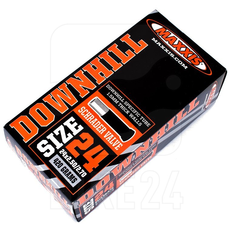

Daviesdt Posted May 29, 2017 Author Report Share Posted May 29, 2017 Downhill tubes at 24 inch? Quote Link to comment Share on other sites More sharing options...
Dman Posted May 29, 2017 Report Share Posted May 29, 2017 @Paperclip are yours p lyte or k lyte? It seems they only do k lyte now. The conti are miles better than holy roller and sidewall is a lot thicker. But don't get them thinking it will stop punctures it won't, it's more technique as well as the right pressures. I'm saying 45-50psi. I think kenda do a downhill 24. 1 Quote Link to comment Share on other sites More sharing options...

Topsy Posted May 29, 2017 Report Share Posted May 29, 2017 (edited) I once had a downhill 24" tube that I got for free in the back tyre a few years ago, was heavy as f**k, weighted about half a kilo. Actually wanted to pinch it but gave up after a year and put it on a shelf.. Only ever ran Holy Rollers though, used to get lots of punctures in the first few years, not many lately (touch wood)*. I guess they teach you to be smooth. I do consider changing to the Contis sometime when I've got no more rubber left on these.. *bet I'll get one this week? Edited May 29, 2017 by Topsy Quote Link to comment Share on other sites More sharing options...

Daviesdt Posted May 30, 2017 Author Report Share Posted May 30, 2017 Are the continental heavy? Looking at the tubes Dman posted above and what topsy says above, downhill tubes are just under 0.5 kilo a tube (how thick are those things!? I bet I could ride them without a tyre!) If the continental were say 0.5 kilo a tyre I'd really be starting to jack up the weight of the bike. I may try new tyres first then change tubes if still getting punctures. Still not sure on the continental tyres yet, want to see if I can find any Odyssey tyres and compare the two before buying..... Quote Link to comment Share on other sites More sharing options...

Dman Posted May 30, 2017 Report Share Posted May 30, 2017 2 hours ago, Daviesdt said: Are the continental heavy? Looking at the tubes Dman posted above and what topsy says above, downhill tubes are just under 0.5 kilo a tube (how thick are those things!? I bet I could ride them without a tyre!) If the continental were say 0.5 kilo a tyre I'd really be starting to jack up the weight of the bike. I may try new tyres first then change tubes if still getting punctures. Still not sure on the continental tyres yet, want to see if I can find any Odyssey tyres and compare the two before buying..... They are around 800grams a tyre Quote Link to comment Share on other sites More sharing options...
