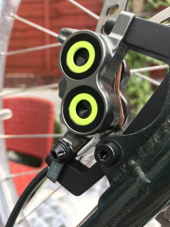

Oak T Posted July 30, 2017 Author Report Share Posted July 30, 2017 It seems I may have some leakage left the bike for a week or two, went for a short ride and found my lever keep pulling back further and further. Bleed bolt is rather tight not sure where it even came from! has anyone else had this issue before? In the picture I did wipe some of the oil off with my finger to see if it was oil. cheers Oak Quote Link to comment Share on other sites More sharing options...
niconj Posted July 30, 2017 Report Share Posted July 30, 2017 1 hour ago, Oak T said: It seems I may have some leakage left the bike for a week or two, went for a short ride and found my lever keep pulling back further and further. Bleed bolt is rather tight not sure where it even came from! has anyone else had this issue before? In the picture I did wipe some of the oil off with my finger to see if it was oil. cheers Oak Check the banjo bolt. Mine leaked there. Quote Link to comment Share on other sites More sharing options...
Oak T Posted July 30, 2017 Author Report Share Posted July 30, 2017 4 hours ago, niconj said: Check the banjo bolt. Mine leaked there. Banjo and around it is completely dry! The only ting I can thing of it the bleed bolt but that rather tight too Quote Link to comment Share on other sites More sharing options...
niconj Posted July 31, 2017 Report Share Posted July 31, 2017 16 hours ago, Oak T said: Banjo and around it is completely dry! The only ting I can thing of it the bleed bolt but that rather tight too I don't remember the bleed bolt having a washer underneath it. Quote Link to comment Share on other sites More sharing options...
Oak T Posted July 31, 2017 Author Report Share Posted July 31, 2017 (edited) 5 hours ago, niconj said: I don't remember the bleed bolt having a washer underneath it. Thats not a spacer thats the bolt it self! I've cleaned the caliper and every so often I'll go to have a look and theres still a little bit of oil leaking out of it. On the caliper under the bleed bolt its slightly raised so it may look like a spacer but it's not Edited July 31, 2017 by Oak T Quote Link to comment Share on other sites More sharing options...
niconj Posted August 1, 2017 Report Share Posted August 1, 2017 14 hours ago, Oak T said: Thats not a spacer thats the bolt it self! I've cleaned the caliper and every so often I'll go to have a look and theres still a little bit of oil leaking out of it. On the caliper under the bleed bolt its slightly raised so it may look like a spacer but it's not Ok. I've only had the black ones so it looked weird to me. Just return your brake and get a new one. Pain in the ass but nothing you can do really. Although... On my Magura HS33 piston I used insulation tape on the bolt and it does leaking. Worth a shot I think. Quote Link to comment Share on other sites More sharing options...
