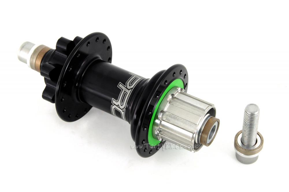

Jack Heard Posted April 1, 2017 Report Share Posted April 1, 2017 Got a pro4 rear trials ss hub through work. When it's come the hub isn't "bolt in" which is what I need for my arcade. It's a 10mm through axle. I know you can convert hope hubs. But is it possible to convert it from a through axle to a bolt in? Looked from top to bottom online and can't find anything useful Quote Link to comment Share on other sites More sharing options...
John Shrewsbury Posted April 2, 2017 Report Share Posted April 2, 2017 Normally for a trials specific hope hub it comes like this. You sure its not the Hope pro 4 MTB with a long freewheel? 1 Quote Link to comment Share on other sites More sharing options...
niconj Posted April 2, 2017 Report Share Posted April 2, 2017 There is a through bolt version of the SSP hub too. 1 Quote Link to comment Share on other sites More sharing options...
Herbertlemon102 Posted April 2, 2017 Report Share Posted April 2, 2017 4 hours ago, John Shrewsbury said: Normally for a trials specific hope hub it comes like this. You sure its not the Hope pro 4 MTB with a long freewheel? there is a bolt through for the skyes and crewkerz bikes too if i remember correctly. no idea if they can be converted... 1 Quote Link to comment Share on other sites More sharing options...
John Shrewsbury Posted April 2, 2017 Report Share Posted April 2, 2017 4 hours ago, niconj said: There is a through bolt version of the SSP hub too. 27 minutes ago, Herbertlemon102 said: there is a bolt through for the skyes and crewkerz bikes too if i remember correctly. no idea if they can be converted... The main thing is, normally it would come as standard with bolts. Possibly a mix up and just ordered the wrong one. Send it back and have it changed if your bike shop did the order. 1 Quote Link to comment Share on other sites More sharing options...
Mark W Posted April 2, 2017 Report Share Posted April 2, 2017 They can be converted - you'd just need the Pro 4 Trials axle, and a pair of bolts/washers. All are available through Hope. As John said, worth checking out whether it's definitely a Trials/SS hub. It'll be laser etched on the shell. 1 Quote Link to comment Share on other sites More sharing options...
Jack Heard Posted April 2, 2017 Author Report Share Posted April 2, 2017 Thank so guys it's 100% trials ss. It does say it on the shell. It's the through axle one. As long as it can be converted i don't have a problem. 6 minutes ago, Mark W said: They can be converted - you'd just need the Pro 4 Trials axle, and a pair of bolts/washers. All are available through Hope. Will a pro2 evo "bolt in" conversion work? Thanks again Quote Link to comment Share on other sites More sharing options...
Mark W Posted April 2, 2017 Report Share Posted April 2, 2017 No, it has to be the Pro 4. The Pro 4's got a different bearing setup so it's 17mm diameter at the freehub body too, whereas the Pro 2 Evo is 15mm. Quote Link to comment Share on other sites More sharing options...
