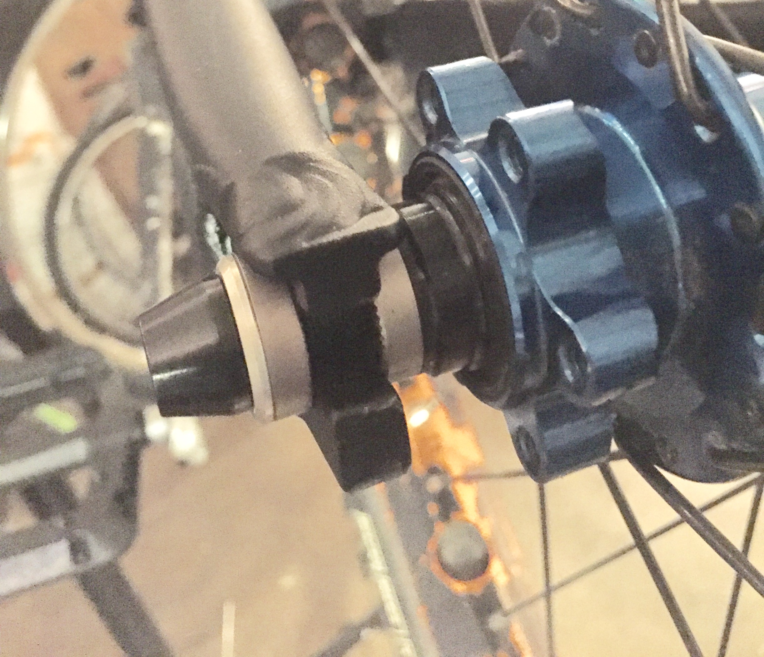

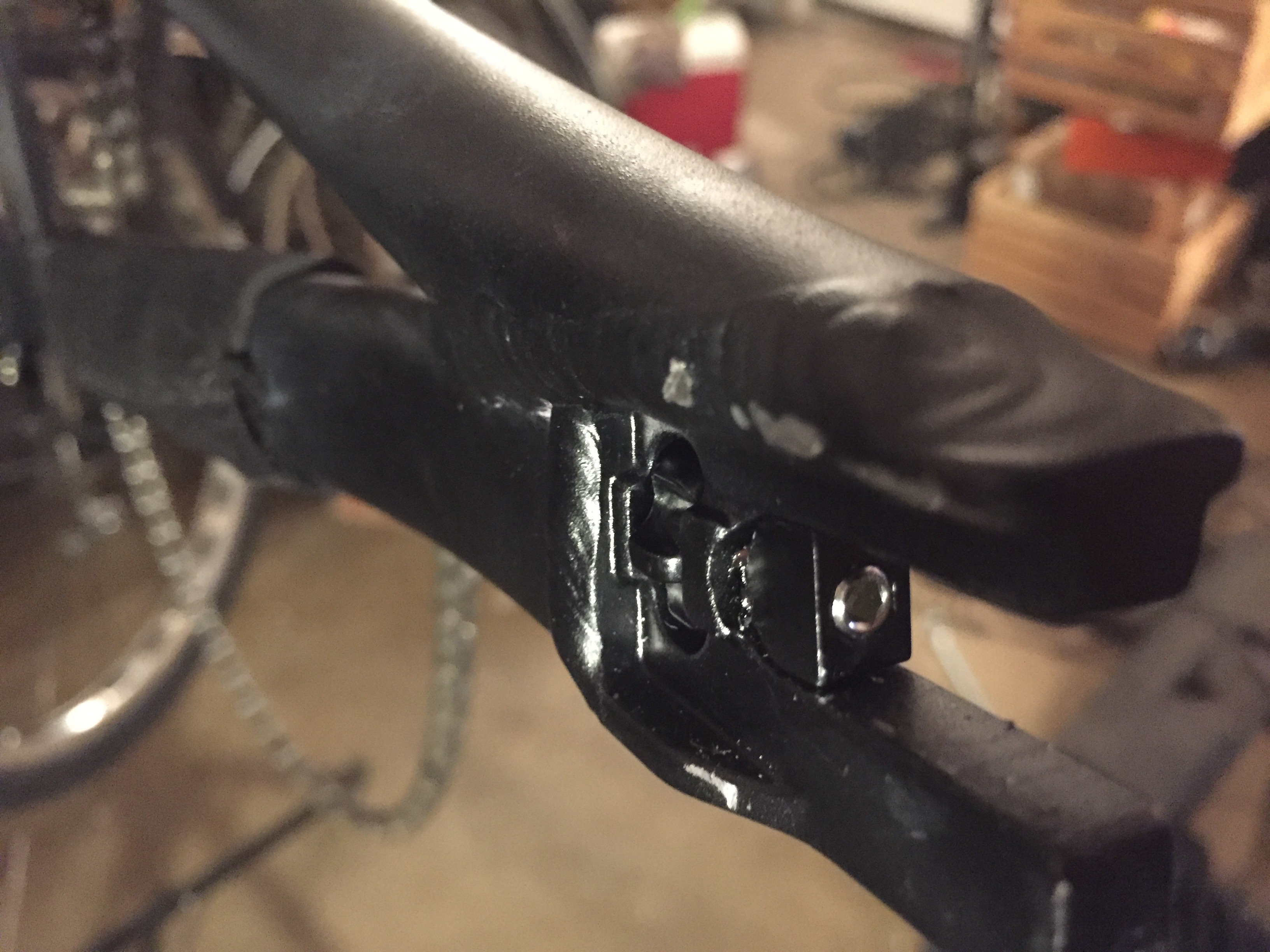

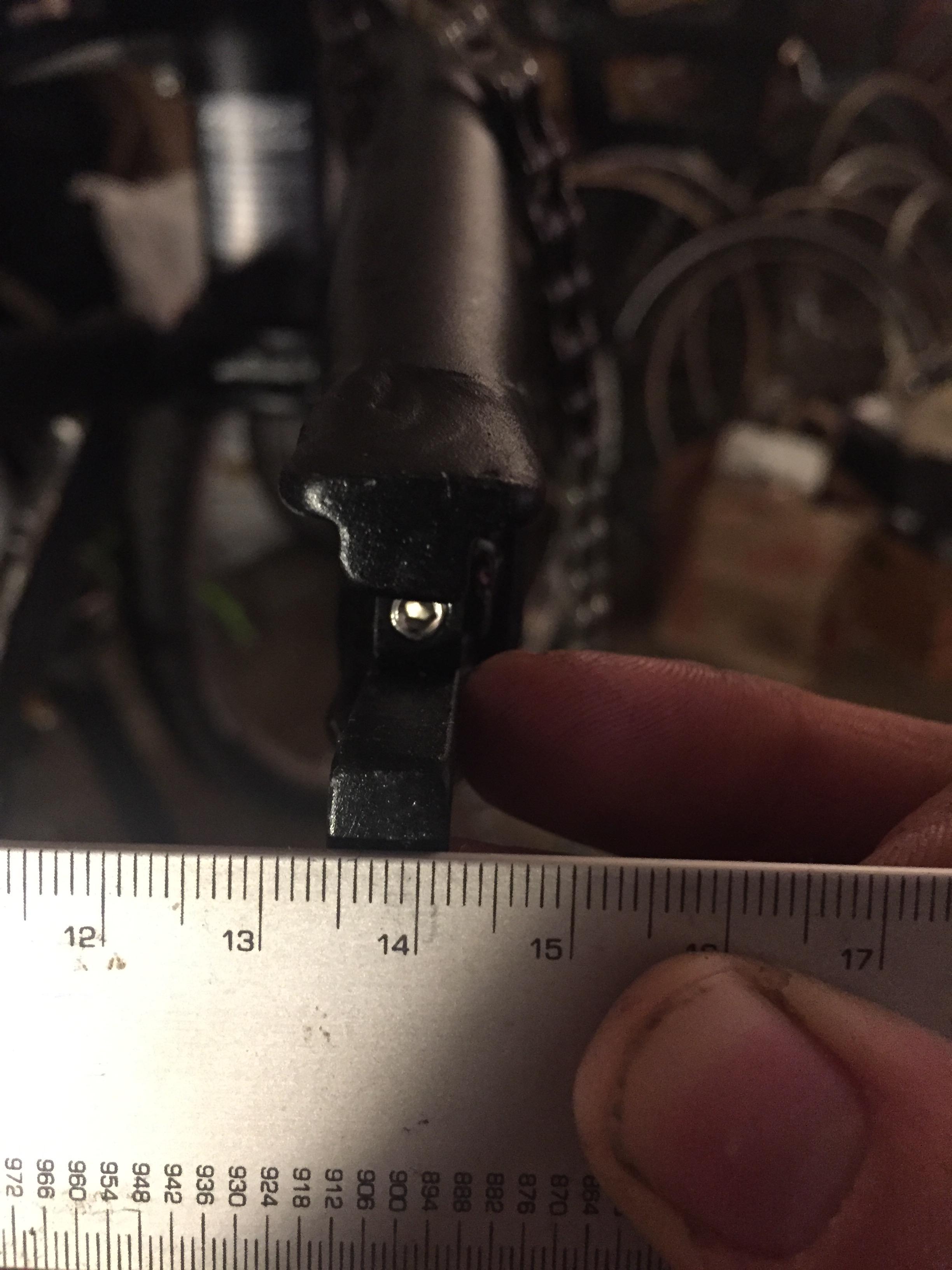

I've got my first new non inspired trials frame in over 10 years, and like usual in running into problems.  I'm trying to fit  a pro 2 hub in this inpulse blast x, the dropouts measure to 134mm- and it is very   tough putting the hub straight in there.

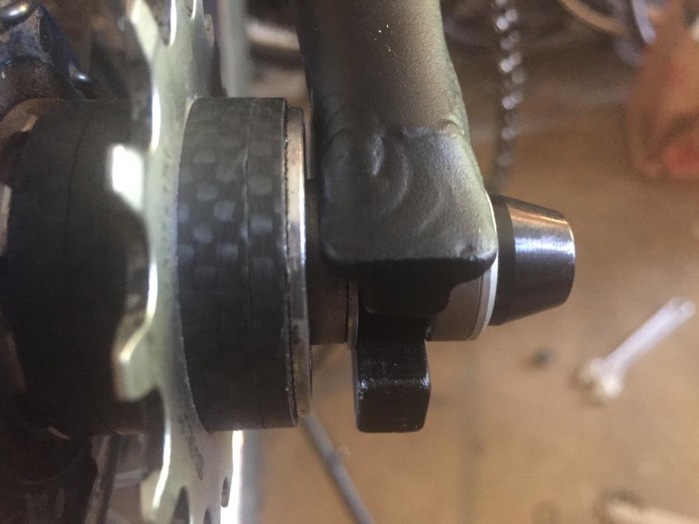

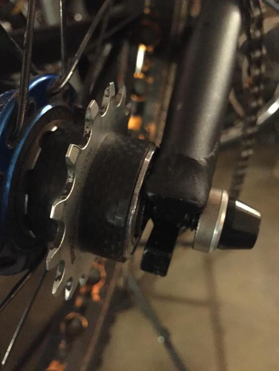

only when I put the chain on did I realize the freehub is just stuck to the frame, I'm no stranger to filing things down but I'm not sure I want to file down the drive side  dropout... is there any way I could make this fit?? This happened late last night so i didn't tinker with it, can the non drive side washers be moved around or are they fixed?

double edit: went at it today with a fresh head, changed the cog spacers around and added a thin pedal washer...now it rolls! All about that half millimeter
