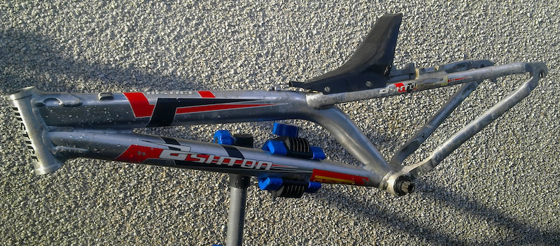

Scott Gibbs Posted March 8, 2017 Report Share Posted March 8, 2017 Does anyone know the Mk2 Justice geometry? Quote Link to comment Share on other sites More sharing options...
Tony Harrison Posted March 8, 2017 Report Share Posted March 8, 2017 I seem to remember it was advertised as 1035mm with the standard forks, but mine measured about 1020mm. 385mm chainstays I think, 73 deg head angle. Quote Link to comment Share on other sites More sharing options...
Scott Gibbs Posted March 8, 2017 Author Report Share Posted March 8, 2017 Jeez that's short! What's the BB rise? Quote Link to comment Share on other sites More sharing options...
Mikee Posted March 8, 2017 Report Share Posted March 8, 2017 Mine always measured around 1050mm to 1060mm, depending on the forks. BB rise was about 20mm, I think. 1 Quote Link to comment Share on other sites More sharing options...
Tony Harrison Posted March 8, 2017 Report Share Posted March 8, 2017 I guess it depends which frame you take to be the "mk2" - I was talking about the second batch of silver ones which had - as I recall - slightly thicker tubing than the first ones. I guess Mikee you're talking about the later red/black ones, which measured about what you said. If you do mean the silver frame then I think the bb rise was zero. Quote Link to comment Share on other sites More sharing options...
Scott Gibbs Posted March 8, 2017 Author Report Share Posted March 8, 2017 Was that the red one you had Mikee? Quote Link to comment Share on other sites More sharing options...
Mikee Posted March 8, 2017 Report Share Posted March 8, 2017 @Tony Harrison I've always known the black and red ones as the mk2. I've got a silver one too, as a frame in the loft. That was 1040 with trialtech forks, if memory serves. I also want the say that the BB was ever so slightly negative. I may be wrong, I didn't have it built all that long. @Scott Gibbs Yeah, one of them was red. I have had 7 over the years. Quote Link to comment Share on other sites More sharing options...
Scott Gibbs Posted March 8, 2017 Author Report Share Posted March 8, 2017 Cheers Mikee. So it's a good all rounder then not too Street not too comp based. Quote Link to comment Share on other sites More sharing options...
Mikee Posted March 8, 2017 Report Share Posted March 8, 2017 They are more at home on the street, from my experience. I stopped riding mine about a year ago, when my riding turned from mainly street, to mainly rocks. A lot of my local rocks are tightly packed and technical. And for that, the justice didn't feel right. It might just be me, but I always thought they ride better with momentum. Still the best all round trials bike I have owned. A bit of extra info. They aren't light, if you are coming from a more modern bike. The back end isn't all that stiff and if you like to run the pads quite close to the rim like I do, the back brake often rubs. You can get a tensioner-less setup with 18:15, with a touch of dropout filing. 2 Quote Link to comment Share on other sites More sharing options...
Scott Gibbs Posted March 8, 2017 Author Report Share Posted March 8, 2017 Weight isn't a massive issue for me to be honest, I saw your red one a while ago and I'd Probably run a 4 bolt booster on mine to like yours. To be honest I'll probably be riding about 99% street anyway with the odd Natural session thrown in once in a blue moon. Quote Link to comment Share on other sites More sharing options...
Mikee Posted March 8, 2017 Report Share Posted March 8, 2017 If manuals, bunny hops and spins are your thing, this build was super playful. And was my favourite setup. 3 Quote Link to comment Share on other sites More sharing options...
Scott Gibbs Posted March 8, 2017 Author Report Share Posted March 8, 2017 That looks really nice. Quote Link to comment Share on other sites More sharing options...
Ross McArthur Posted March 10, 2017 Report Share Posted March 10, 2017 On 08/03/2017 at 6:27 PM, Tony Harrison said: I guess it depends which frame you take to be the "mk2" - I was talking about the second batch of silver ones which had - as I recall - slightly thicker tubing than the first ones. I guess Mikee you're talking about the later red/black ones, which measured about what you said. If you do mean the silver frame then I think the bb rise was zero. The mk2 for me is the second silver frame with, as Tony rightly says, a thicker tube design and also a change to the graphics. The first paint job had two very long black and red triangles but the mk2 had triangles which wrapped round the top and bottom of the tubing with a pointed edge. I also agree that with 2.5 azonic dw bars with a 90mm 0deg rise stem, was the bolloks. 1 Quote Link to comment Share on other sites More sharing options...
Tony Harrison Posted March 10, 2017 Report Share Posted March 10, 2017 1 hour ago, Ross McArthur said: I also agree that with 2.5 azonic dw bars with a 90mm 0deg rise stem, was the bolloks. That's about what I had I think. It was just super fun, rode quite similar to my Hex. At the time I had that setup (2004-2005) the long bikes were getting in vogue, like the Coustelliers and Koxx (also Atomz etc), but they just seemed boring. I suppose that was soon after the start of the long frame thing, and around the time high BBs were coming in. Funny how shorter street bikes are so popular now : ) Quote Link to comment Share on other sites More sharing options...
