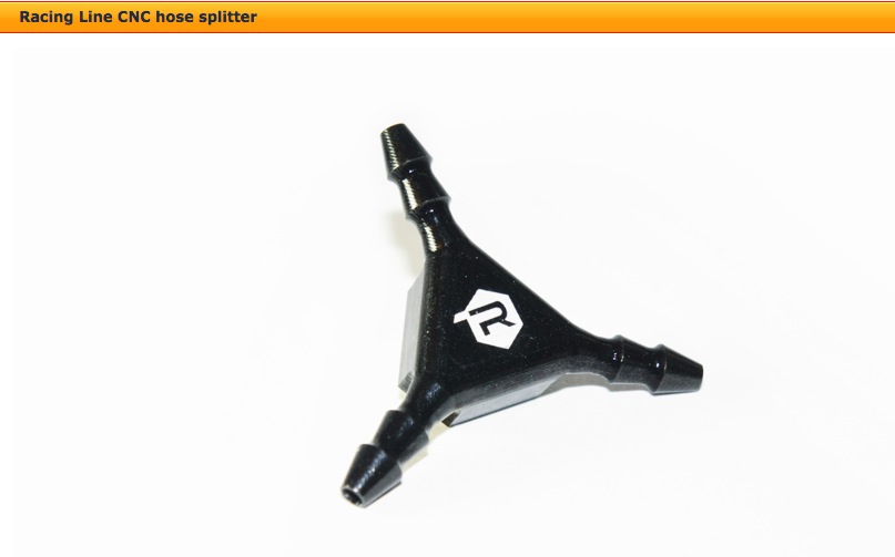

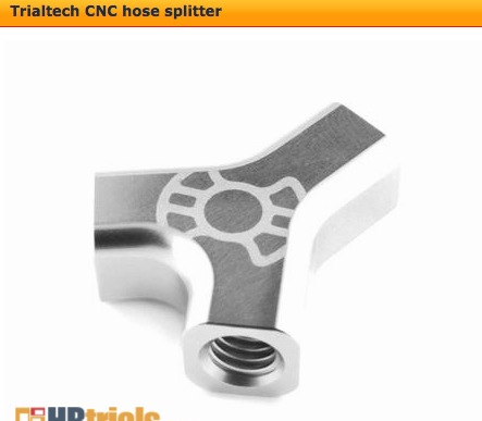

AndyT Posted February 21, 2017 Report Share Posted February 21, 2017 (edited) I'm going to a try front Magura for pogo fun times and need to buy a front hs33... what's the best set up today?? I've run a 2005 hs33 on the back for 12 years, and the ghetto ones before that... I will not run a long bendy lever like all the new racingline etc- the trialtech levers looks great, close to as short / as stiff? / more powerful than the 05 lever, I love every trialtech product I've ever had (always strong enough and works well). I don't know anyone who's got these levers in the USA so I could try them, anyone here have some experience now that they've been out a little while? If I go for this lever, what slave should I pair it with? rockman slave x trialtech clear hose x splitter would be quite nice...racing line or tt splitter? Edited February 21, 2017 by AndyT add pictures Quote Link to comment Share on other sites More sharing options...
Mark W Posted February 21, 2017 Report Share Posted February 21, 2017 The brakes I've used with Trialtech levers have all felt way better than the 2005s. I know '05s have this mythical status, but I think a lot of that is rose tinted glasses coming into play. The TT lever improves on them in every way, pretty much. I think you'd like the feel of them as they do feel a lot stiffer than most other levers, especially when you compare the new Racing Line levers with the super long but thin blades for example. In terms of splitters, just for ease of fitting the TT splitter would take it every time for me. It's a lot easier fitting some barbed fittings to separate hoses rather than having to try and mash them onto a splitter. For slaves, anything would be fine really. Most slaves are all similar in terms of performance so you won't notice as much of a difference switching from one brand of cylinder to another as you would one lever to another. 1 Quote Link to comment Share on other sites More sharing options...
Greetings Posted February 21, 2017 Report Share Posted February 21, 2017 If you're not too concerned about weight, the TT splitter is going to be way easier to fit. Not being an equilateral triangle is also an advantage since you can manage the hose better if you install the splitter upside down. 1 Quote Link to comment Share on other sites More sharing options...
