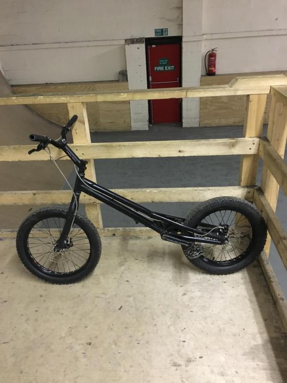

bing Posted February 12, 2017 Report Share Posted February 12, 2017 So I accidentally isitafox's zoo lynx 20". I'm probably a bit big for a mod but meh, if I don't like it the lad can ride it. It's Hope mainly, custom 116mm pro 2 ss/trials in the back, headset, front hub, brakes and rotors. Viz forks, echo tr cranks, try all bb, trialtech 180mm stem and high rise bars. Try all stiky tyres, forgot how bouncy they were. Glad to be riding again 6 Quote Link to comment Share on other sites More sharing options...
BJ. Posted February 12, 2017 Report Share Posted February 12, 2017 If you end up taking that rear hub apart send me a few photos of how the modifications have been done. Bike looks well mate. Quote Link to comment Share on other sites More sharing options...
isitafox Posted February 12, 2017 Report Share Posted February 12, 2017 TGS porn! Already miss it like mad!!!! Quote Link to comment Share on other sites More sharing options...
bing Posted February 12, 2017 Author Report Share Posted February 12, 2017 (edited) 5 hours ago, BJ. said: If you end up taking that rear hub apart send me a few photos of how the modifications have been done. Bike looks well mate. It looks like the driver has been shortened, the outer bearing removed and a thread cut into the the outside of the body to take a bb lockring. Obviously the axle has been shortened and the spacer modified to suit. It looks a proper job because the rim looks to be dished correctly, not pulled to one side or owt. It's a strong wheel as well, I can't feel it moving. Had a quick look inside it yesterday and it's all in brilliant condition. edit: it looks like the disk mount has also had 2 or 3 mm machined off it, can't see for what reason though. Just means the mount needs packing out a bit Edited February 12, 2017 by bing Quote Link to comment Share on other sites More sharing options...
Herbertlemon102 Posted February 12, 2017 Report Share Posted February 12, 2017 That is the other hub that Alex machined like mine. It's a proper job. 1 Quote Link to comment Share on other sites More sharing options...
bing Posted February 12, 2017 Author Report Share Posted February 12, 2017 Yeah it looks it, it's all solid and no play in anything, works a treat. Why hope don't sell a conversion kit I'll never know Quote Link to comment Share on other sites More sharing options...
Herbertlemon102 Posted February 13, 2017 Report Share Posted February 13, 2017 9 hours ago, bing said: Yeah it looks it, it's all solid and no play in anything, works a treat. Why hope don't sell a conversion kit I'll never know because like 4 people would buy it haha. Quote Link to comment Share on other sites More sharing options...
Alex Dark Posted February 21, 2017 Report Share Posted February 21, 2017 The disc tab is machined down because the NDS Spacer has also been machined down.... keeps proper alignment 2 Quote Link to comment Share on other sites More sharing options...
