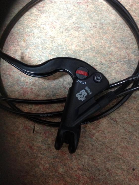

Explosifpete Posted January 11, 2017 Author Report Share Posted January 11, 2017 Thanks chaps. Although I've been a mtber since 1992 and worked in the industry for the last 8 years I haven't met any trials riders so it really helpful to get pointed in the right direction from the people in the know. The bike I'm building has mostly XC parts which I know aren't the best for trials but I want to keep things cheap before I know if I like it or not and I have accumulated masses of parts over the years. oh and that leads me on to another question. Magura hs33s, I have the latest ones but also a few sets from the race line era, I've gone with the newer due to the lever being a closer match to the Magura disc brake I'll be running but the older ones look much tougher, any opinions ? Quote Link to comment Share on other sites More sharing options...
Herbertlemon102 Posted January 11, 2017 Report Share Posted January 11, 2017 56 minutes ago, Explosifpete said: Thanks chaps. Although I've been a mtber since 1992 and worked in the industry for the last 8 years I haven't met any trials riders so it really helpful to get pointed in the right direction from the people in the know. The bike I'm building has mostly XC parts which I know aren't the best for trials but I want to keep things cheap before I know if I like it or not and I have accumulated masses of parts over the years. oh and that leads me on to another question. Magura hs33s, I have the latest ones but also a few sets from the race line era, I've gone with the newer due to the lever being a closer match to the Magura disc brake I'll be running but the older ones look much tougher, any opinions ? If you have the 14' hs33, it's the weakest. I'm not a 'new maguras are shit' promoter, their new discs are fine, but I snapped a 14', and I wasn't very good at the time. It took no impacts either. The old ones are pretty bomb proof. I had a 98" which could survive a nuclear warhead. The 04's are good too, just watch out for the TPA dial (that little dial in n the lever blade) as it's prone to breaking off in the event of a crash. The 05' are regarded as the best, they're prone to cracking but a small fix changes that. I also had a set of 11's, they feel quite spongy because of the massive lever blade, but mine were (and still are) really quite good. Quote Link to comment Share on other sites More sharing options...

Explosifpete Posted January 11, 2017 Author Report Share Posted January 11, 2017 14 minutes ago, Herbertlemon102 said: If you have the 14' hs33, it's the weakest. I'm not a 'new maguras are shit' promoter, their new discs are fine, but I snapped a 14', and I wasn't very good at the time. It took no impacts either. The old ones are pretty bomb proof. I had a 98" which could survive a nuclear warhead. The 04's are good too, just watch out for the TPA dial (that little dial in n the lever blade) as it's prone to breaking off in the event of a crash. The 05' are regarded as the best, they're prone to cracking but a small fix changes that. I also had a set of 11's, they feel quite spongy because of the massive lever blade, but mine were (and still are) really quite good. A quick search reveals I don't have the 14 which is good news! not sure what ages these are, hopefully the good ones as I have 6 of them! Quote Link to comment Share on other sites More sharing options...
Herbertlemon102 Posted January 11, 2017 Report Share Posted January 11, 2017 33 minutes ago, Explosifpete said: They're 05's! Really good omes Quote Link to comment Share on other sites More sharing options...
