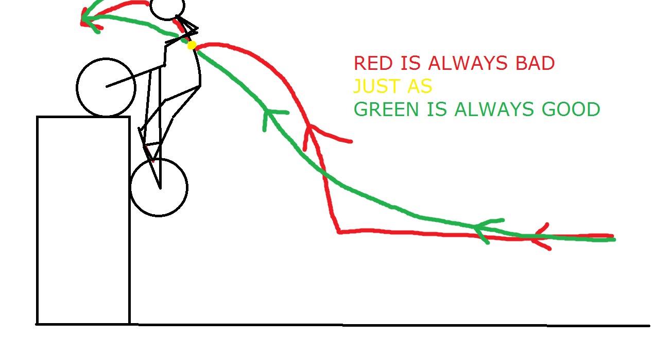

aener Posted December 19, 2016 Report Share Posted December 19, 2016 (edited) I made this yonks ago. I'm not sure how everyone else does it, but this seems to work for me. Hopefully you can understand it This is specific to bunnyhop hooks too - the theory might work the same for pedalling, but I've not tried them. The smoother the rise of centre of gravity (solar plexus region for most people), the easier it seems to work. If you go too slow, you have to jump UP to the hook position, and then UP from the hook to switch. For me, speed is king. It means you have to take off further back, but you can get a nice gentle rise that can continue from the switch onward. Speed also means you have more momentum, which carries you up on to the top. Hitting the wall is always going to suck a certain amount of momentum away from you. Obviously this gets trickier as you get to your peak height, but then you can start wrestling. Just do ones at comfortable heights until you get the idea of them enough to start wrestling/improvising. Key pointers, in my experience: Go fast - faster than you'd approach any other technique, and possibly faster than feels appropriate/safe. As Ali said, get the front wheel in just the right place. Ideally it will go up and just touch the top of the wall. Difficulty exponentially increases with the distance your front wheel moves down from where you put it to the top of the wall. Lean forwards. A lot. Doing all that at once is tricky, but there's a knack to it. Once you've got it, hooks aren't actually that hard. Edited December 19, 2016 by aener 8 Quote Link to comment Share on other sites More sharing options...
ben_travis Posted December 19, 2016 Report Share Posted December 19, 2016 (edited) I went through a period of fear with hooks. To the point I wouldn't do them at all. I agree with both Flipp and Ali that the bunny hop technique is all about the speed. Also, my opinion is that there are some walls that are too small to learn on, because you will end up getting too far up on the wall, hitting your bash / front wheel too far up etc. Make sure you find something that's high enough that you can't hop up it to both wheels Edited December 19, 2016 by ben_travis 1 Quote Link to comment Share on other sites More sharing options...

ben_travis Posted December 20, 2016 Report Share Posted December 20, 2016 1 hour ago, Greetings said: So this brakeless technique would require you to hit the front wheel slightly below the edge? Otherwise won't you just slide into the obstacle with the cranks? No. Remember, both wheels are to hit at the same time (see Flipps diagram), you're essentially landing in a wedge, but the back wheel should give a bit of bounce (and you're momentum should put your body above the front wheel) with the front wheel being the pivot point. Obviously the wheel will roll a little, that's why 'most' brakeless hooks go up to both wheels rather than to back. 1 Quote Link to comment Share on other sites More sharing options...
