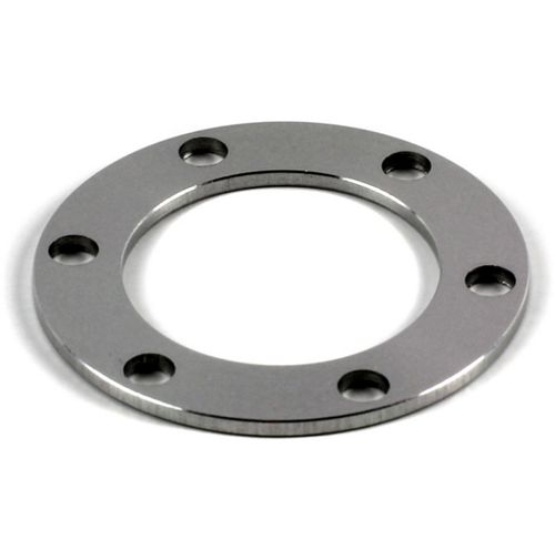

niconj Posted February 9, 2017 Author Report Share Posted February 9, 2017 (edited) 2 hours ago, AndyT said: Go for 22 Nm they don't come out. Somebody is going to try it I'm sure. The internet is always right. I bought six M5x13 titanium bolts, the above mentioned Hope spacer and Loctite 2701. This will work I'm sure. Edited February 9, 2017 by niconj Quote Link to comment Share on other sites More sharing options...
