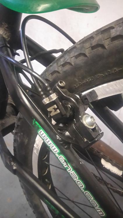

Mh397 Posted October 26, 2016 Report Share Posted October 26, 2016 (edited) Hi Can anyone recommend a booster for this set up? The zoot ain't half flexy! Edited October 26, 2016 by Mh397 Quote Link to comment Share on other sites More sharing options...

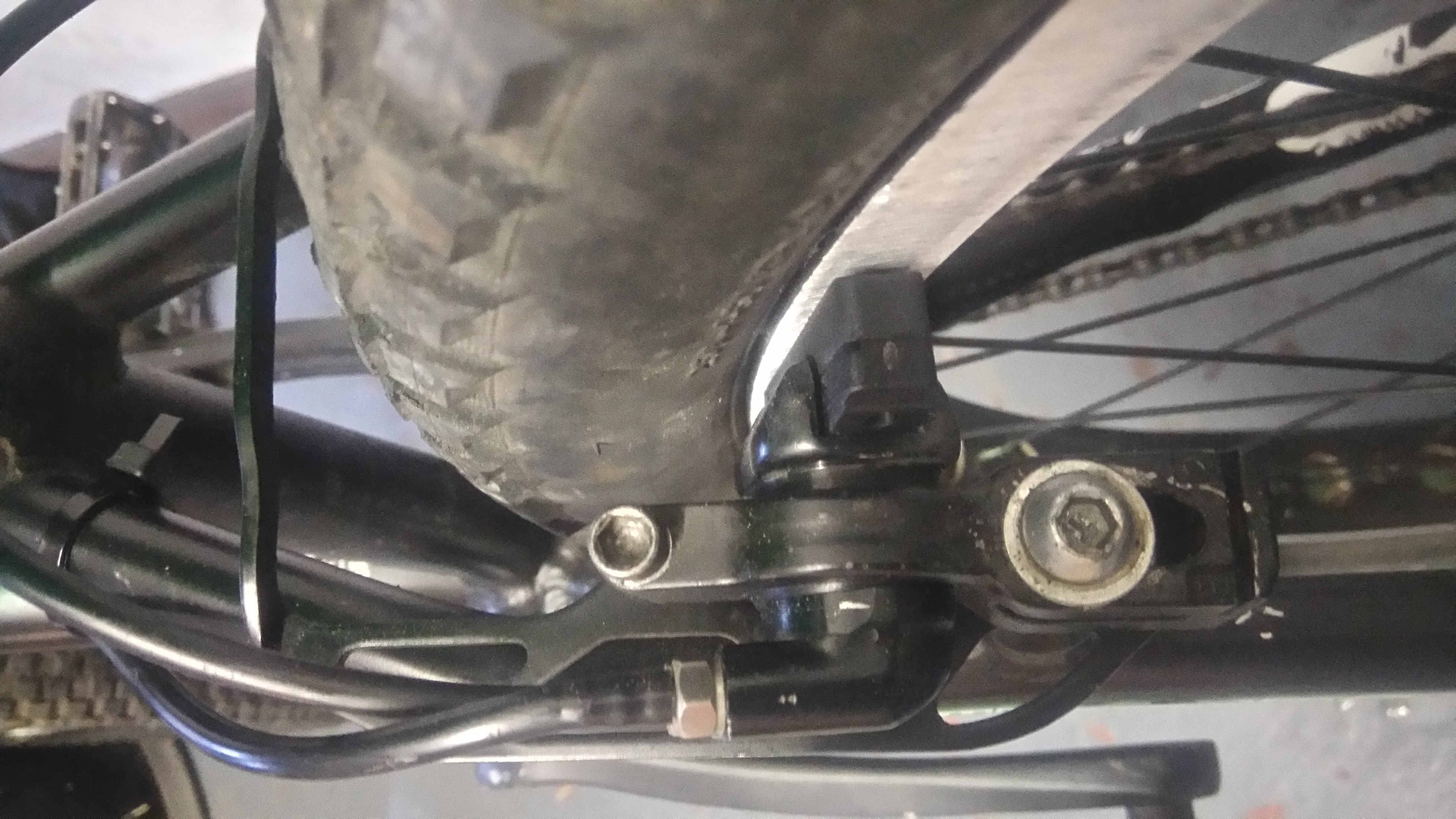

Mh397 Posted October 26, 2016 Author Report Share Posted October 26, 2016 (edited) Not sure if a booster can be run with that brake adapter??? Edited October 26, 2016 by Mh397 Quote Link to comment Share on other sites More sharing options...

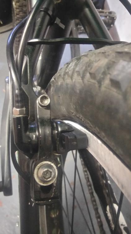

isitafox Posted October 26, 2016 Report Share Posted October 26, 2016 You're always gonna struggle with a hydraulic on V adaptors. I'd stick a V brake on with possibly a shimano booster. Quote Link to comment Share on other sites More sharing options...
niconj Posted October 26, 2016 Report Share Posted October 26, 2016 5 minutes ago, isitafox said: You're always gonna struggle with a hydraulic on V adaptors. I'd stick a V brake on with possibly a shimano booster. This. Deore brakes with an XTR carbon booster (pretty rare these days). Better than a HS33 anyways. Quote Link to comment Share on other sites More sharing options...
Dan_Trials Posted October 26, 2016 Report Share Posted October 26, 2016 Mags Evo 2 booster, £12.50: http://www.ebay.co.uk/itm/Magura-HS11-HS33-EVO-2-Brake-booster-/172362637975?hash=item28219d2297:g:XXMAAOSwCGVX8msQ Quote Link to comment Share on other sites More sharing options...
old boy chez Posted October 27, 2016 Report Share Posted October 27, 2016 V brake booster will work Quote Link to comment Share on other sites More sharing options...
Ross McArthur Posted October 27, 2016 Report Share Posted October 27, 2016 I've heard Carbonique boosters are pretty good too. Quote Link to comment Share on other sites More sharing options...
weebryan Posted October 27, 2016 Report Share Posted October 27, 2016 Before the 4 bolt days v brake booster and Magura booster Quote Link to comment Share on other sites More sharing options...
Mh397 Posted October 27, 2016 Author Report Share Posted October 27, 2016 Thanks for the replys guys. Think I'm gonna risk a better booster first the if that fails get some nice shiny xt, v' s Also is that a Base ta 26 weebryan? Quote Link to comment Share on other sites More sharing options...
AdamR28 Posted October 28, 2016 Report Share Posted October 28, 2016 What you want is a 2-Bolt HS33 booster: http://www.tartybikes.co.uk/2bolt_boosters/trialtech_sport_2bolt_booster/c104p10739.html Might need some 5mm longer bolts, but might get away with it. Try it and see V-Brake booster won't help on that setup. Quote Link to comment Share on other sites More sharing options...
