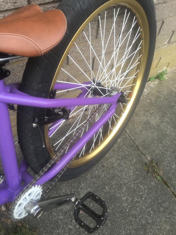

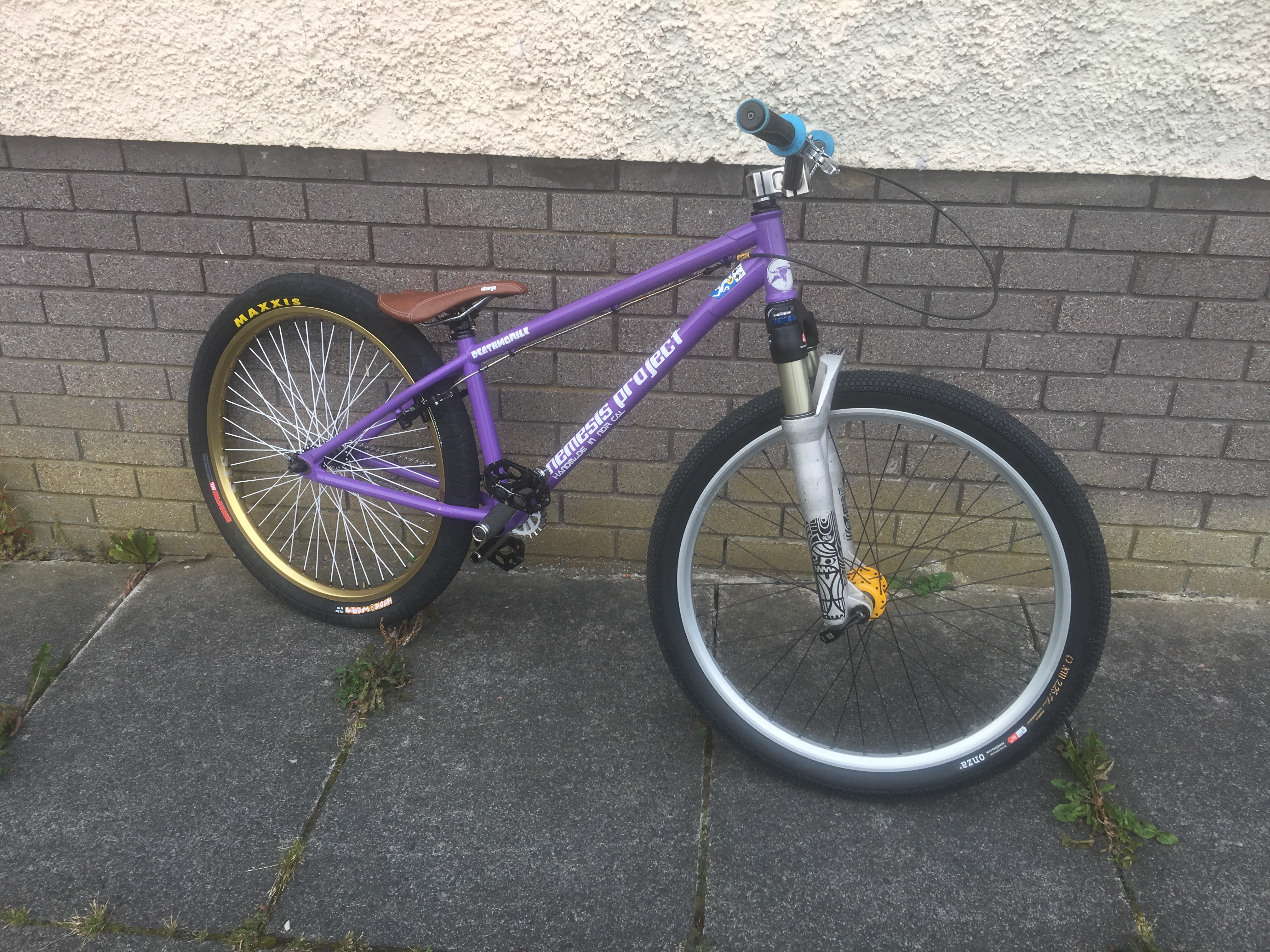

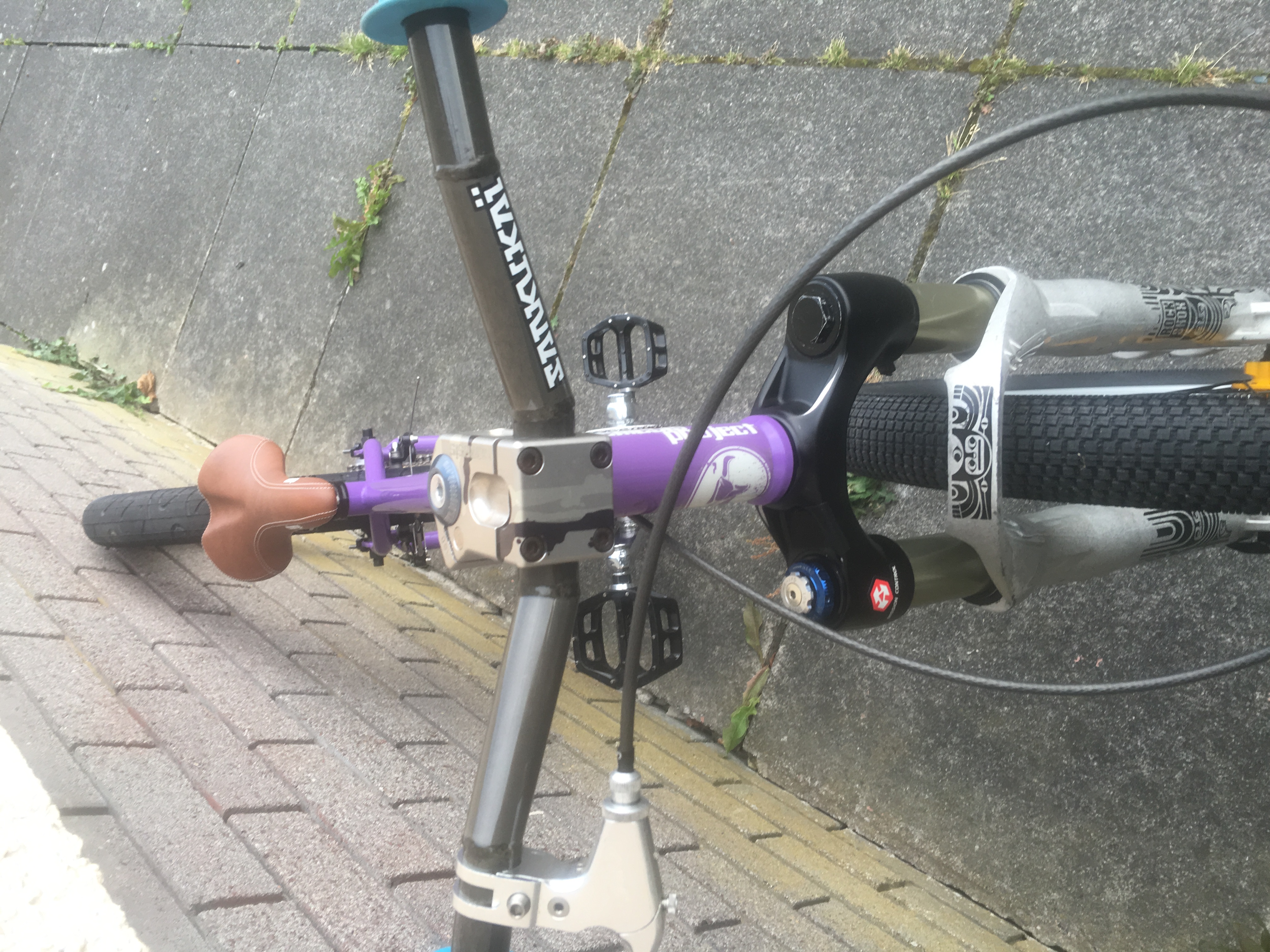

japslap Posted August 27, 2016 Report Share Posted August 27, 2016 (edited) Been putting this tank together for a while, nemesis project death mobile frame, (ex factory rider frame) 48 spoke halo sas rim with profile high flange left hand drive bmx hub with maxis hook worm 2.5 tire sun rim on nuke proof hub with onza XIII tire (2.3 I think) rockshox totem coil slammed to 80mm ( in these pics) since then tinkered to 90mm on a firm coil and mission control fluid gate removed nempro camp stem (no.099) stem thompson seat post 24 bikes sankuri bars avid ultimate rear v brake and lever, extra long good ridge, nokon cable for bar spins charge spoon seat definetly not a light bike but to be honest I never thought it was going to be or tried to make it light, just something to last a while, still tinkering with it and changing things after nearly every ride but that's just part of the love I have for it Hell im not even sure what kinda of bike type it comes under, grinding pegs coming soon lol Edited August 27, 2016 by japslap Added getto upgrade Quote Link to comment Share on other sites More sharing options...

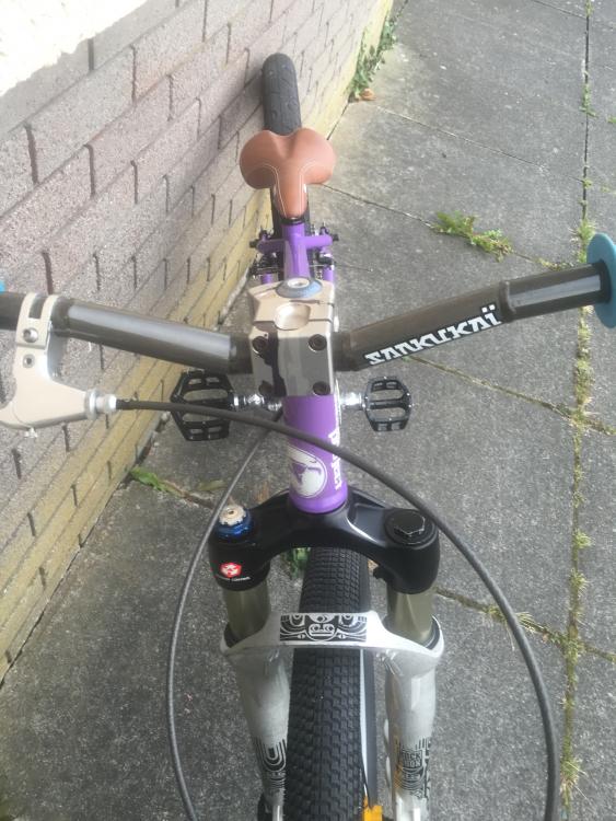

Dman Posted August 27, 2016 Report Share Posted August 27, 2016 Look's fun but i couldn't trust those bars Quote Link to comment Share on other sites More sharing options...
japslap Posted August 27, 2016 Author Report Share Posted August 27, 2016 Yea man had my doubts myself with the tig welds but after breaking a few alloy bars wanted to go chromoly and a little different than usual, 4130 chromoly tig welded was about as far out as I could find lol have you experience with the sankuki bars yourself? Any other suggestions to try out instead? Quote Link to comment Share on other sites More sharing options...
Dman Posted August 27, 2016 Report Share Posted August 27, 2016 No but welds there just dont look right Quote Link to comment Share on other sites More sharing options...

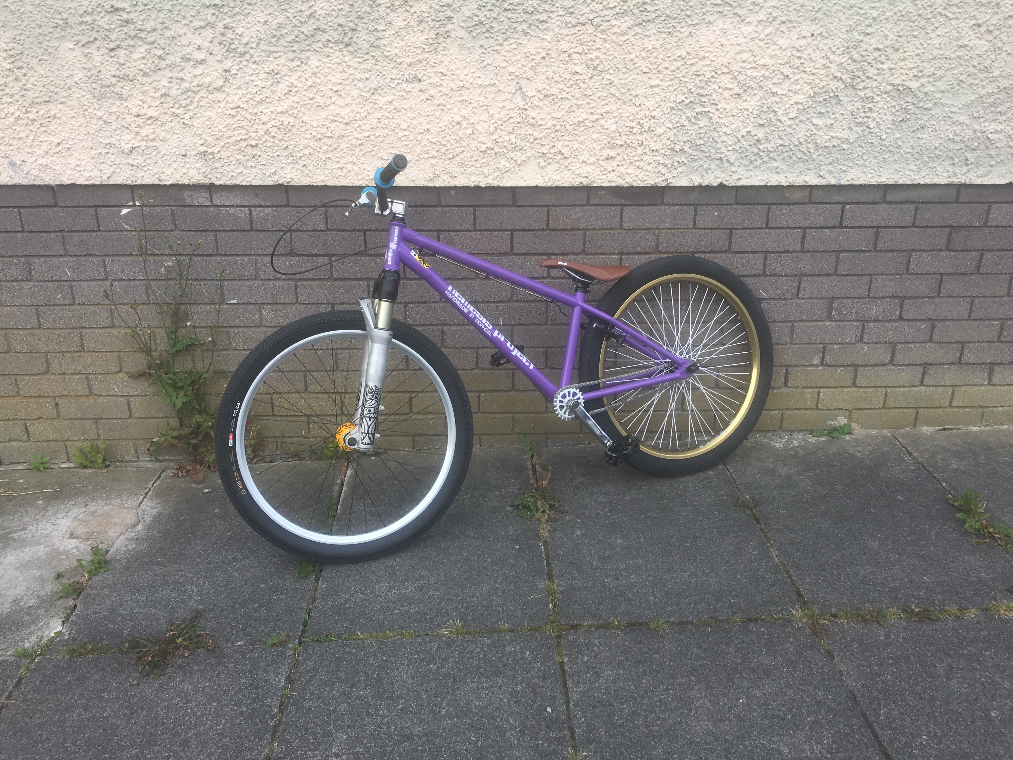

jeff costello Posted August 28, 2016 Report Share Posted August 28, 2016 left hand drive? that's kind of unusual. 1 Quote Link to comment Share on other sites More sharing options...
Daviesdt Posted August 28, 2016 Report Share Posted August 28, 2016 27 minutes ago, jeff costello said: left hand drive? that's kind of unusual. Didn't even notice that! Never seen that before. Quote Link to comment Share on other sites More sharing options...
jeff costello Posted August 28, 2016 Report Share Posted August 28, 2016 2 hours ago, Daviesdt said: Didn't even notice that! Never seen that before. i had to double check that it's not the image that's mirrored. bmxs occasionally come with LHD. don't for what purpose though. Quote Link to comment Share on other sites More sharing options...
japslap Posted August 28, 2016 Author Report Share Posted August 28, 2016 Yea it's lhd, my first lhd drive wheel build, trying different things out on this build, getting some short chubby pegs for the right hand side for grinds, also in the process of a custom grind guard for the right side of the totem. Honestly thought more eye brows would be raised for using one of the biggest sets of single crown downhill forks on the market as landing gear lol Quote Link to comment Share on other sites More sharing options...
Guest Posted August 28, 2016 Report Share Posted August 28, 2016 In bmx. If you grind on the right. Then you run left hand drive. And if you grind on the left. You run right hand drive. Quote Link to comment Share on other sites More sharing options...

Paperclip Posted August 29, 2016 Report Share Posted August 29, 2016 I found those sas rims to soft and flexible for the rear I know you'll be doing different things and it has quite the amount more spots than I had used so you should see how it fairs up. I do find the shade of gold these rims are appealing. 1 Quote Link to comment Share on other sites More sharing options...

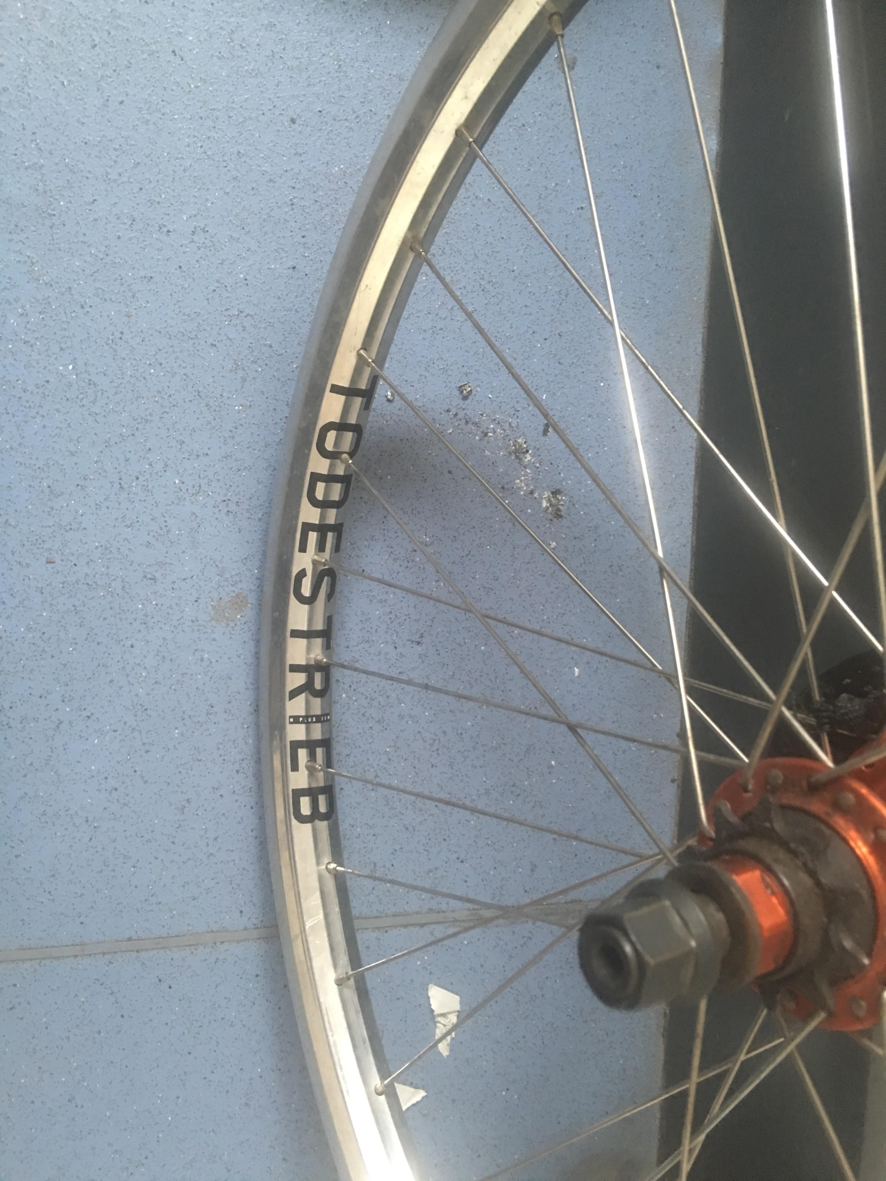

japslap Posted August 30, 2016 Author Report Share Posted August 30, 2016 (edited) 9 hours ago, Paperclip said: I found those sas rims to soft and flexible for the rear I know you'll be doing different things and it has quite the amount more spots than I had used so you should see how it fairs up. I do find the shade of gold these rims are appealing. Yea I know where your coming from, so far it's holding up well, haven't used it much and only just done the initial re-tightening of the non drive side after first use, my profile is 48 hole so had limited choice, thinking I should have gone 4 cross, other than that I have a set of todestrieb chrome rims I was toying with putting on but there laced to a fixed hub and unfortunately the death mobile runs a Spanish bb or I'd have a front free wheel set up on the right Edited August 30, 2016 by japslap Quote Link to comment Share on other sites More sharing options...
uk24 Posted August 31, 2016 Report Share Posted August 31, 2016 I wouldn't put pegs on a nemesis project frame. The axle is the hub will be strong enough but you will bend the drop outs on them. Quote Link to comment Share on other sites More sharing options...
