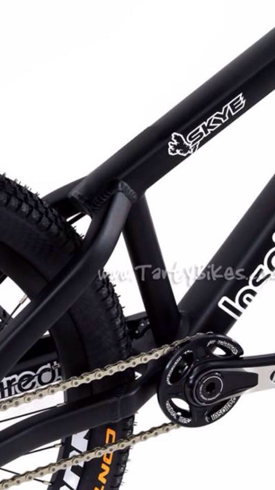

Ross McArthur Posted August 26, 2016 Report Share Posted August 26, 2016 There is the longer trialsy version too! Comes in 20mm longer wheel base. Cos that's what matters. 6 Quote Link to comment Share on other sites More sharing options...
Daviesdt Posted August 26, 2016 Report Share Posted August 26, 2016 A skye without a seat!? Is that for real!? Why would they do that!? 3 Quote Link to comment Share on other sites More sharing options...
Ross McArthur Posted August 27, 2016 Report Share Posted August 27, 2016 Comps. 3 Quote Link to comment Share on other sites More sharing options...
