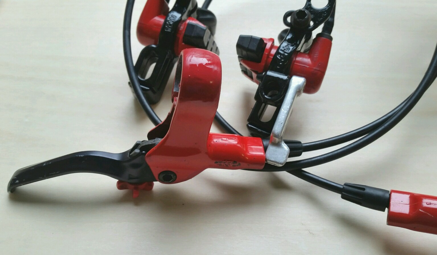

niconj Posted August 6, 2016 Report Share Posted August 6, 2016 7 hours ago, Alex Dark said: 04 Magura bodies also.... Won't run anything else Can you post a picture? Are these the ones (I think the Tomac were from 2009 but is there any difference to 2004?): Quote Link to comment Share on other sites More sharing options...
