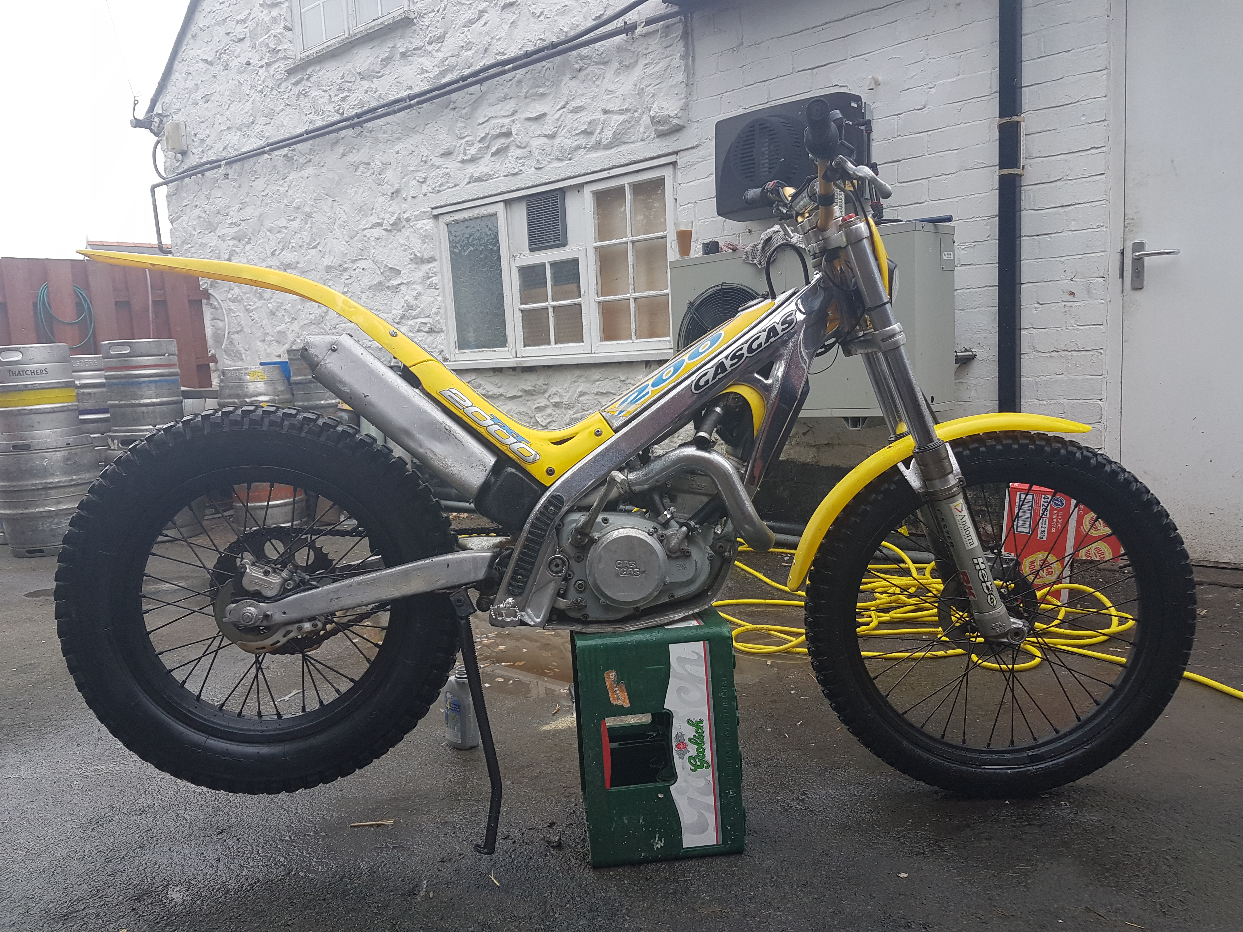

Dantheman89 Posted August 2, 2016 Report Share Posted August 2, 2016 Hi I have a txt 200 the barrel is cracked beyond repair. I have rang gasgas UK and all the breakers and no one has one . Is there any thing that will fit my bike as it's to good to scrap Quote Link to comment Share on other sites More sharing options...
bing Posted August 2, 2016 Report Share Posted August 2, 2016 Wrong forum mate. This is a pedal bike trials forum. Have you tried eBay though for a barrel? And try trials and mx news, they have breakers in the back of the paper in the free ads. Give Matt at inch perfect trials a call as well, he's a secondhand dealer and may be able to help you out Quote Link to comment Share on other sites More sharing options...
forteh Posted August 2, 2016 Report Share Posted August 2, 2016 Might be worth giving pjme a ring to see if they can repair it. They welded up, machined replated and honed my 636 rotax motor after the oil pump had failed and twisted the piston in the bore. It cost 193 to do the whole lot including rebuilding and balancing the crank, took a while but well worth the wait! https://www.pjme.co.uk/ Good luck Quote Link to comment Share on other sites More sharing options...
Dman Posted August 4, 2016 Report Share Posted August 4, 2016 (edited) Where's the crack? I ripped the exhaust port and mountings off mine once, got it repaired quite easily. http://www.roadandtrials.co.uk/buy/Genuine-GasGas-Gas-Gas-Trials-Exchange-Cylinders/Gas-Gas-Exchange-Cylinders.htm 300 for a barrel exchange, not sure if that's your model, but have a look. Edited August 4, 2016 by Dman Quote Link to comment Share on other sites More sharing options...
CC12345678910 Posted August 4, 2016 Report Share Posted August 4, 2016 Thought about putting a 125 or 250 set up on? I was told (reliably, but check first) that 02-07 gas gas (at least, could be up to 08 but just now it escapes me) were the same from the bottom end up, and only the barrel, piston and, where applicable, the carb were the differences in each model year, but as it happens the bikes barely changed in those years & there is a massive parts overlap. If I recall correctly John Shirt Motorcycles, now gasgasuk, did a 156cc big bore kit for txt125 as we (me and dad) considered one at the time. We think that was done from boreing a batch of 125 barrels. Beyond that there is a whole world of people in the bike world (small ads in classic racer magazine or classic bike spring to mind) where problems like a cracked barrel is no sweat. Hell you could take the opportunity to go nuts & Nikasil coat the bore afterwards... Most importantly though, your bike is most definitely not scrap. Quote Link to comment Share on other sites More sharing options...
