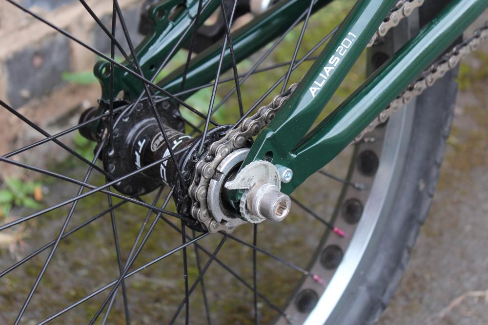

insomnia Posted August 2, 2016 Report Share Posted August 2, 2016 Hey there England! im thinking about fitting a new Hope trials 135mm hub To my Ozonys Curve. one Thing came to mind... is it possible to run the Hope hub with snailcam chain tensioners? i think i Must Be possible but wanted to ask before Spending so much Money on it. will run a normal Screw on sprocket on Front then. thanks in advance germany elias Quote Link to comment Share on other sites More sharing options...
Mark W Posted August 2, 2016 Report Share Posted August 2, 2016 Yes and no - basically, they're 135mm spaced so you'd need to run them on the outside of your frame, or just squeeze a single drive-side one inside the frame too. Just using a single cam with the Hope hubs isn't too bad simply because of how tight you get those M10 axle bolts. Quote Link to comment Share on other sites More sharing options...
insomnia Posted August 2, 2016 Author Report Share Posted August 2, 2016 So just one cam on Drive Side, Push real in Position and give them bolds some bomb Proof lock? ill give that a Try cheers Quote Link to comment Share on other sites More sharing options...
AdamR28 Posted August 2, 2016 Report Share Posted August 2, 2016 Yup - or it should hold in place fine with no cams. Quote Link to comment Share on other sites More sharing options...
Herbertlemon102 Posted August 2, 2016 Report Share Posted August 2, 2016 1 hour ago, Adam@TartyBikes said: Yup - or it should hold in place fine with no cams. 1 hour ago, insomnia said: So just one cam on Drive Side, Push real in Position and give them bolds some bomb Proof lock? It would be great if it would hold with just the bolts- however, it still shifts without tensioner, albeit less. Marks suggestion is what I do- one on the outside. get it in place, fit and forget! Bar minor adjustment due to chain stretch... Quote Link to comment Share on other sites More sharing options...
Mark W Posted August 2, 2016 Report Share Posted August 2, 2016 I'm running my Pro 2 on my Arcade with no tensioners - no movement yet. Clean dropouts, shitloads of grease, everything's fine. 1 Quote Link to comment Share on other sites More sharing options...
insomnia Posted August 2, 2016 Author Report Share Posted August 2, 2016 Sooo..... Just ordered a Brand new v4 trials hub. lets See what it is Capable of Quote Link to comment Share on other sites More sharing options...
AdamR28 Posted August 3, 2016 Report Share Posted August 3, 2016 Tends to hold better in alu frames as the material is a bit softer and lets the teeth dig in Quote Link to comment Share on other sites More sharing options...
