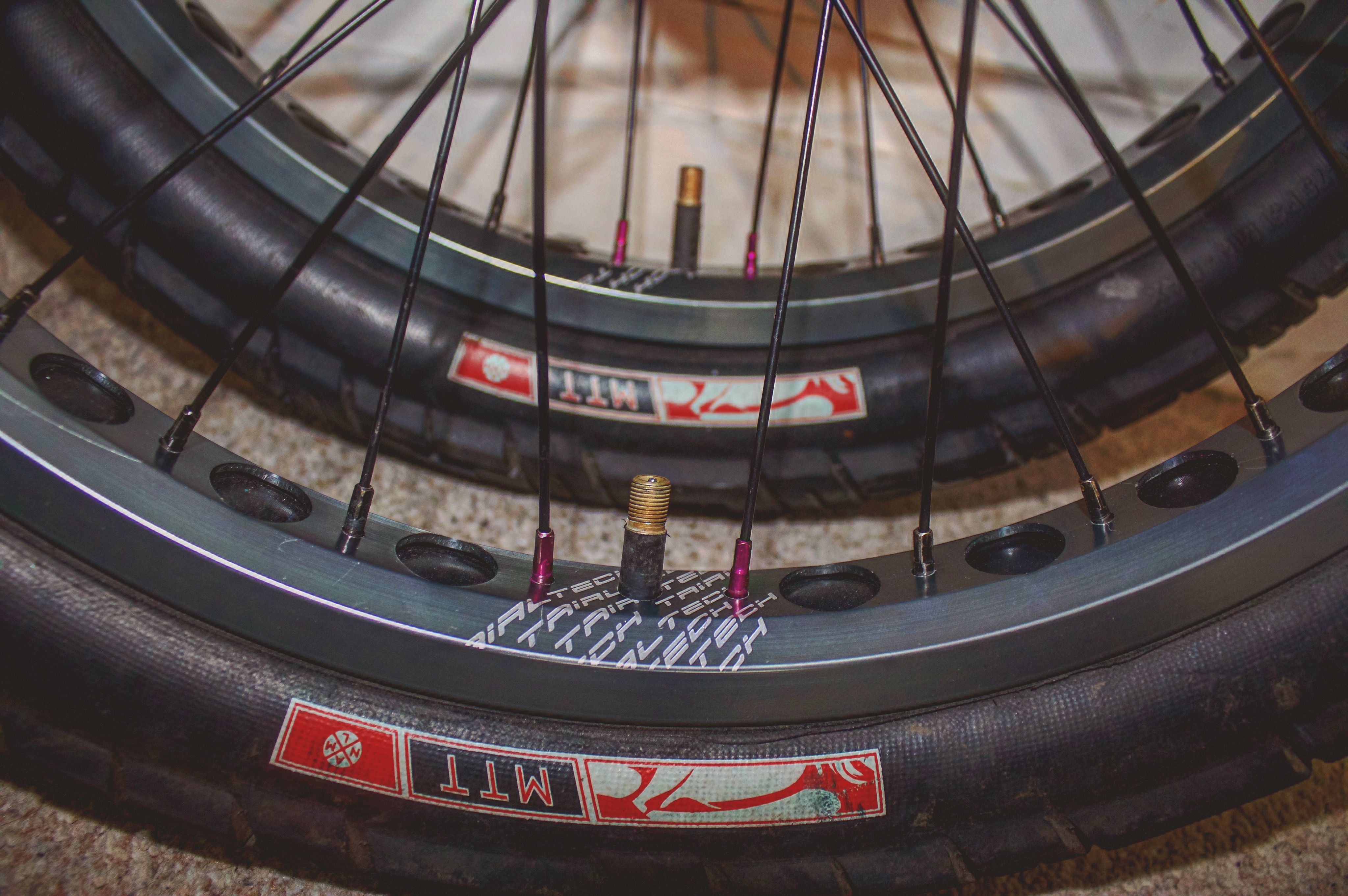

Also, nice photo! Is that the same front tyre + fork as Flipp runs? Why the booster fork if you don't have maggie?

They are the same tyres, yeah. After using them briefly when I first got them I can understand why no one bought them for bmx's, they're ridiculously grippy. Great for trials! I killed my rear 20" before that photo was taken but I just built up a new set the other day.
And, as cap said, foot jams :P
