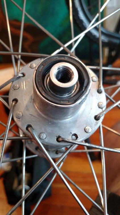

Brian Bleech Posted May 28, 2016 Report Share Posted May 28, 2016 Need to swap the internals from one hub shell to another? Watched a couple of vids online and seem can knock bearings using the axle. Do I need one of the Hope tools to knock the bearings into the new shell? Or can I use the axle somehow? Quote Link to comment Share on other sites More sharing options...
Cap Posted May 28, 2016 Report Share Posted May 28, 2016 (edited) You just need a socket or something a similar size (ever so slightly smaller so it doesn't get stuck in the hub shell) as the bearing outer race to knock it back into the hub shell, you only really want to be hitting the outer race Edited May 28, 2016 by Cap Quote Link to comment Share on other sites More sharing options...
Brian Bleech Posted May 28, 2016 Author Report Share Posted May 28, 2016 Cool man, I am sure I can find something! Thanks Quote Link to comment Share on other sites More sharing options...
Brian Bleech Posted June 3, 2016 Author Report Share Posted June 3, 2016 I am screwed for getting the axle out? Any ideas folks? Quote Link to comment Share on other sites More sharing options...
gage-mann Posted June 3, 2016 Report Share Posted June 3, 2016 Thread the axle bolt over half way in and smack it? 1 Quote Link to comment Share on other sites More sharing options...
Brian Bleech Posted June 3, 2016 Author Report Share Posted June 3, 2016 Tried that! New axle and bearings will be ordered and keep that as a spare. Quote Link to comment Share on other sites More sharing options...
