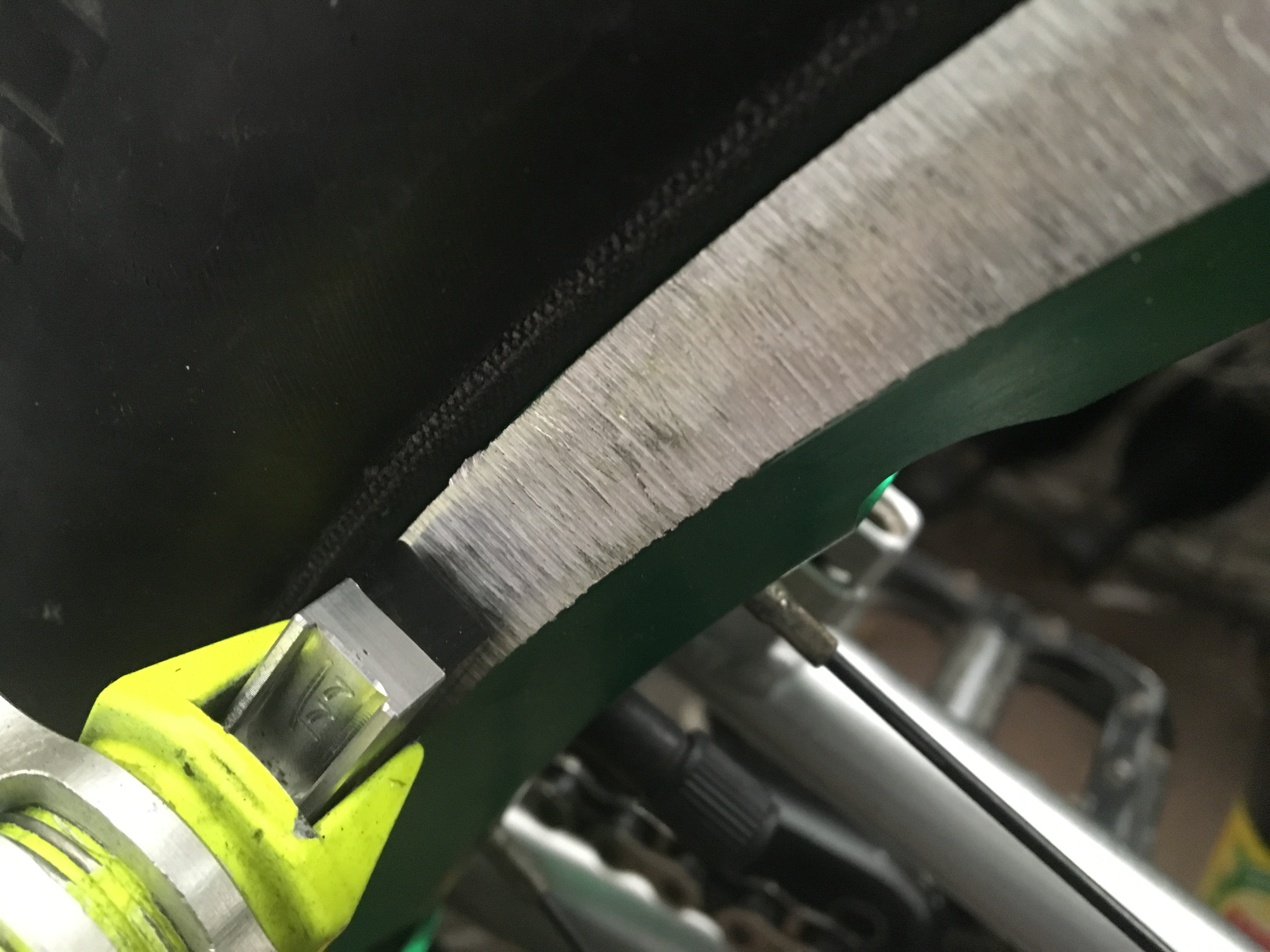

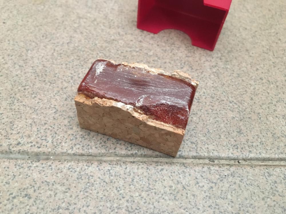

joaovidal12 Posted April 20, 2016 Report Share Posted April 20, 2016 Greetings! I have a ground rim, read much about tar and violin rosin, couldnt get my hands on tar so I picked a violin rosin bar for 3€. I just want to improve the rear brake little more. My setup: Echo double wall rim (I guess it is) + TNN ADM pads + TNN clamps and integrated booster + 2004 Magura HS33 Race Line First impressions: - It is brittle AF ! If you drop it seems like it will shatter into a million pieces ... - It is not very sticky, gets into powder once rubbed in the rims. - After a few stops it gets embedded in the grooves of the rim, the rest disapears. - Performance in a garage run: Louder, more bite, a bit better hold. Quote Link to comment Share on other sites More sharing options...
isitafox Posted April 20, 2016 Report Share Posted April 20, 2016 I'm sure I read that you need to melt it and rub it on to the rim with a cloth? Quote Link to comment Share on other sites More sharing options...

Greetings Posted April 22, 2016 Report Share Posted April 22, 2016 On 20.04.2016 at 11:52 PM, joaovidal12 said: The question that I have is: Applying it in the dissolved form will increase effectiveness ? It has to be applied with thinners because that will make it stick to the rim. Applying it like tar won't get good results as the rosin crumbles on contact with the rim and doesn't stick. If you can't get hold of some nitro, use acetone. Just as good. The bite on rosin is incredible and it retains a very responsive brake similar to that on a clean sharp grind. Quote Link to comment Share on other sites More sharing options...

joaovidal12 Posted April 24, 2016 Author Report Share Posted April 24, 2016 Unfortunately I haven't tried it yet in real riding. But there is no sticky feel with it, in the powder form. And a bit of extra noise, which I don't mind After the test, and the rosin effect disappear I will try the liquid form. Quote Link to comment Share on other sites More sharing options...
