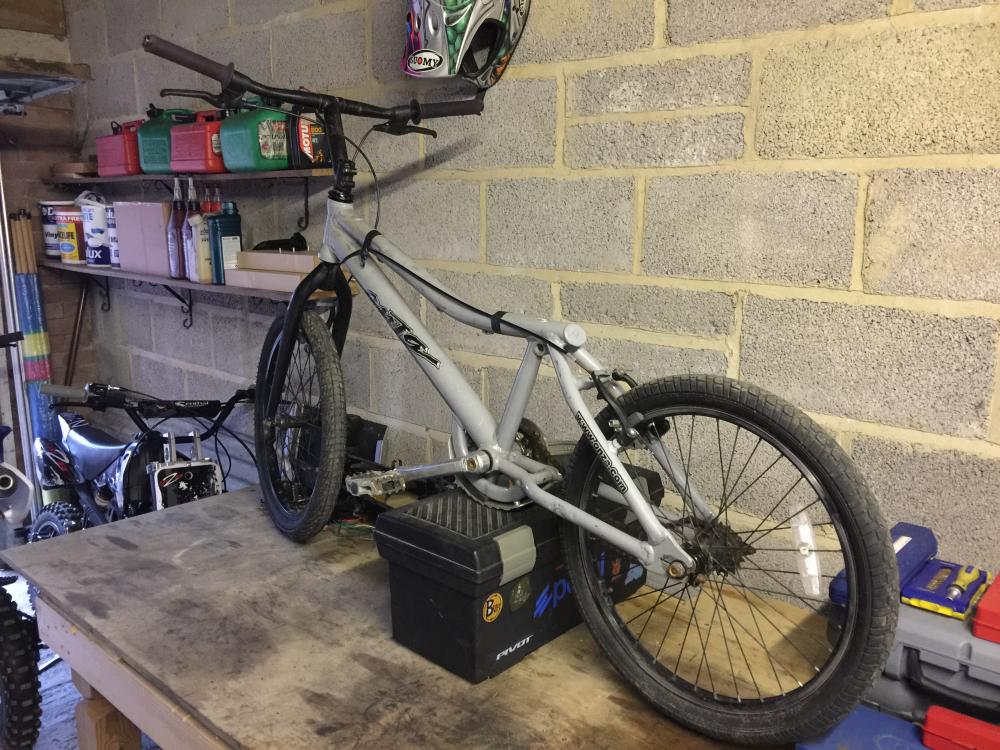

Fingerbang Posted April 11, 2016 Author Report Share Posted April 11, 2016 A tenner got me this...... Quote Link to comment Share on other sites More sharing options...
AdamAllen Posted April 11, 2016 Report Share Posted April 11, 2016 Thats an Onza T-vee mate, T-bird of that age had a 19" Rear wheels and 4bolt mounts. You'll need an internal headset, If I were you Id just replace whats shot in there, should be easy enough Quote Link to comment Share on other sites More sharing options...
bike_dummie Posted April 11, 2016 Report Share Posted April 11, 2016 4 hours ago, AdamAllen said: Thats an Onza T-vee mate, T-bird of that age had a 19" Rear wheels and 4bolt mounts. You'll need an internal headset, If I were you Id just replace whats shot in there, should be easy enough Probably easier to just to replace it, cheap too. 12 hours ago, Fingerbang said: A tenner got me this...... Are you sure that headset has been assembled correctly? There shouldn't be such a large gap between the headtube and top cover. Quote Link to comment Share on other sites More sharing options...

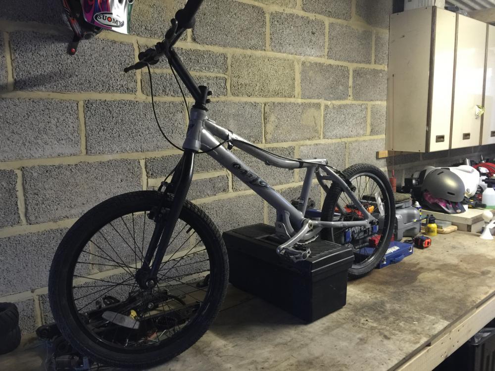

Fingerbang Posted April 16, 2016 Author Report Share Posted April 16, 2016 So after attempting to 'make it work' I succumbed and bought a new headset. No matter what I did it wouldn't tighten..... And then I found the star nut was making a bid for freedom by sneakily working his way up the steerer tube. The back end is now sorted - back wheel is straight, tires almost new looking, v brakes stripped cleaned and nice and springy. Chain was approximately 1 mile long (ok 1/2 mile) so that's been shortened and everything that moves given a liberal dose of oil. Once I got the headset in the bike will be ready to go so I'll post up a pic. That headset more than doubled the value of this £10 project! Quote Link to comment Share on other sites More sharing options...
Fingerbang Posted April 22, 2016 Author Report Share Posted April 22, 2016 First off - thanks bike_dummie! Bought that headset. Top stuff and managed to double the value of the bike! Fitted the headset, stripped the brakes, cleaned everything up, added some spare grips I had laying about, aligned the rear wheel and shortened the chain. It is one fun ride!! Nice and sturdy feel; nothing feels loose or rattles. A couple of 360 nose spins, curb hops, and I'm hooked!!! I can see a much better bike in the future sitting next to my other toys but for now this'll do nicely to learn new skills on!! Value wise - would this old bike be worth stripping, respraying and making pretty or a waste of cash!? Would it be better to enjoy as is, bash about on it and then get something with disc brakes!? Quote Link to comment Share on other sites More sharing options...
