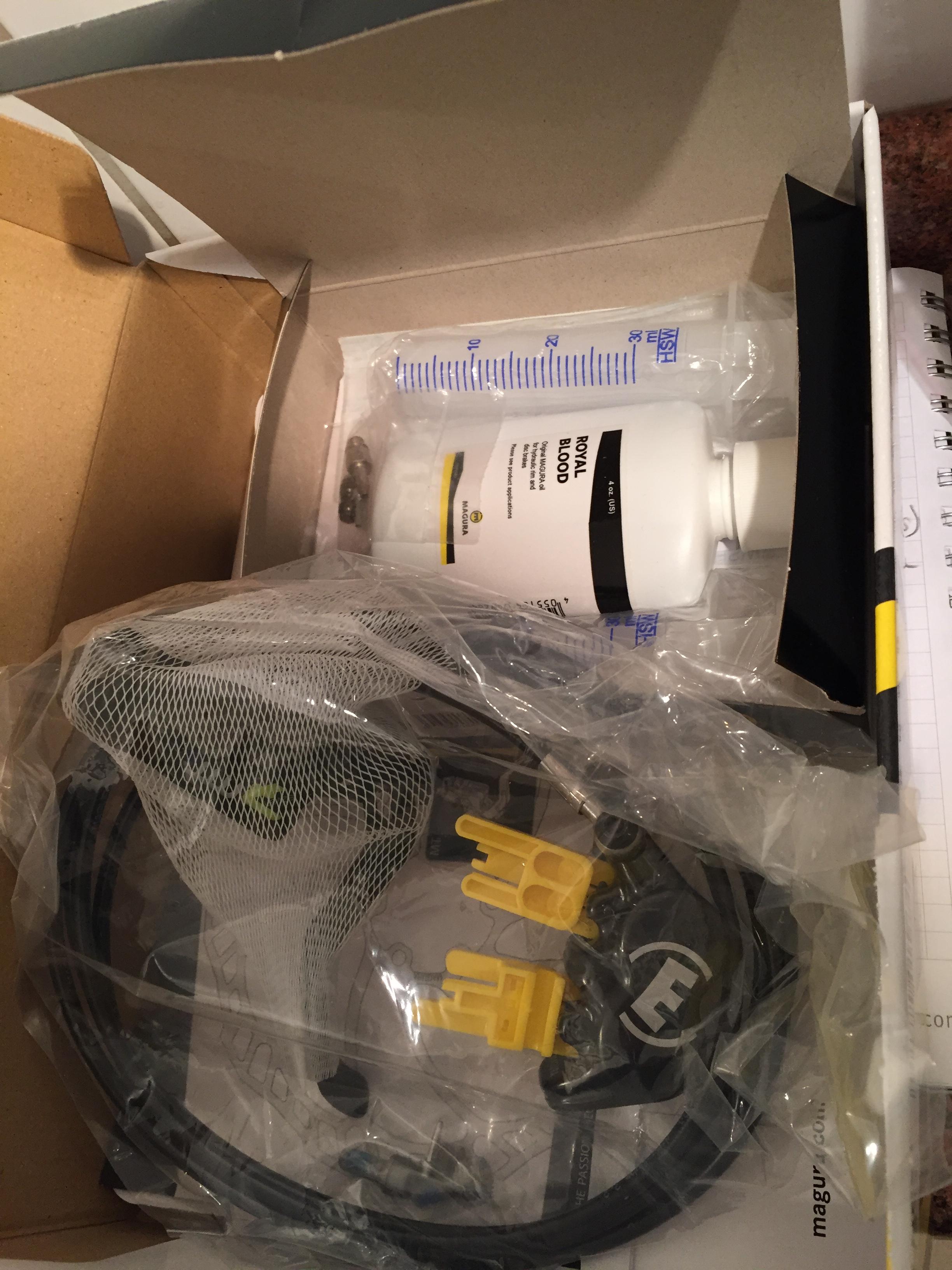

I was contacted by Magura Germany AND USA. They took a while, but once in contact with them their costumer service was awesome!
We started from the basic (bleed all again according to procedure). And even though I knew the problem was not there, I did it again with same results. So I took a video of what was wrong and send it to the people form Magura USA (Kent King was the person I spoke with). So he asked for my address and sent an spare directly to my home (in Chile). I received the "spare" yesterday: a complete lever and caliper kit with minor bleeding kit included!!! What can I say?! That kind of costumer service is the one that gets loyal costumers for ever!
I was expecting to buy the spare and get some instructions on how to change it, and instead of that I got, not only the spare for free, but the whole kit!
As I stated earlier, this are the best brakes I´ve ever had, and thanks for costumer support I´ll still be able to use them and not change to Guide´s, which seems to still have some reliability issues as I have been asking around.
