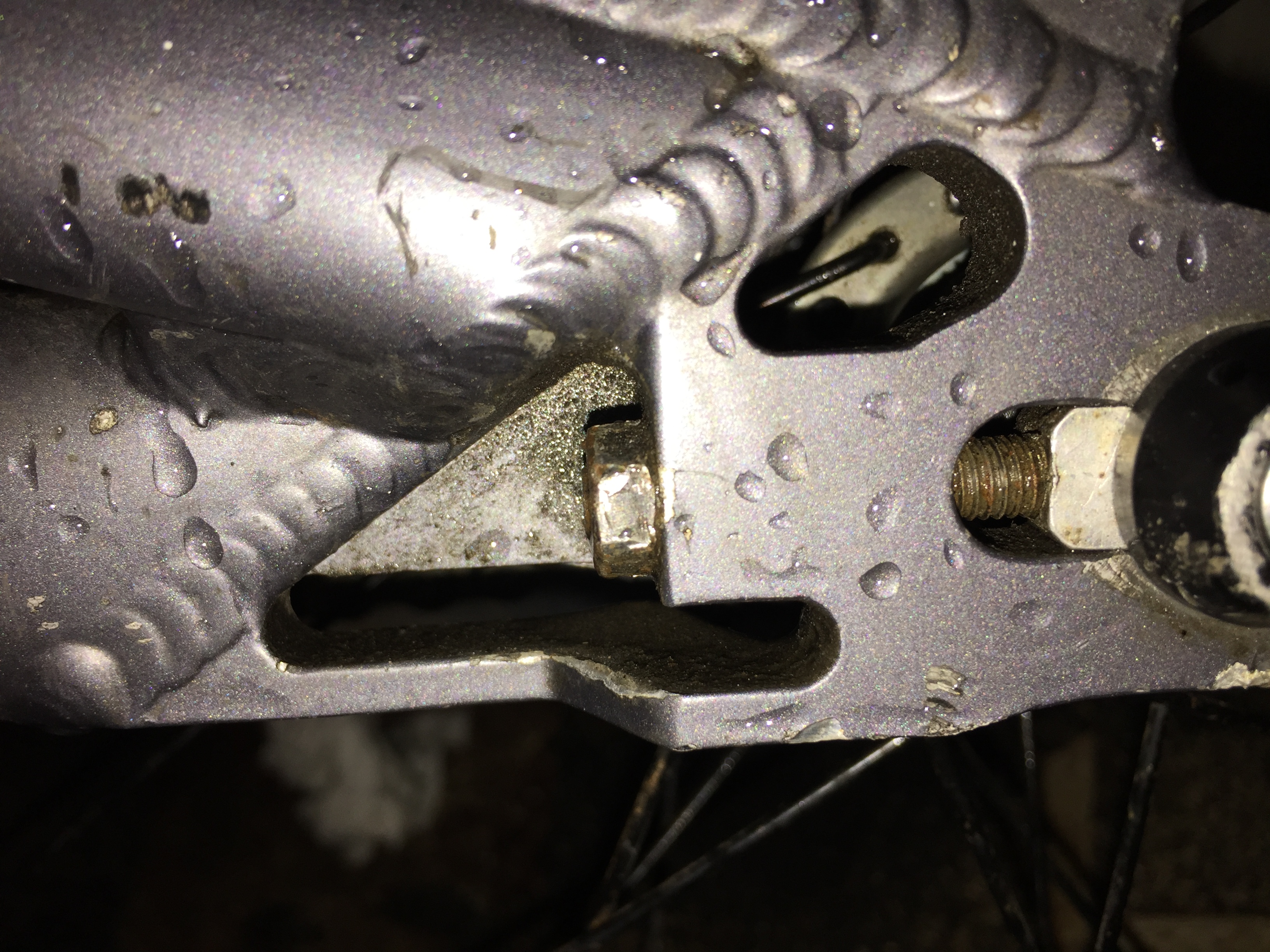

Adam_McGuire Posted February 20, 2016 Report Share Posted February 20, 2016 I have a 2013 (i think) Onza Comp, I'm having a bit of a problem with the chain tensioners, they are small nuts with bolts going through them, the frame makes it really tight to tighten and i'm my case impossible. I was wondering whether there is a specific tool that I should use or whether I could use rear chain tensioners like the Gusset Kojak instead and just forget about the other ones. Favouring the second idea right now, but wanted to see if anyone had a solution or advice. Thanks. Quote Link to comment Share on other sites More sharing options...

Adam_McGuire Posted February 20, 2016 Author Report Share Posted February 20, 2016 Quote Link to comment Share on other sites More sharing options...
isitafox Posted February 20, 2016 Report Share Posted February 20, 2016 That's a bodge, bare with me and I'll try to find a link to the proper bolt you need Quote Link to comment Share on other sites More sharing options...
isitafox Posted February 20, 2016 Report Share Posted February 20, 2016 This should be what you need http://www.tartybikes.co.uk/steel_bolts/onza_m6_integrated_tensioner_replacement_bolt/c523p12050.html Quote Link to comment Share on other sites More sharing options...
isitafox Posted February 20, 2016 Report Share Posted February 20, 2016 Actually looking again I'm not sure what's going on with your setup? The idea is the bolt I linked to screws through the dropout, I can't understand why the one on yours has a nut on the end though unless it's welded to the bolt in the frame? Quote Link to comment Share on other sites More sharing options...
ooo Posted February 20, 2016 Report Share Posted February 20, 2016 (edited) 19 minutes ago, isitafox said: Actually looking again I'm not sure what's going on with your setup? The idea is the bolt I linked to screws through the dropout, I can't understand why the one on yours has a nut on the end though unless it's welded to the bolt in the frame? are you talking about the square bit pressing on the hub axle ? I think at somepoint the tensioners had a little cup on them. @Adam_McGuire i think you need to loosen the nut a bit, and then undo the grub screw using an allen key. i don't think the nuts are needed. Edited February 20, 2016 by ooo Quote Link to comment Share on other sites More sharing options...
MartMini Posted February 20, 2016 Report Share Posted February 20, 2016 35 minutes ago, isitafox said: Actually looking again I'm not sure what's going on with your setup? The idea is the bolt I linked to screws through the dropout, I can't understand why the one on yours has a nut on the end though unless it's welded to the bolt in the frame? the nut is a lockout nut. you loosen it off, adjust the tension via the allen bolt, then do the nut up again. it stops the adjuster working itself loose. Quote Link to comment Share on other sites More sharing options...
isitafox Posted February 20, 2016 Report Share Posted February 20, 2016 16 minutes ago, ooo said: are you talking about the square bit pressing on the hub axle ? I think at somepoint the tensioners had a little cup on them. @Adam_McGuire No, I mean the nut on the end. Can't see what purpose it serves being fitted whatsoever. The bolts you linked aren't the right ones as there's no need for the nut though that's not to say they won't fit. Quote Link to comment Share on other sites More sharing options...
bing Posted February 20, 2016 Report Share Posted February 20, 2016 You need a ball end Allen key and a 10mm spanner that's quite a low profile. It's easy enough to do, do drive side first then centre the wheel up using the other side Quote Link to comment Share on other sites More sharing options...
Adam_McGuire Posted February 20, 2016 Author Report Share Posted February 20, 2016 ok cheers everyone, ill give that a go. Quote Link to comment Share on other sites More sharing options...
