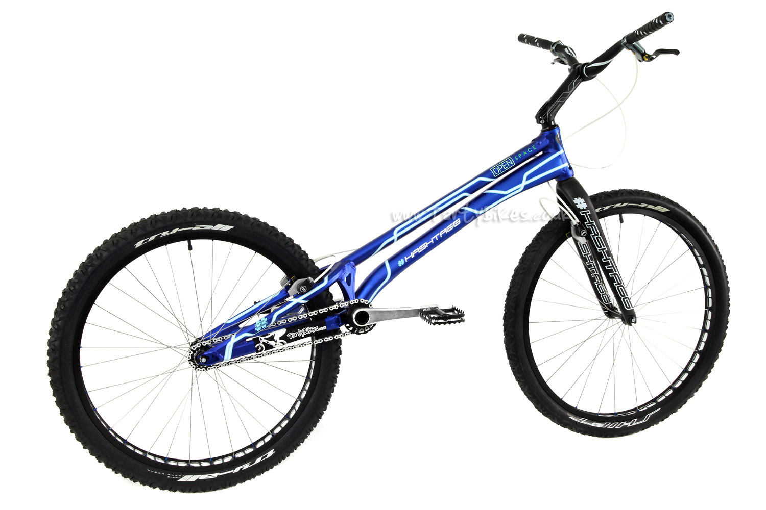

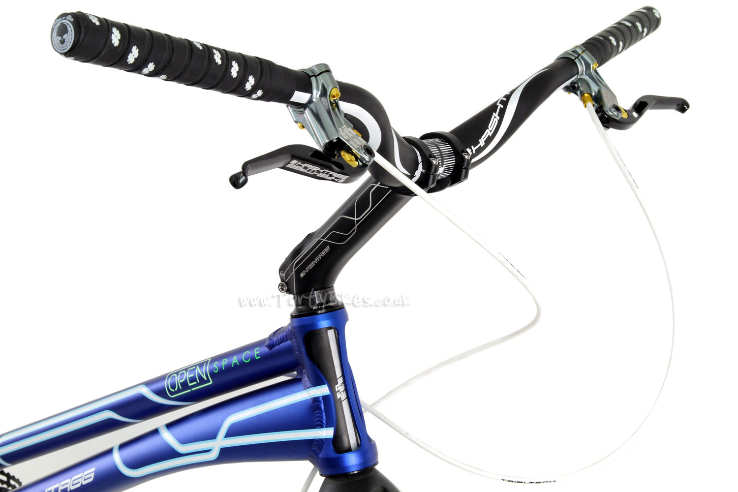

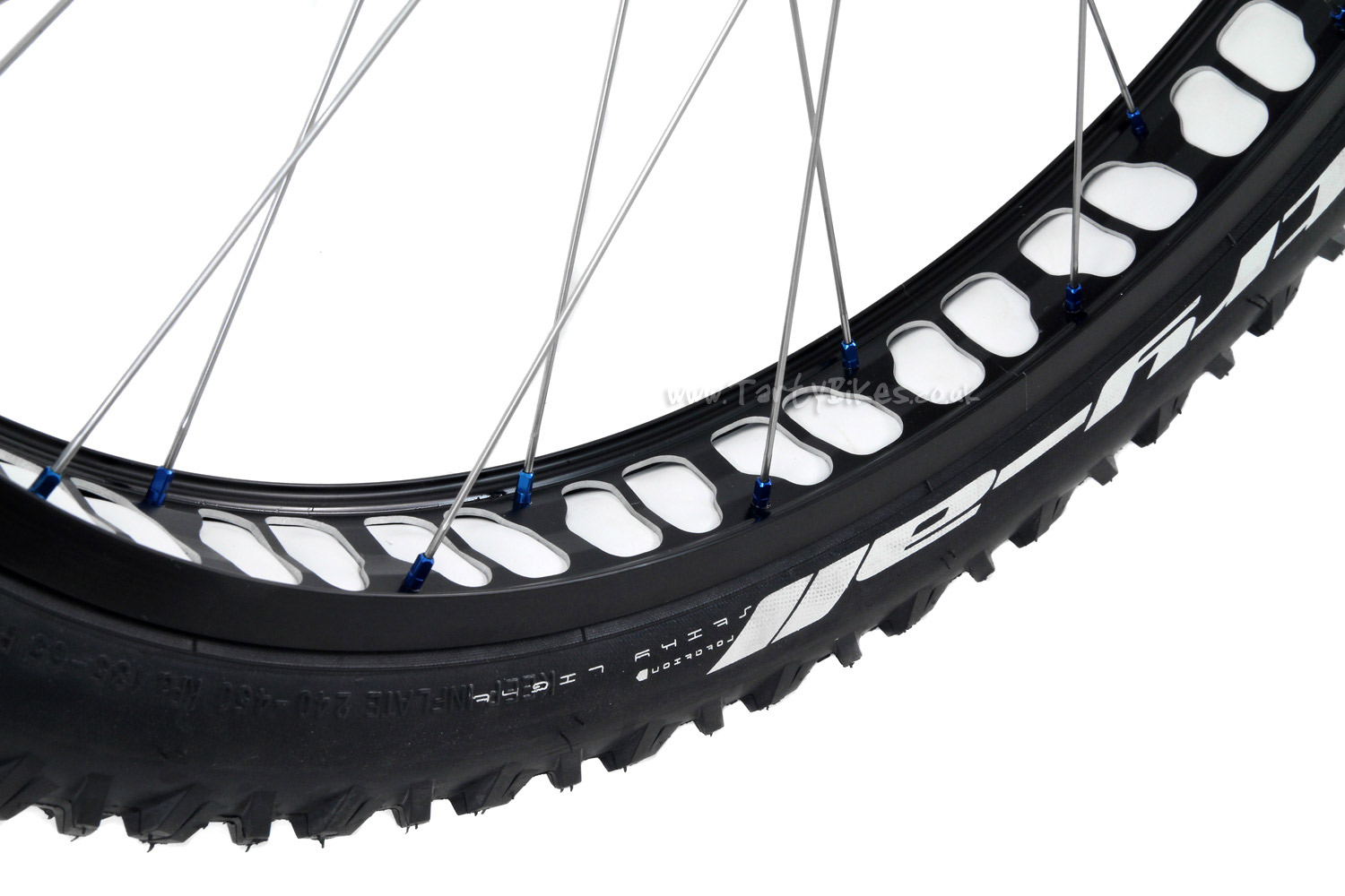

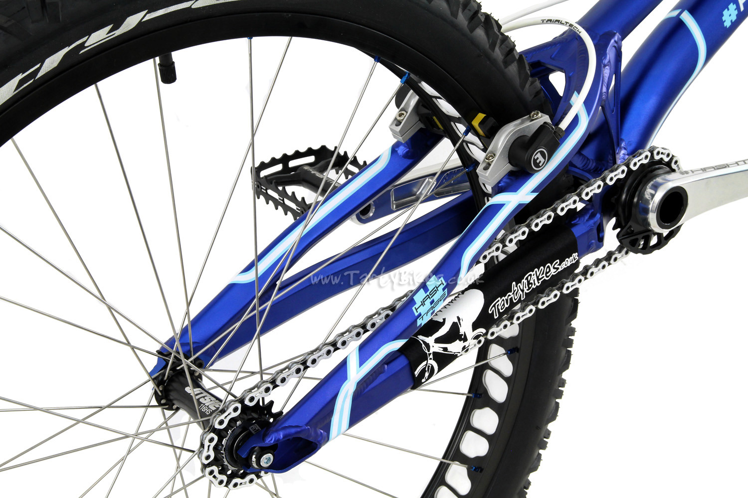

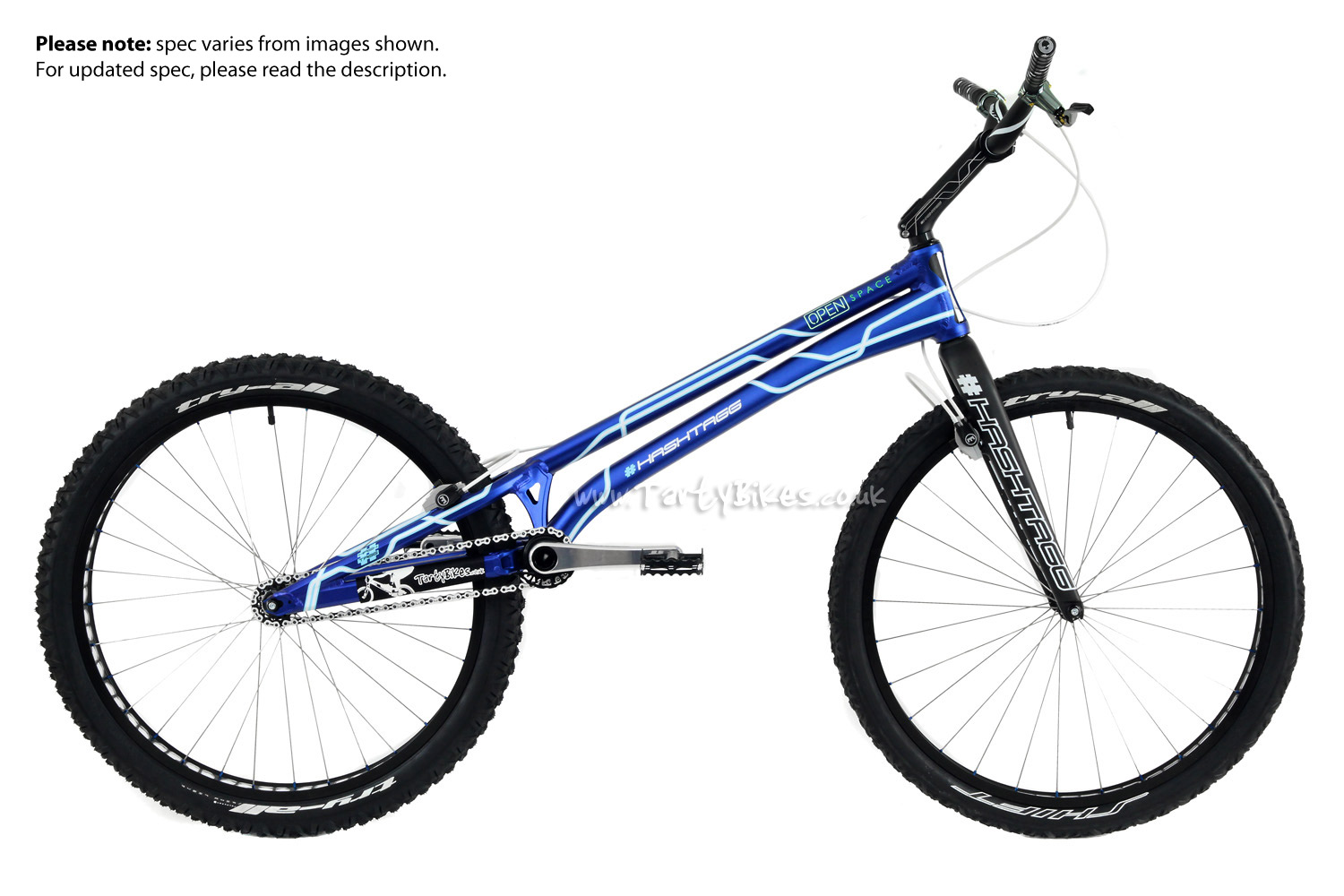

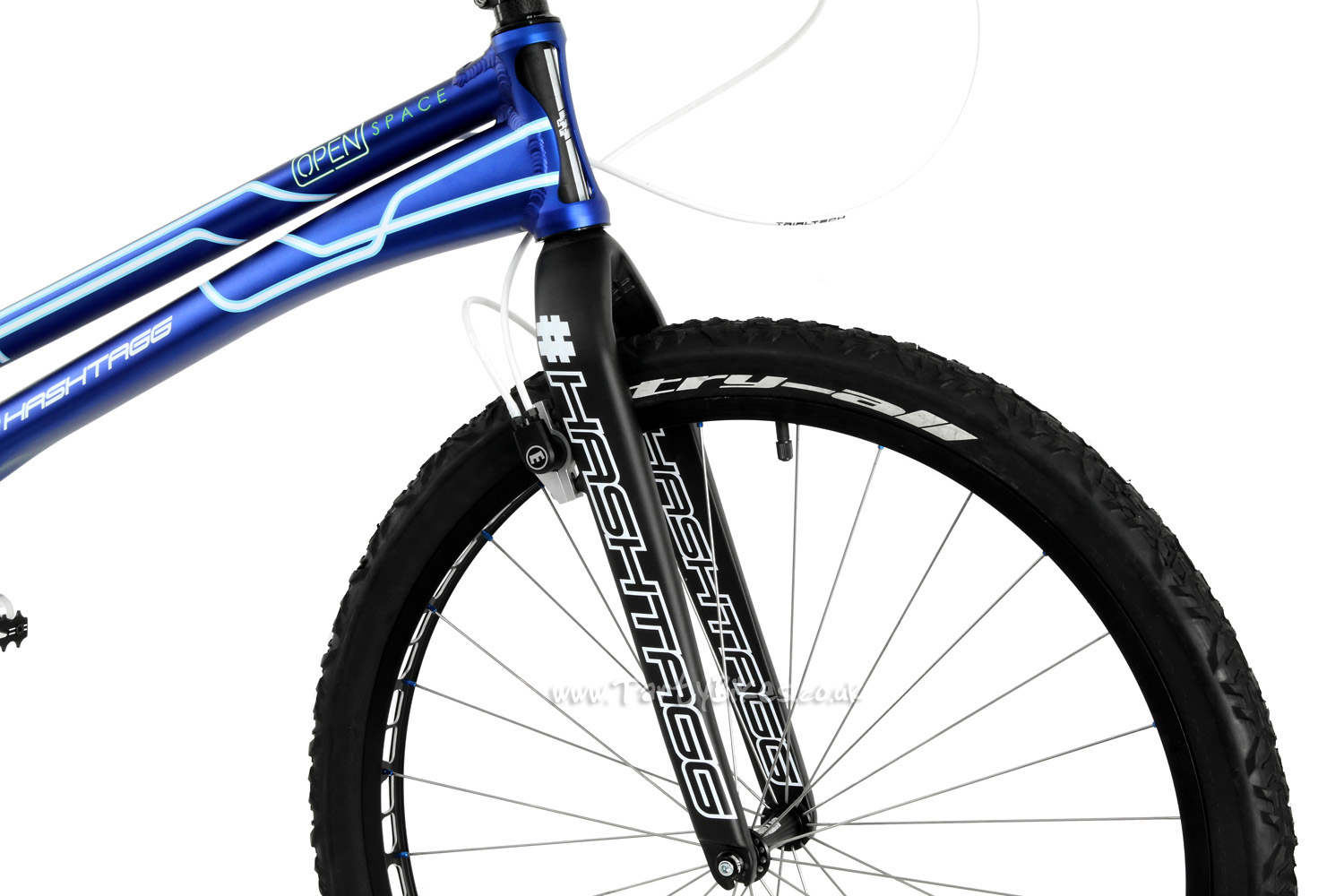

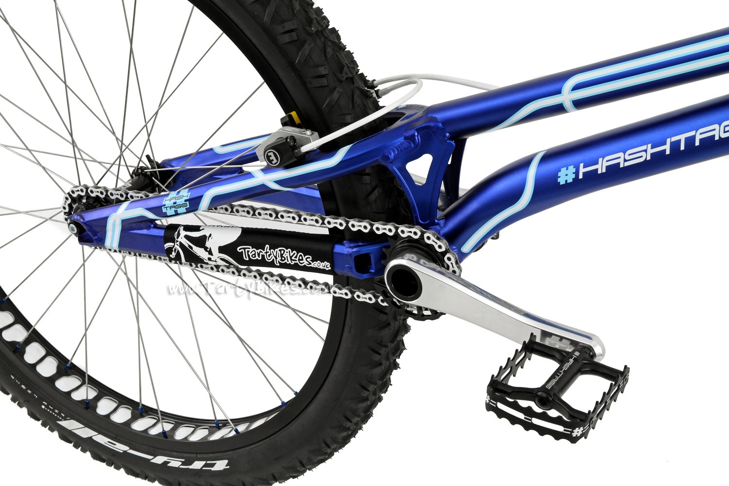

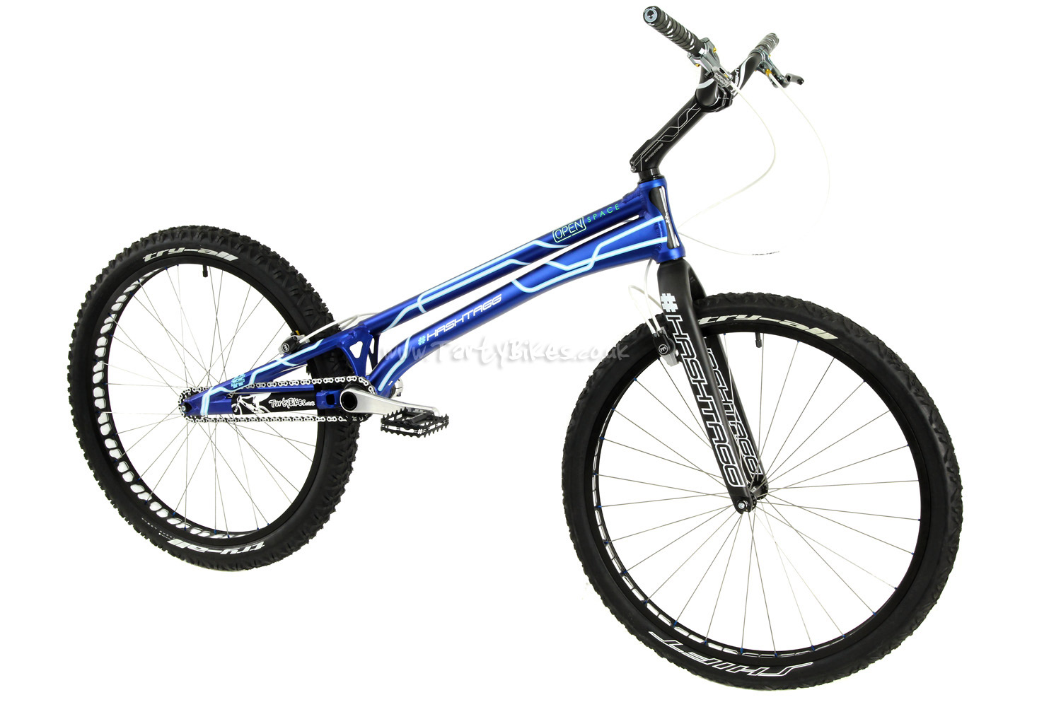

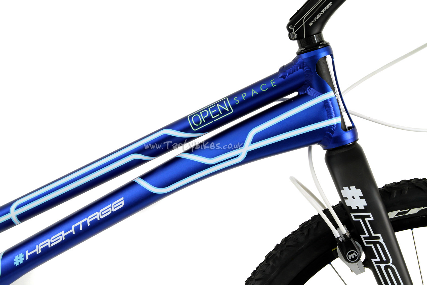

Mark W Posted January 28, 2016 Report Share Posted January 28, 2016 Possibly one of the nicest complete bikes we've built for a while: Frame and Forks - Frame: Hashtagg Open Space - Forks: Hashtagg Carbon FibreWheels - Front Hub: Jitsie 100HS Race Non-Disc (28h) - Rear Hub: Jitsie 116HS Race Non-Disc (32h) - Front Rim: Hashtagg - Rear Rim: Hashtagg - Front Spokes: Sapim Double Butted - Rear Spokes: Sapim Double Butted - Front Nipples: Halo Alloy - Rear Nipples: Halo Alloy - Front Rim Tape: Trialtech - Rear Rim Tape: Trialtech - Front Innertube: Jitsie Light - Rear Innertube: Jitsie Light - Front Tyre: Try-All Shift - Rear Tyre: Try-All Stiky LiteBrakes - Front Brake Lever: Hashtagg H2O - Rear Brake Lever: Hashtagg H2O - Brake Cylinders: Magura HS33 - Brake hoses: Trialtech - Front Pads: TK Pads Yellow - Rear Pads: TK Pads Yellow - Front Clamps: Clean CNC - Rear Clamps: Clean CNCDrivetrain - Crankset: Hashtagg BB30 v2 - Freewheel: Hashtagg 120.9 - Chain: Hashtagg Ultralight K810 SL - Chain Tensioner: Try-All Snail Cams - Rear Sprocket: Hashtagg Alloy, 15t - Pedals: Hashtagg Single Cage - Bottom Bracket: Hashtagg BB30 - Bashring: HashtaggSteering - Handlebar: Hashtagg Carbon Riser - Stem: Hashtagg TwinRing - Headset: Hashtagg Sealed Bearing - Grips: Hashtagg Bar TapeGeometry: - Wheelbase: 1095mm - Chainstay length: 380mm - BB Rise: 70mm - Head angle: 72° - Reach (from centre of BB shell to top centre of head tube): 660mmWeight - 8.00kg including pedals. 5 Quote Link to comment Share on other sites More sharing options...

p_ruskin Posted January 28, 2016 Report Share Posted January 28, 2016 (edited) They have really stepped up their game from the last frame, really love the colour! Asides from the worst looking set of forks I've ever laid eyes upon (completely due to the branding), its a pretty sweet build. Edited January 28, 2016 by p_ruskin 1 Quote Link to comment Share on other sites More sharing options...

Brian Bleech Posted February 5, 2016 Report Share Posted February 5, 2016 It would be so nice without those awful graphics. 1 Quote Link to comment Share on other sites More sharing options...
