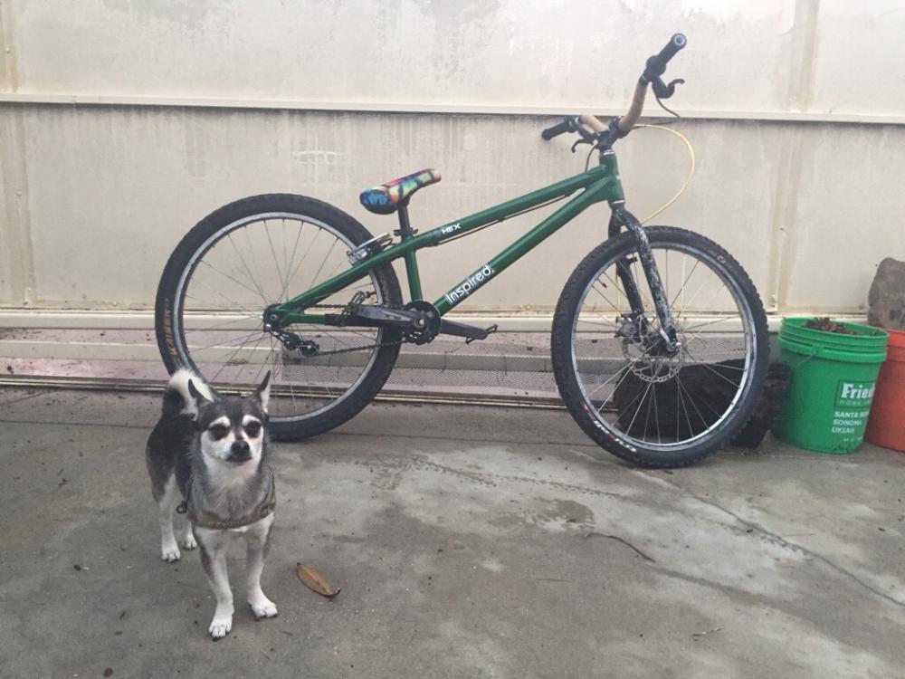

AndyT Posted January 19, 2016 Report Share Posted January 19, 2016 (edited) I've been going around with stem lengths on my hex... Have an Arcade bar (easily the best bar ever made...?), ran a Trialtech high rise and now run a Trialtech carbon bar on my pogo stick.. The arcade bar is pure pure natural comfort. On the hex I started with 70x30, 5mm spacers underneath, was nice and short but still troubled to get the front end up. Measured the stem and it was 60mm!! Was very nice for certain spin style things but not so great for pulling up...the bars would turn very quickly, an X-up dream. Then I got a used 80x40 stem (hand branded as that, not sure if it's 30deg? Not in orig package) from my LBS and the bike changed to a new world.. Still with 5mm of spacers underneath... Had one incredible ride (just think about it and it goes into a manual) and tore my rotator cuff at the end of the ride! Bummer zone... Going for a spin tonight, also ordered a 70x30 Ritchie stem but unsure if I'm even going to try it as this 80x40 is incredible. 90x30 is an old favorite but I haven't tried it yet as I feel it will feel too "long" when turning the bars if that makes any sense/ a mate has that on his bike and it reminds me of my pogo stick... 90x10 with a good amount of spacers underneath will be more streety, 90x10 with only a few spacers will be nice for "pure trials". Watch JamesB hex videos, he's got a similar looking to 90x10 and he uses his hex for pure trials. In the end just try all kinds of things till you get something that feels right to you- enjoy that frame I'm falling in love every time I ride it... Have fun with it !! Edit: shot of my bike, green is the best Edited January 19, 2016 by AndyT 1 Quote Link to comment Share on other sites More sharing options...
Ali C Posted January 19, 2016 Report Share Posted January 19, 2016 your dog does not look impressed! 2 Quote Link to comment Share on other sites More sharing options...
isitafox Posted January 19, 2016 Report Share Posted January 19, 2016 With a chain that long who can blame him! 2 Quote Link to comment Share on other sites More sharing options...
AndyT Posted January 19, 2016 Report Share Posted January 19, 2016 (edited) My goal was to run 5 gears as a stock bike should have by rules of trials law. However the only fault of the arcade bars is I couldn't fit my cut down 1999 gripshift with my lock on grips Edit: took out all I could take out. One tiny link, for fears of future British chain length ridicule. I will think specifically of you whenever I have to change a flat and it's a pain in the ass as my chains so f**king tight. This makes the dog happy. Edited January 20, 2016 by AndyT 2 Quote Link to comment Share on other sites More sharing options...
