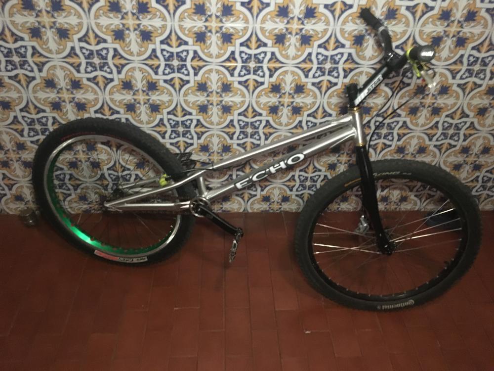

Greetings!
So I'm in of a few parts and I need some help to make sure i got the «right parts».
I'm 6ft 5in tall, so wide arm span.
My bike is a Echo Pure 2012 26" with this geo/parts:
Wheelbase: 1085mm
Chainstay Length: 380mm
BB Rise: 55mm
Head Angle: 72º
Centre of BB shell to top centre of head tube: 665mm
Fork: Echo urban (pre- race crown integration)
Stem: 127mm x 27º
Bars: 760mm (?) with 90mm rise
Cranks: 175mm
Gearing: 18:15
Ground rim (needs a new grind)
Parts I want/need: My choice
- Fork: Echo Urban 2015 4bolt + disk
- Handlebars: Trialtech Sport Riser Bar 740mm / 88mm rise
- Stem: Jitsie Forged  150mmx35º
- Pads: TNN ADM
Feeling that 18:15 is too light in the final pedal phase:
- 14t rear sprocket (bad move or good move?)
Personally I would go with (because I have) some Trialtech SL forks with Trialtech high rise bars and keep the stem you currently have but give yourself a bit of steerer, maybe 20-25mm. As for the pads my favourites are either Heatsink Yellows or Trialtech pads.
Not sure on the gearing choice as it may mean running a half link.
ADM pads are great but are more suited to riding in wet weather (I use them but I ride in the rain a lot), if you ride dry weather only there are better pads.
Those trialtech forks are a real popular choice so there must be something good. I like a longer lower feel, I'm considering the new hashtagg stem at the moment. I see you ride normal bar angle as well, so you may need the extra length? You are pretty tall so you may need stackers and a long stem ??
also echo make a 158mm by 30 stem which may be good to look at
Edited by ooo

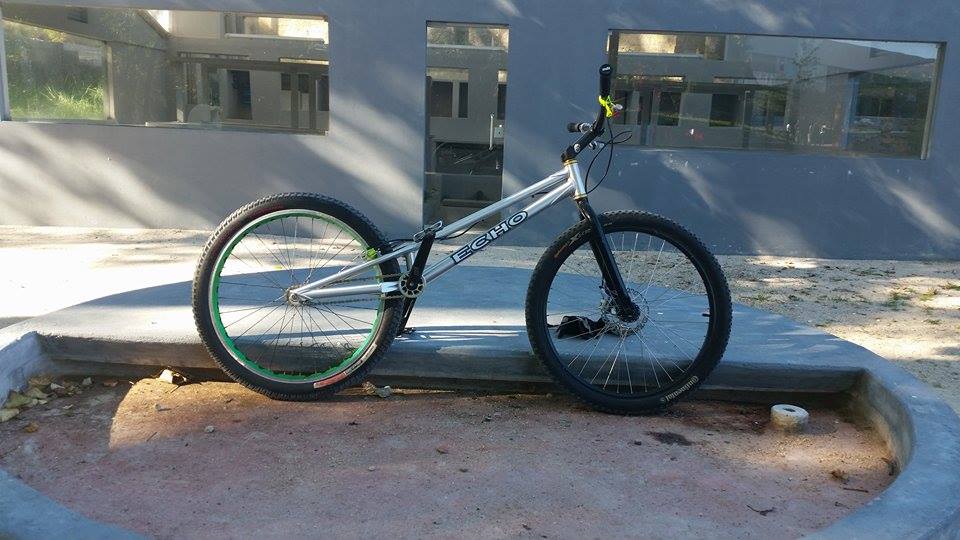

Just finished the parts assembly:
- Trialtech Riser bars
- Trialtech Sport fork (uncut)
- Avid HS1 180mm disk
- TNN ADMs
- Jitsie stem 150mmx35º

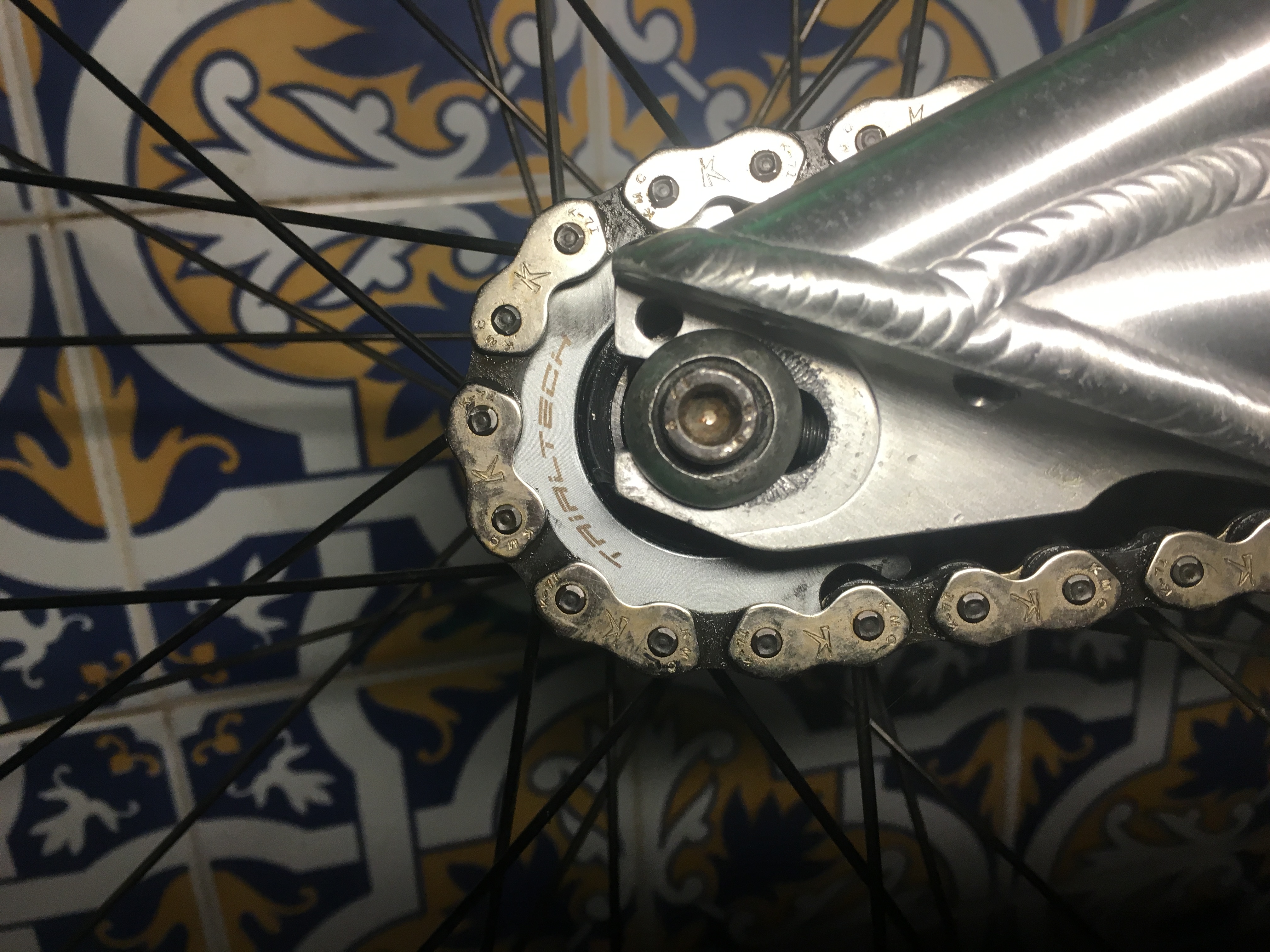

- Trialtech 14T rear sprocket
Can a half-link be used? I think there's lilttle space for it.
