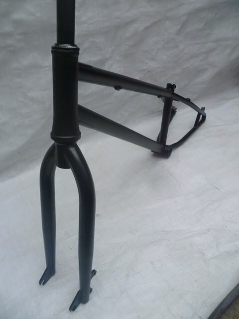

Ross McArthur Posted December 1, 2015 Report Share Posted December 1, 2015 So for 2016 I'll be rolling on an updated Archive. It's a touch longer, and has a tapered 150mm head tube which takes a integrated 45x45 headset. Hopefully with the longer head tube I'll not have to run as many spacers. Another difference we've encorporated in this build is the oh so slightly shorter dropouts and bigger tyre clearances. The eagle eyed forum members will spot the Marino branded headset. The forks are threaded too so they'll come with a lazer etched Marino branded top tensioner cap. Going for some classy gloss stickers to compliment the matte frame. Very subtle. Still to decide on which dropouts on the forks to run, so I'll be giving both a wee go. Your questions and thoughts are welcome. Cheers. 4 Quote Link to comment Share on other sites More sharing options...
Dman Posted December 1, 2015 Report Share Posted December 1, 2015 (edited) I prefer the look of the straight down dropouts. Edited December 1, 2015 by Dman Quote Link to comment Share on other sites More sharing options...
Mikee Posted December 1, 2015 Report Share Posted December 1, 2015 I think I do too. Quote Link to comment Share on other sites More sharing options...

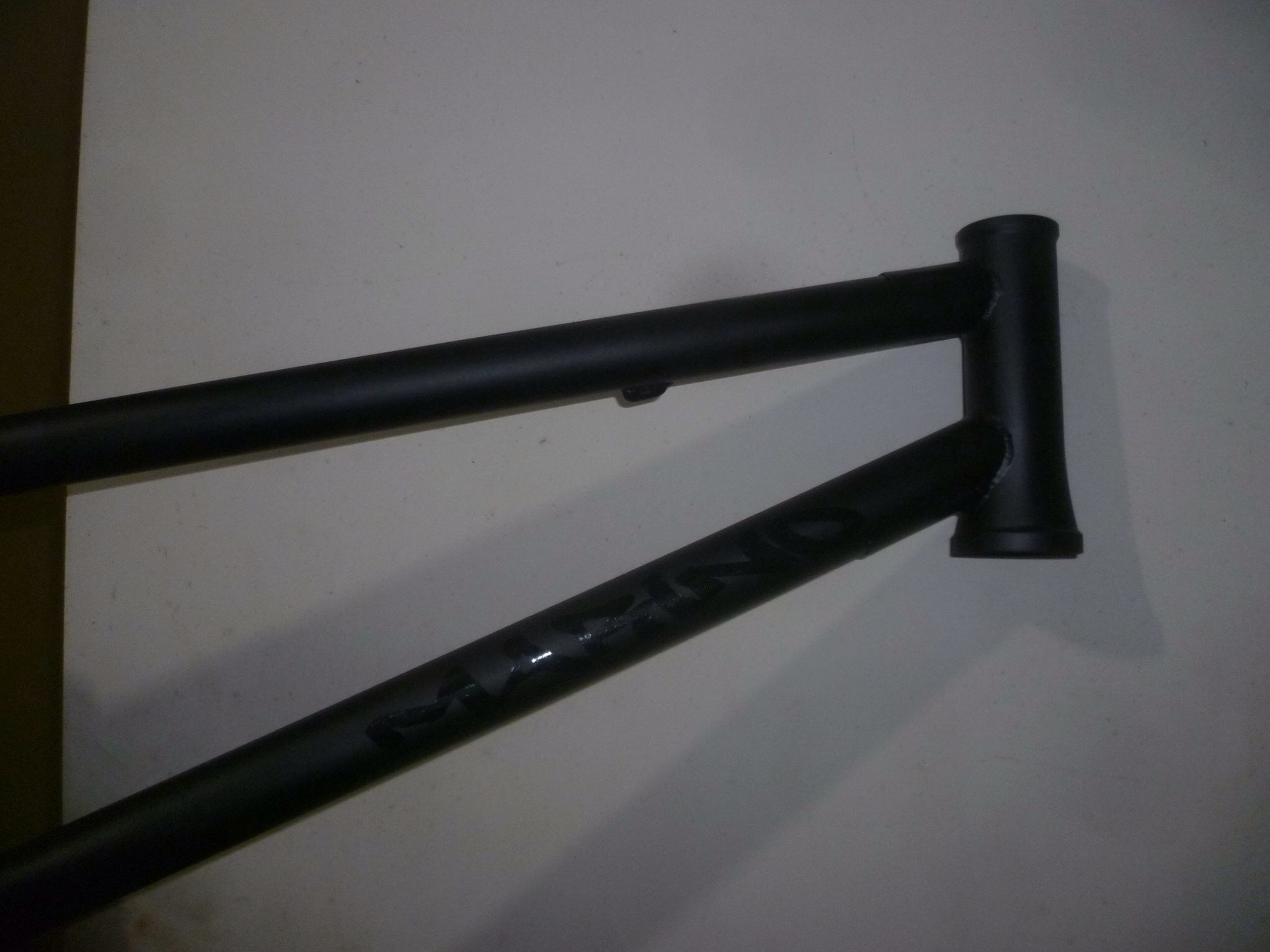

Ross McArthur Posted December 1, 2015 Author Report Share Posted December 1, 2015 Glad you guys seem to like those ones. They'll bring the front wheel in 5mm or so and it'll mean the front of the wheel won't come even closer to the riders toes if X ups are their thing. I actually had bar spins in mind too....I'm my dreams. Shit pic of the stickers... Quote Link to comment Share on other sites More sharing options...

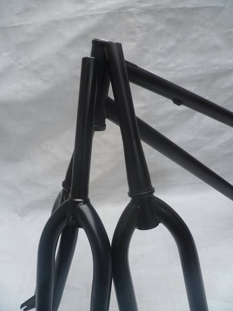

Ross McArthur Posted December 3, 2015 Author Report Share Posted December 3, 2015 I think there's maybe a decimal point missing from his figures. "." Add it in wherever you fancy Seemingly I was wrong about the tapered forks having a screw ontop cap too. Only the standard forks have that, for the moment. Quote Link to comment Share on other sites More sharing options...

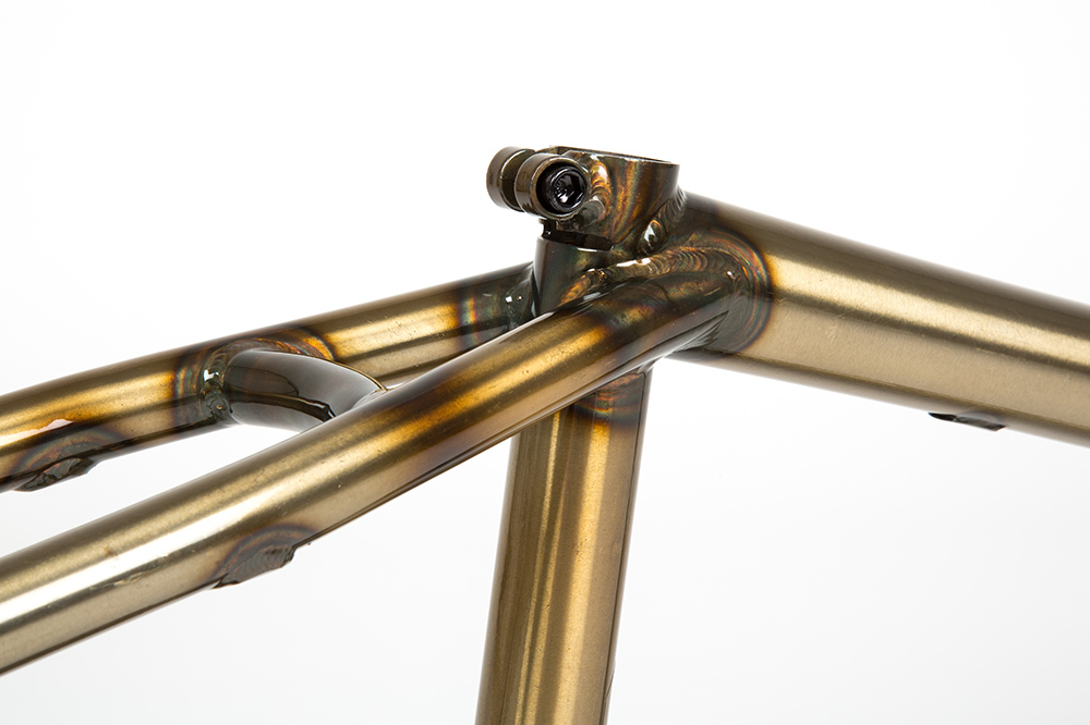

Ross McArthur Posted December 3, 2015 Author Report Share Posted December 3, 2015 Check this beast out! Quote Link to comment Share on other sites More sharing options...
Dman Posted December 3, 2015 Report Share Posted December 3, 2015 Nah could do better with hammerite. I want to see an all chrome or translucent painted 24. Quote Link to comment Share on other sites More sharing options...

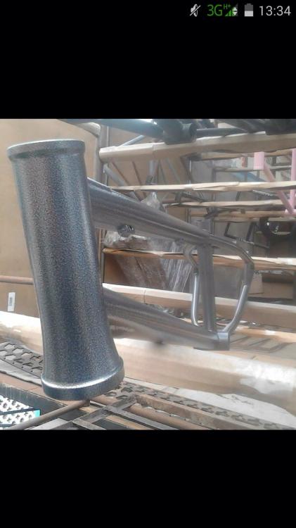

isitafox Posted December 12, 2015 Report Share Posted December 12, 2015 Won't happen, I wanted mine left raw but was told it wasn't possible whatsoever so I took it to be powdercoated chrome but after 5 attempts and the paint not taking to the frame the guy gave up (said it was the first thing he's ever had that wouldn't take the paint?!). Quote Link to comment Share on other sites More sharing options...
Dman Posted December 12, 2015 Report Share Posted December 12, 2015 Chrome isn't powdercoat though. Quote Link to comment Share on other sites More sharing options...
isitafox Posted December 12, 2015 Report Share Posted December 12, 2015 Ah you mean actual chrome, I was referring to something like this (sorry for the blurry pic!) Quote Link to comment Share on other sites More sharing options...
Ross McArthur Posted December 12, 2015 Author Report Share Posted December 12, 2015 Yea once the frames are heat treated they loose that just welded look. Quote Link to comment Share on other sites More sharing options...
