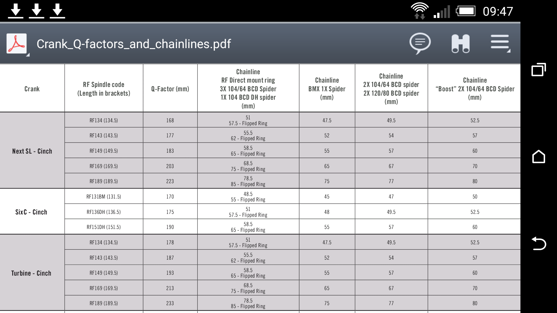

Dman Posted January 8, 2016 Report Share Posted January 8, 2016 (edited) @Mark W Hopes Q factor is 167mm I found out that middleburn q factor is, 57.5mm + spindle length And this is the race face turbine q factor. Will any of them fit? Thanks for taking a look. Edited January 8, 2016 by Dman Add Quote Link to comment Share on other sites More sharing options...
Mark W Posted January 8, 2016 Report Share Posted January 8, 2016 I don't know for definite, but the Hope is only 2-3mm off clearing so theoretically any setup with a Q-factor of more than 167mm + 2-3mm should be fine. It looks like as long as you get the right coded BB, any of those RaceFace ones would work fine. Quote Link to comment Share on other sites More sharing options...
