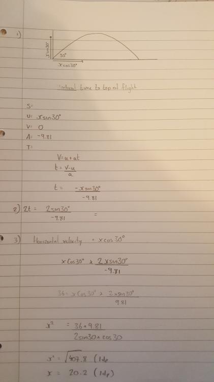

Interestingly at at this point I thought well actually what if you can pluck the height out without calculating V or t ? The range is fixed at 36m so there is only one path it can possibly follow, for which you don't need to know gravity or initial velocity. You can describe this as a parabola fairly easily. The differential at time 0 and using the angle at take off helps you get the height to drop out. I haven't got this written down legibly! But it gave the same answer which is always good.
image.thumb.jpeg.03a8fce8481fcb8e46ac8fc
I will end by saying I haven't done any maths for a long long time so did this as a sanity/mind check, so hey I'm rusty and probably haven't helped.
