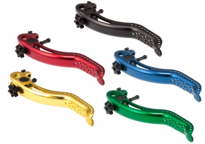

Mark W Posted August 25, 2015 Report Share Posted August 25, 2015 I'd forgotten all about Brake Force One. Weren't they trying to do a Kickstarter campaign to fund production at one point? Is she using this lever? 1 Quote Link to comment Share on other sites More sharing options...
MCoen Posted August 25, 2015 Report Share Posted August 25, 2015 (edited) I'd forgotten all about Brake Force One. Weren't they trying to do a Kickstarter campaign to fund production at one point? Is she using this lever? No, that is the old lever from the 1st version of the brake. The new lever isn't "plastic" anymore. Here is a picture with the one-finger lever. There also is another lever available Edited August 25, 2015 by MCoen 1 Quote Link to comment Share on other sites More sharing options...
Ash-Kennard Posted August 27, 2015 Report Share Posted August 27, 2015 Holy shit! that looks awesome. I really like that. I am guessing she rides with gloves? I would be worries about slicking my fingers on those holes. But it looks great. Quote Link to comment Share on other sites More sharing options...

MCoen Posted August 28, 2015 Report Share Posted August 28, 2015 Holy shit! that looks awesome. I really like that. I am guessing she rides with gloves? I would be worries about slicking my fingers on those holes. But it looks great. No she never had issues with the holes and yes she is riding with gloves Here is a picture of the 2 finger lever: Quote Link to comment Share on other sites More sharing options...
Mikee Posted August 28, 2015 Report Share Posted August 28, 2015 In my opinion, all the little holes ruin it a bit. Quote Link to comment Share on other sites More sharing options...
MartMini Posted August 28, 2015 Report Share Posted August 28, 2015 I always found the holes they did in the hope tech levers felt horrible(even after i sanded mine down to try and smooth them out). i wrap mine in bandage tape for comfort/sweat absorption. Quote Link to comment Share on other sites More sharing options...
Mark W Posted August 30, 2015 Report Share Posted August 30, 2015 Which version of the Tech levers did you try? I agree about that on the older ones, but the Tech 3 levers feel pretty good Quote Link to comment Share on other sites More sharing options...
