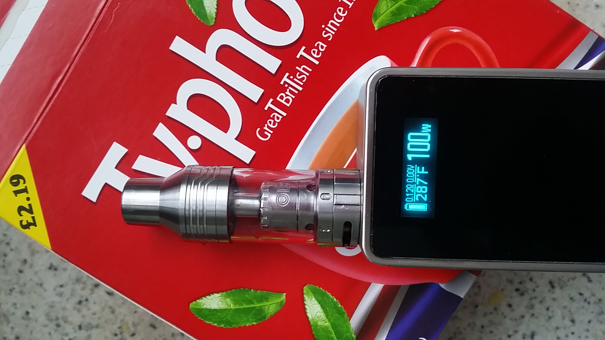

*gentlydoesit Posted November 11, 2015 Report Share Posted November 11, 2015 (edited) Bellus is very good, haven't tried the aromamizer yet but those who have give it good reviews. Think the bellus has a bigger tank but I'm not sure. The crius I'm rocking atm is also a very good contender, 100w in an rta is awesome! Edited November 11, 2015 by *gentlydoesit Quote Link to comment Share on other sites More sharing options...

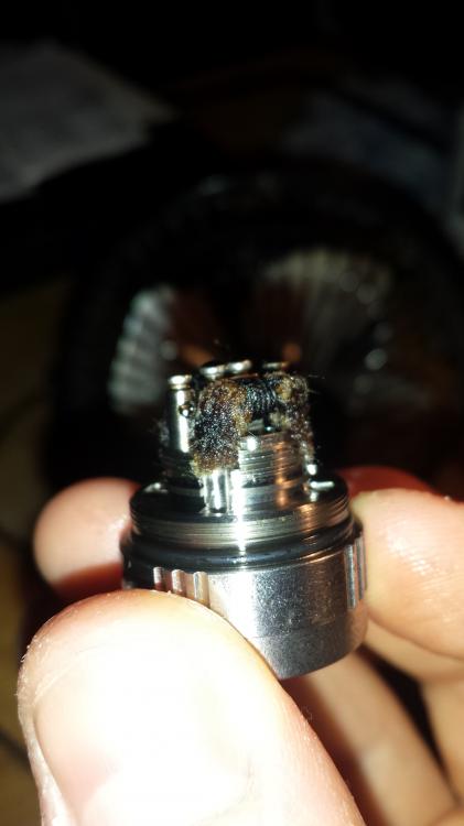

JT! Posted November 12, 2015 Author Report Share Posted November 12, 2015 I dunno, ego one mini used to leak. Kanger with vertical, horizontal and the rebuildable atomizer all leaked. Now this is too. Ignore the gunk on the cotton, some rank juice I won't be using again. Any tips? Quote Link to comment Share on other sites More sharing options...
*gentlydoesit Posted November 12, 2015 Report Share Posted November 12, 2015 @JT! I've just got back from work so gimme a few minutes to get sorted and I'll re-wick mine with some tips. I replied right now just to say... WOW! that coil is GNASTY! Quote Link to comment Share on other sites More sharing options...

weirdoku Posted November 12, 2015 Report Share Posted November 12, 2015 3 hours ago, JT! said: I dunno, ego one mini used to leak. Kanger with vertical, horizontal and the rebuildable atomizer all leaked. Now this is too. Ignore the gunk on the cotton, some rank juice I won't be using again. Any tips? Looks like the cotton is barely filling the channels. I have cotton running down the entire channel on my Goblin and no leaks at all. Quote Link to comment Share on other sites More sharing options...

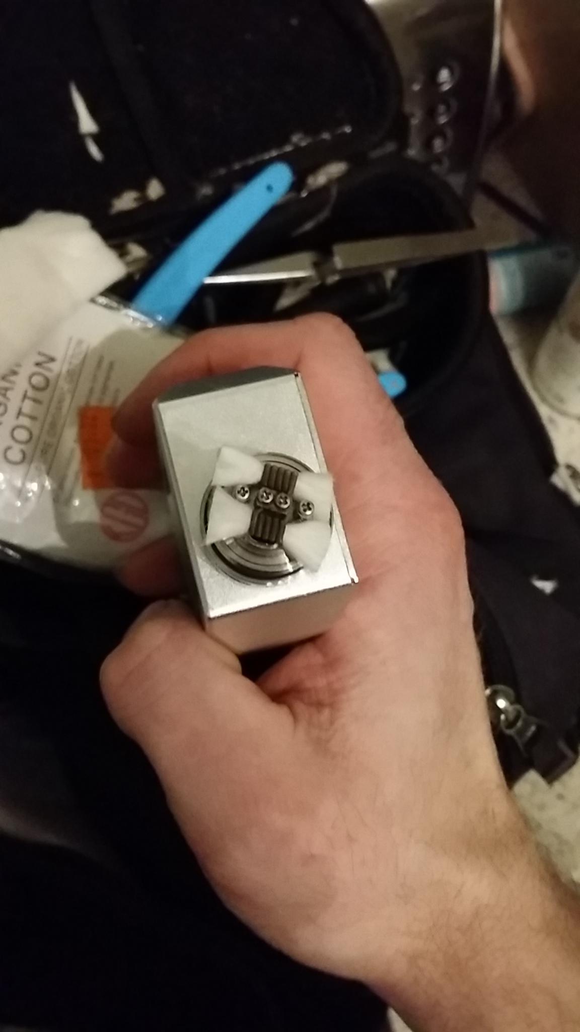

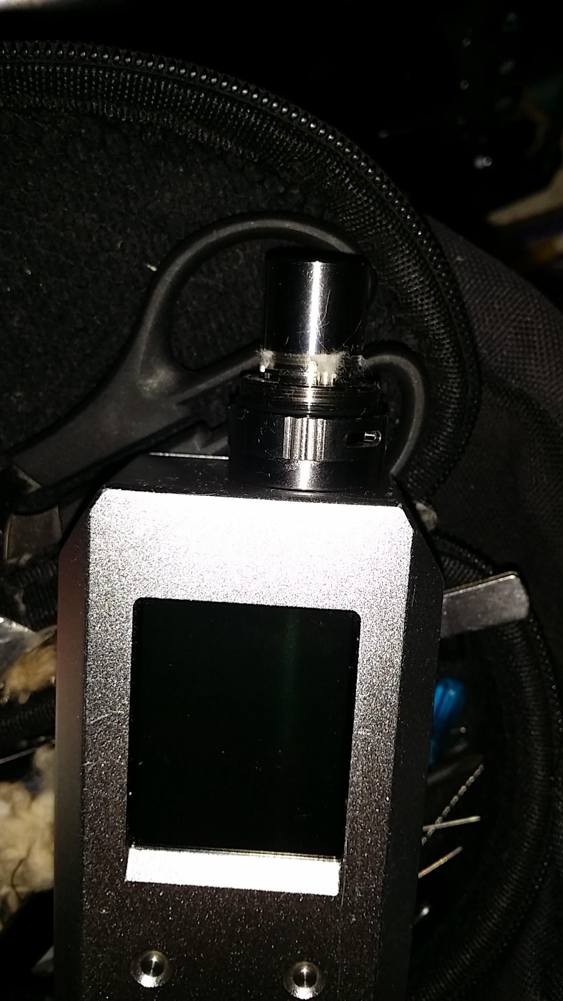

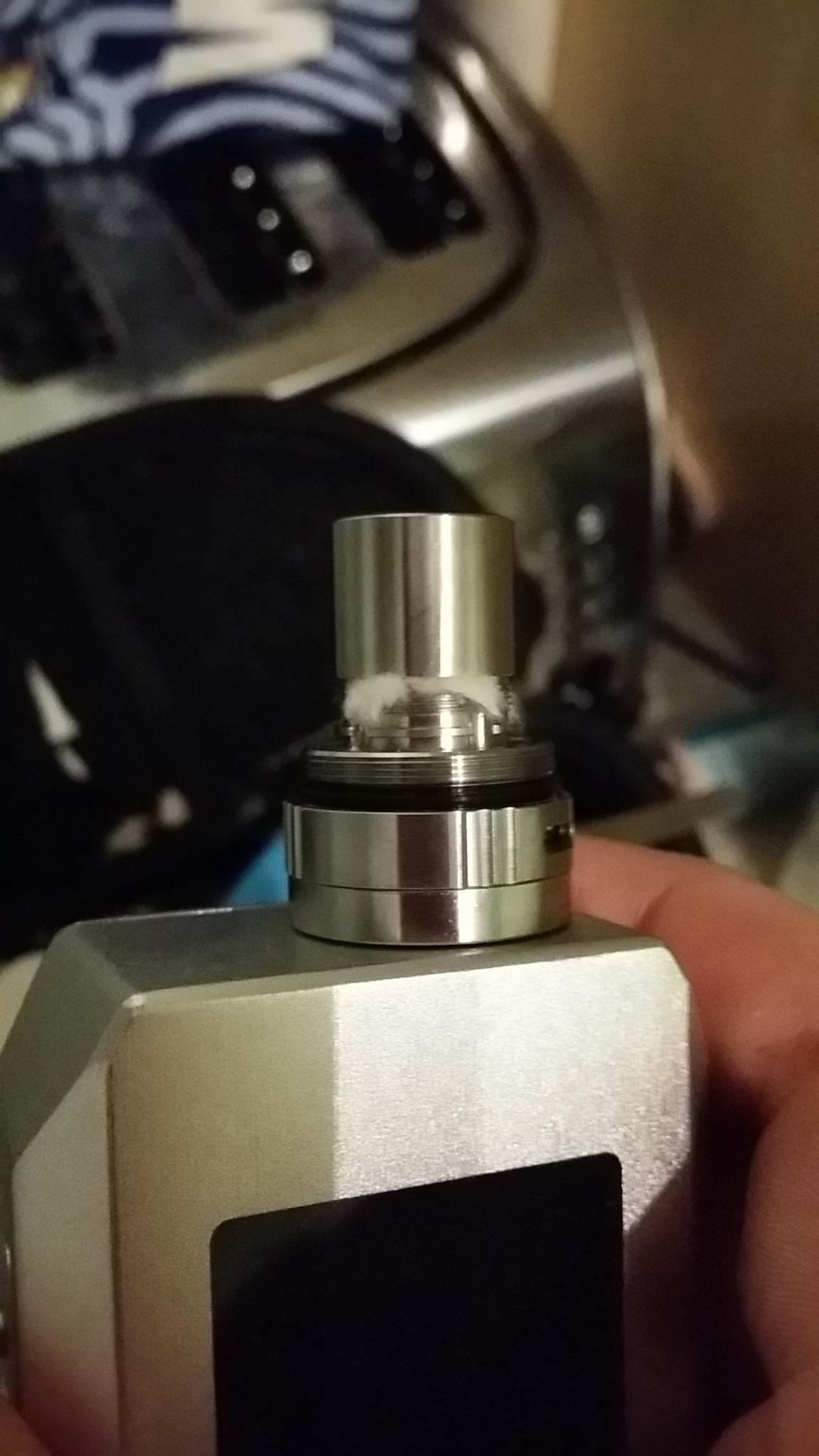

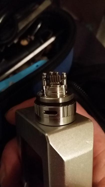

*gentlydoesit Posted November 12, 2015 Report Share Posted November 12, 2015 (edited) OK so that took longer than I thought. Firstly my coil generally covers the whole width of the air hole. This is so the wick isn't in direct path of the airflow. No juice sucked out of the wick then deposited in the chimney then ran down into the air intake means less chance of weeping. Then I wallop some nice straight cotton in, not too tight. Leaving about 4-5mm tails either end. (I did trim them after the pic) Then push on the coil housing/lower chimney, leaving a little cotton sticking out. Line up the threads and push the cotton into the juice wells. Should look like this when it's done Edited November 12, 2015 by *gentlydoesit Quote Link to comment Share on other sites More sharing options...

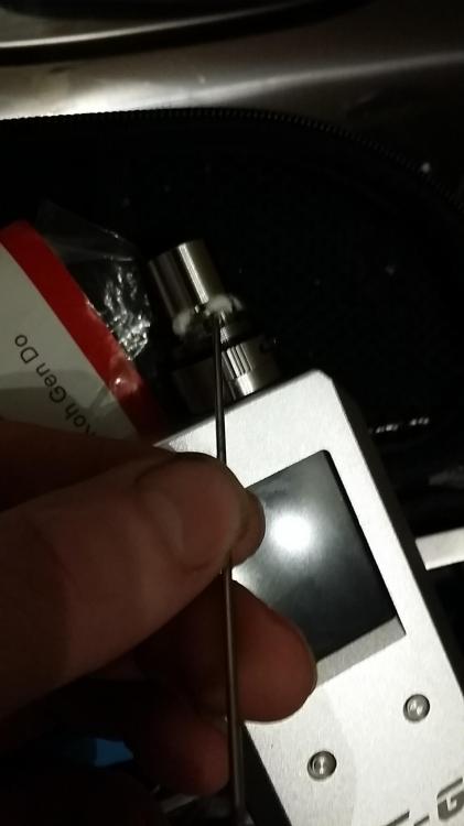

*gentlydoesit Posted November 12, 2015 Report Share Posted November 12, 2015 (edited) The wick should sit on a ledge half way up the channel. Screw it down a few turns, back one, then down a few more, then back one until it's tight. Just so the wick isn't trapped by the threads. Juice, screw the tank on and vape happy Edited November 12, 2015 by *gentlydoesit Quote Link to comment Share on other sites More sharing options...
*gentlydoesit Posted November 12, 2015 Report Share Posted November 12, 2015 It looks to me that your wick doesn't quite fill the wide part of the channel. Look at your orings too. Especially the one on top of the coil housing, it can get squashed flat. Quote Link to comment Share on other sites More sharing options...

JT! Posted November 13, 2015 Author Report Share Posted November 13, 2015 Thanks, maybe I do need to be more liberal with the cotton. I'll give it a shot tomorrow. Quote Link to comment Share on other sites More sharing options...

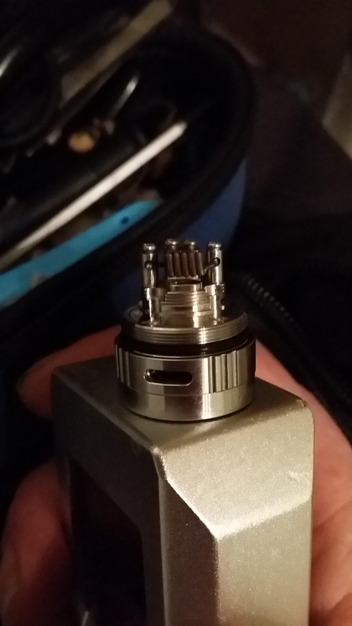

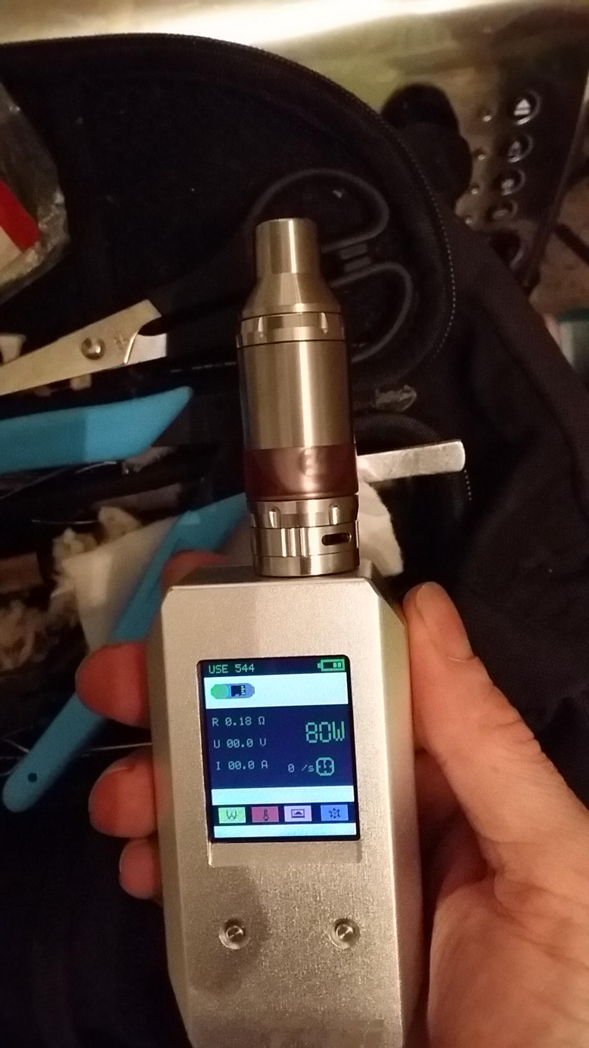

Ash-Kennard Posted November 14, 2015 Report Share Posted November 14, 2015 My wire arrived today so I started building! All the batteries on charge, now all 100% Wrapped my first 24g coils. So much easier than 30g! Much less spring back. Firing them up and repositioning... Wicked Trimmed... I then wet the wick and positioned it where I wanted. Assembled and filled and here we are. Firing on 50W, seems to be about right for me for now at 0.3 ohm. This is the first puff. Now proceeded to go all the way up to 100W. Bit much maybe... Either way, very happy with it. Cheers for the advice guys. Cheers, Ash 1 Quote Link to comment Share on other sites More sharing options...
