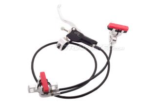

but if the slave and the brake clamp were just one piece that would be amazing. Or have something other than a clamping mechanism to hold the slave. Maybe on the modern setups there is less variation between the brake and angles and distances from the rim ?
CSC already had a go a that, Have no idea how successful it was, I just know of their existence. Rim distance was controlled by rotating a threaded slave and clamp from memory...
EDIT: found some photos here
Edited by CC12345678910
  • Like 2
The CSC system had some interesting ideas, and I've found this original discussion on TF from 2011 which shows some of the areas where many weren't convinced! http://www.trials-forum.co.uk/topic/170511-csc-rim-brakes/page-4
It seems to be available to buy here: http://www.trial-bikes.com/freno-hidraulico-p-536662.html
Food for thought indeed!
