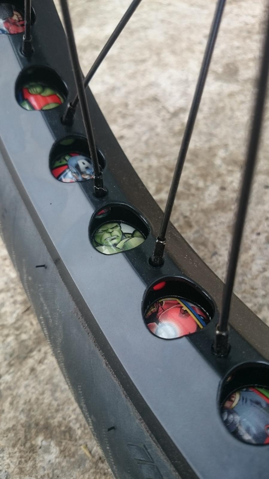

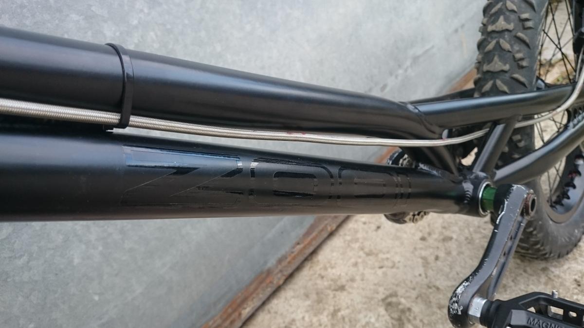

isitafox Posted June 8, 2015 Report Share Posted June 8, 2015 Finally finished my mod tonight with the arrival of the stem and I'm more than pleased with it, the added bonus being that it doesn't feel small either it's spot on. Massive thanks to Alex Dark for sorting the rear hub out, the guy is a legend!! Spec is: Frame and forks - Zoo Lynx disc only with Viz disc only forks Wheels - Front Hope XC on Onza rim, Rear 116mm Pro 2 on Echo TR rim, Tryall Shift and Stiky lite tyres with Jitsie tubes and Avengers rim tape Brakes - Black Tech Trials (from mk1 Skye) with 180mm rotors and Jitsie pads Drivetrain - Echo cranks and bash (I think), Ebay knock off MG-1's, big meaty sprocket and chain, Gusset sprocket on rear Steering - Hope headset, Trialtech 165mm stem and high rise bars with foam grips I think that's it, hope you guys like it! Also quick shout to Lucy @ Indiprint for the Zoo stickers and Tartybikes for the great wheelbuilds and usual service. 6 Quote Link to comment Share on other sites More sharing options...

Ross McArthur Posted June 9, 2015 Report Share Posted June 9, 2015 Watch out for your heel on that rear brake cable. Usual routing is inside of the seat stay. Quote Link to comment Share on other sites More sharing options...

Mark W Posted June 9, 2015 Report Share Posted June 9, 2015 Bike looks awesome Dave I'd go with what Ross said and change the rear hose routing though, I used to rub my frame with my heel at the point where your hose crosses over the outside of the stays. You may need to do the hose routing switcheroo where you put the hose into what is currently the bleed port then use a blanking bolt on what is currently where the banjo fitting goes to make it work. It's how I've got my Trial Zone set up now and it means you can get a way lower profile routing. Gives you an excuse to get even more stealthy by using a black M6 alloy blanking bolt on the outside of the caliper too Also, wrong-way-round rotors? Quote Link to comment Share on other sites More sharing options...
isitafox Posted June 9, 2015 Author Report Share Posted June 9, 2015 I always get them the wrong way round! Couldn't find a pic so I just went with the way tarty had pictured them, they work amazing though so will be staying that way! Quote Link to comment Share on other sites More sharing options...
